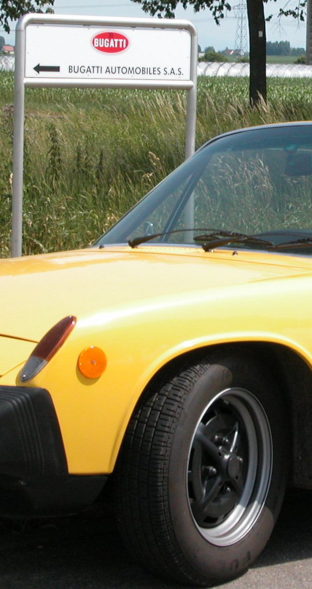

Late steel rims look great when painted this way. And they are cheap.
I have 185/70/15 but I suggest 195/65/15 or 195/65/15 they are easier to find ...
