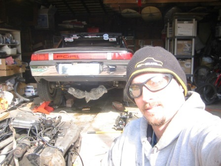

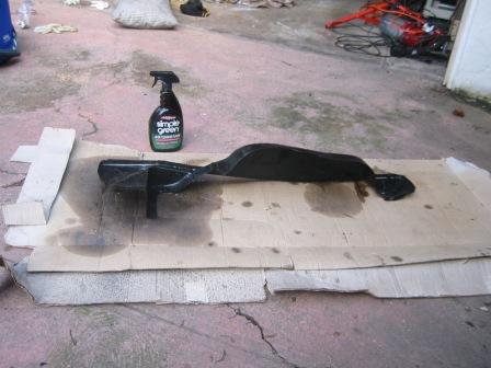

I just dropped my engine yesterday and am cleaning today. I have a new can of brake cleaner if needed, but really prefer the NON-TOXIC (mostly) water soluable Simple Green. I have lots of old T-shirts to use as rags. First a good double soak spray, then get all the grime off, removed tins hosed. Then second pass with cleaner shirt, third pass with clean shirt if needed. Sanding rusty bumpy parts smooth followed by primer then black. Phosphoric acid stuff if it is really rusty, wait 24 h, sanding smooth etc.. .I plan to use most of the rest of my gallon of QuietCar on the firewall, followed by the rest of my can of Wurth Undergaurd - both have bumpy bits that insulate against sound.
My speedy side-shift conversion turned into a engine bay rustoration (IMG:style_emoticons/default/beerchug.gif)
