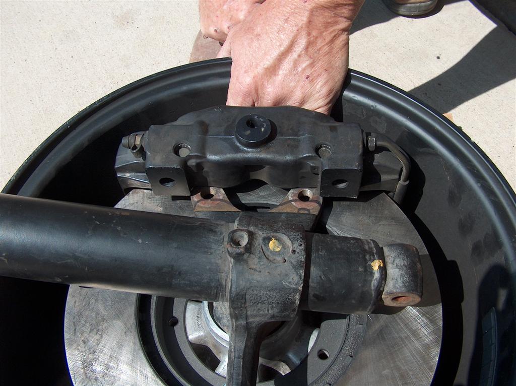

craig downs and i are working on it.
this pic should show how everything gets in the way (IMG:style_emoticons/default/smile.gif)
they fit under all 15" rims i own, cookies, fuch's, BBS 15x6, 7 and 8

Call Rich Johnson in Texas. He make adapters. I do not know if he has them for 3" spacing on your struts. He may be able to make you a set.

Rich was the first guy i asked before mocking up the 3" setup above.., there is physically no room for an adapter on a 3" strut.... you have to mill off the ears, weld up a little thickness, mill it flat.. and THEN make an adapter.

If you use 16 inch wheels and the adapters for the rear, plus carrera rotors, you can put them on the front. But it won't fit under 15" wheels.

that is the kicker - yep, rear adaptors on the front might get ya there.
gotta use 24mm thick carrera rotors anyway (IMG:style_emoticons/default/smile.gif)
clay - with 16" wheels, would that put the caliper too far outboard and not use all fo the pad on the rotor? - ie overhang?

That pic says it all. Tnx. The holes still looks to be in the same relative position to the 3.5" ears. I wonder if all the boxster adapters floating around move the caliper out radially like you mention and let the pads overhang. Not so good...

I have boge 3.5" spacing struts, with carrera rotors, non-s boxster calipers, and spacers all fits under a 15"wheel.

yep... that looks like the TRE kit. thats the bolt on approach...

With that pic even with the 3.5" spindle and the adapters the calipers are still not all the way in . Looks like they have a overhang to
