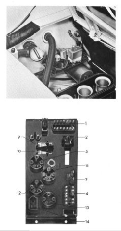

I have a '74 and would like to know where the fuel pump fuse is.... I see it's a 25a fuse on the fuse panel, but where?
Anyone have any pics?

It's on the relay box in the left front corner of the engine compartment. Haynes page 161, key 91

Fuel pump fuse is #10.
A short in the AAR wire will also cause this fuse to 'pop'.
