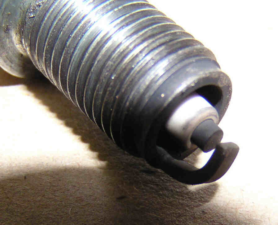

Dave, I need closer pics... Get them as close to the porcelin as possible... I'm looking for magnifying glass results...

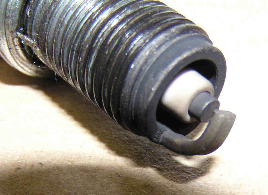

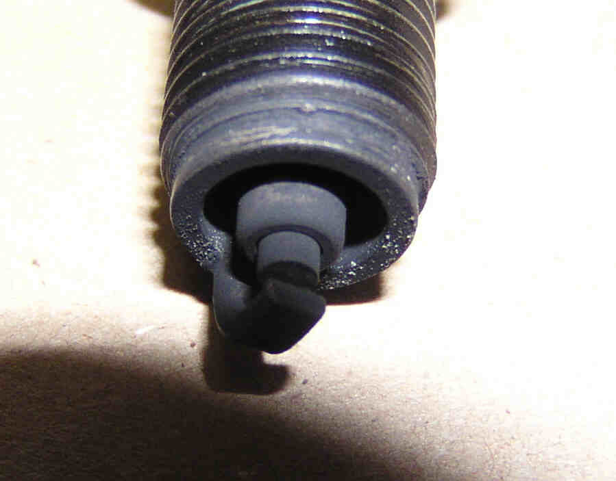

Here you go Jake, plug 1

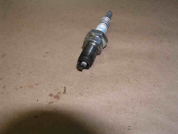

Plug 2

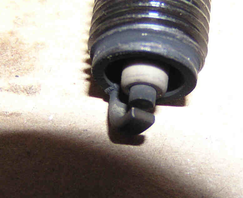

Plug 3

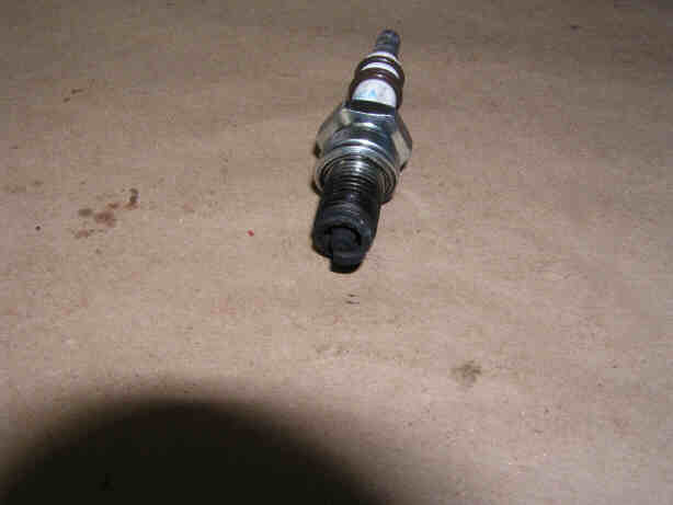

Plug 4

I see what appears to be proof of detonation on the #1 cylinder, but none of the others. Pictures are hard to use for this inspection.

Holy crap those are lean. Agree on the detonation.
