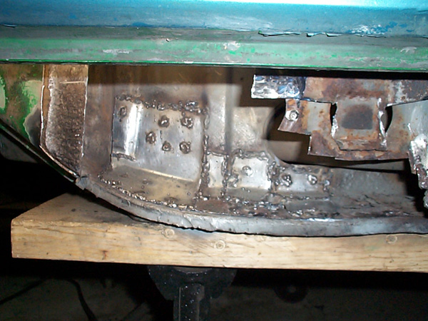

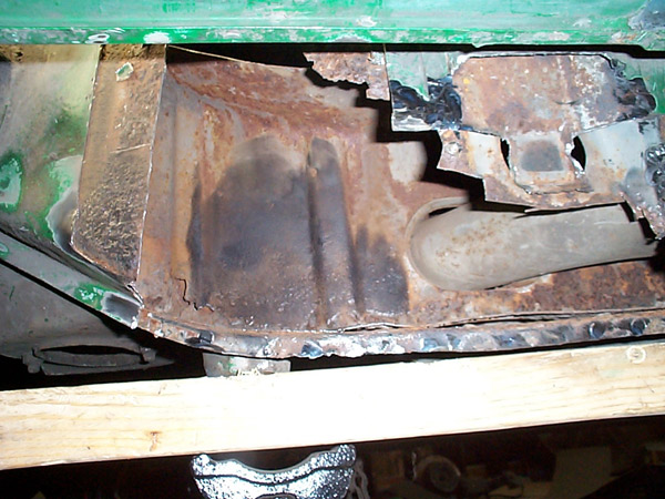

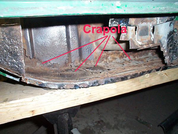

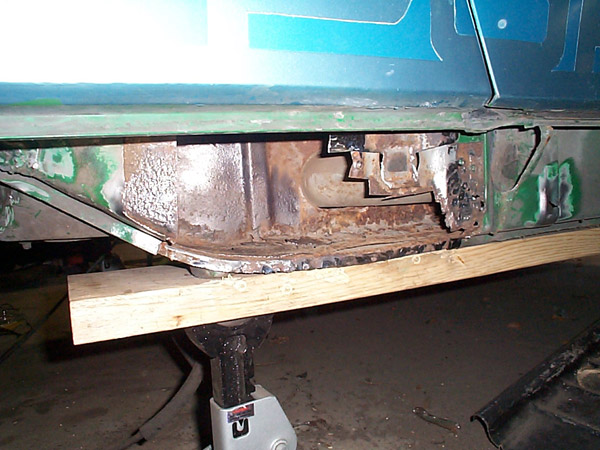

Ok, here we are on day 6 or something of the War on Rust. Today, I am focusing on the inner wheel house, lower portion. I removed the outer skin and the inner structure. Before would seal this area up, I wanted to see if anyone had any suggestions about what to do about the bottom of my interior longs. As you can see from the following pics, they are rotted on the bottom. I was kind of surprised that the car can rest on the jackpost here. The sides of the longs are redeemable, after some POR-15. Any suggestions? Should I just treat it with POR-15 and call it good? There door jambs are fine on this vehicle.
thomasotten   What to do about my inner longs   Nov 29 2003, 07:51 PM
thomasotten   More pics...   Nov 29 2003, 07:53 PM
thomasotten   last one...   Nov 29 2003, 07:56 PM
!   Fix em or buy a roller.....   Nov 29 2003, 07:58 PM
SirAndy   yup, weld'em up ...   Nov 29 2003, 08:03 PM
thomasotten   yes, fixem, but how? Not much room in their to we...   Nov 29 2003, 08:20 PM
!   Depends on your welding skills.....the right way i...   Nov 29 2003, 08:31 PM
RustyWa   Wasn't there someone here that recently, last ...   Nov 29 2003, 09:03 PM
thomasotten   About the same time that Saddam was being dug out ...   Dec 14 2003, 05:20 PM
Rob Ways   Nicely done! Another 914 saved.....   Dec 14 2003, 05:26 PM
Brad Roberts   Thomas, You are doing fine. The only thing I can ...   Dec 14 2003, 10:58 PM
SirAndy   spray plenty of metal ready onto all of the inner ...   Dec 14 2003, 11:39 PM

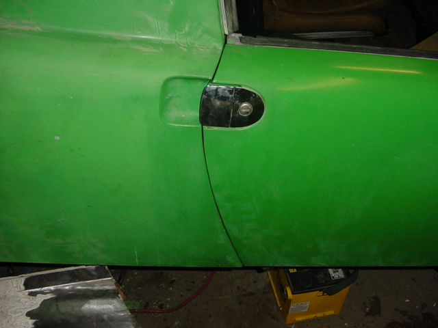

thomasotten   jdogg: I actually called George at AutoAtlanta wi...   Dec 16 2003, 12:30 PM
Brad Roberts   Problem is: the car's SHRINK when you start we...   Dec 16 2003, 01:56 PM
stock93   Yeah make sure you do what brad is talking about. ...   Dec 16 2003, 02:00 PM
Brad Roberts   You'll have to cut any tabs you have connected...   Dec 16 2003, 02:03 PM
stock93   The doorgaps are even, they are just to small. I...   Dec 16 2003, 02:07 PM
RON S.   I had to make a door jig when I replaced my inner ...   Dec 16 2003, 02:09 PM
Brad Roberts   We jig the cars PRIOR to cage/welding.. Cellette ...   Dec 16 2003, 02:14 PM
