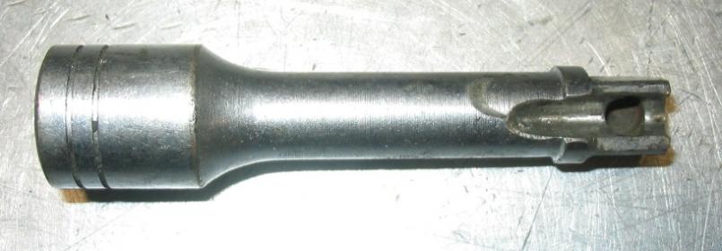

It can be done. There are special sockets made for this that have a slot for the wire. I use a deep six point socket that has the face ground flush so it grabs as much of the sensor as possible. To clear the wire use an extension that has one corner ground off. Thread the wire up thru the socket then put the extension in.

Yes. 13mm very deep socket. grind one corner off a short extension for the wire to pass thru.

Bleyseng
post Apr 15 2007, 10:17 AM
Aircooled Baby!
Posts: 13,037
Joined: 27-December 02
Member No.: 24
QUOTE(vsg914 @ Apr 15 2007, 06:57 AM) *
yep, this is what I use. (IMG:style_emoticons/default/agree.gif)

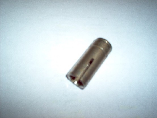

NoEcm
post Apr 16 2007, 01:10 AM
Posts: 95
Joined: 20-June 05
From: Seattle, WA
Member No.: 4,309
This works too (circa 1981 or 1982):
