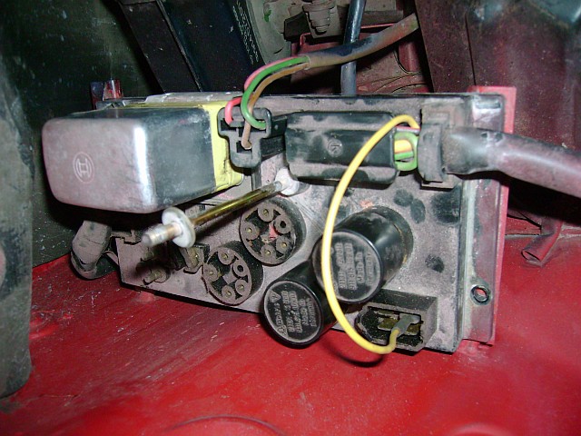

The pump should also run when the starter is cranking; that's what the wire hooked onto the four-pin connector on the relay board does.
--DD

Is that a single yellow wire? If so I unplugged it because it caused the starter to not stop cranking over (IMG:style_emoticons/default/screwy.gif)

The single yellow wire to your starter is from your key switch which delivers the 12VDC to the solenoid in the "start" position.
If the starter continues to run, you've got problems elsewhere (Ignition switch, relay board connections, starter solenoid or incorrect wiring.

that yellow wire goes to the bottom RIGHT pin on that 4 pin connector.
any of the others get either ground all the time or get 12V all the time, neither of which is what you want.
I had an issue with the starter not quitting starting from that yellow wire being plugged in, but I eventually figured it out.

Bottom right is i'm looking from the battery tray? or from the trunk?
bd1308
post Apr 18 2007, 04:04 PM
Sir Post-a-lot
Posts: 8,020
Joined: 24-January 05
From: Louisville,KY
Member No.: 3,501
trunk

mine was always plugged into the left thanks

QUOTE(jd74914 @ Apr 18 2007, 03:06 PM) *
Mine was always plugged into the top right and all worked great for two years.

if you stood behind the trunk and was looking at that pin, is it not the bottom right?
thanks

The fuel pump is powered 2 ways, one by the starter circuit when the engine is cranking. That signal is obtained by connecting the yellow wire on the engine harness to one of the 2 rearmost spade connectors on the 4 pin relay board connector. Both of the rear pins are connected together. (And a trivia item, you can connect a remote starter button to those connectors and feed battery voltage to them to get the engine to crank).
