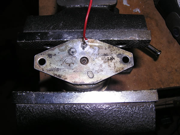

I've been attempting to find a good used AAR, as others have, and have had no luck. So, I decided to fix the darn thing. It's actually a simple device. I believe typically two things go wrong.
1) The insulation between the housing breaks causing a short. This causes the fuse it shares with the fuel pump to blow, which causes the car to come to a discouraging halt.
2) The tube with the slot port gets stuck and won't close.

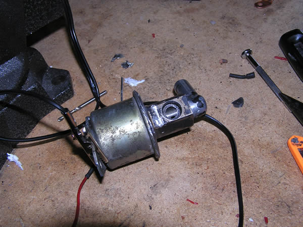

If your insulation is still good, but the port won't close, you may be able to free it by removing the pipe, squirting in your favorite solvent: PB Blaster, WD-40, vodka, etc. Work the tube back and forth to free it up. I was unable to do this and needed to repair the wire, so I opened it up by grinding off the lip of the bottom housing with my Dremel.

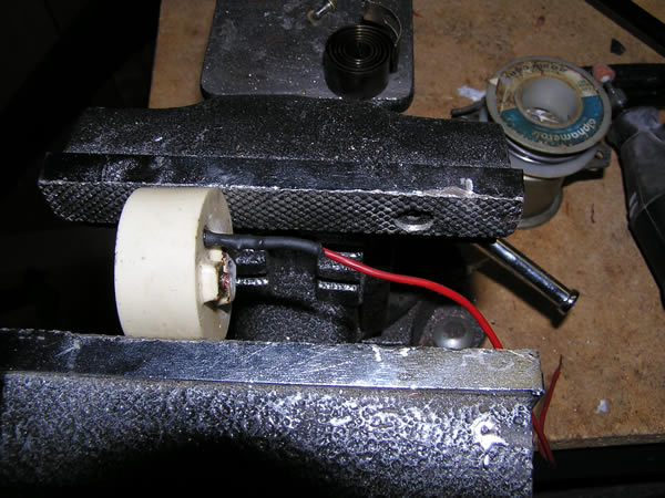

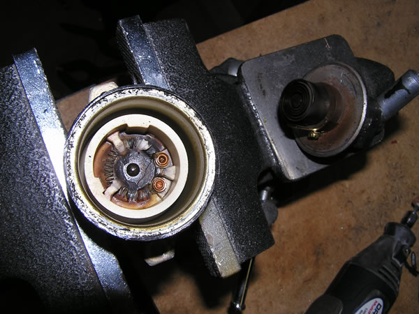

Once, the top is off you can see the inards. Basically a ceramic base with a simple heating coil on the bottom.

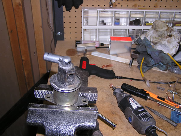

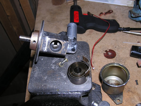

The top has a spring like piece attached to the tube which expands when heated and gradually closes the port.

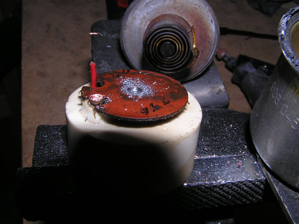

Next, drill out the rivets on the bottom. The center one holds the ceramic base to the housing, the other is the ground. The wire piece can be clipped off with wire cutters.

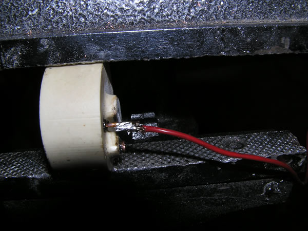

Under the ceramic base is a heat shield and a nub of the remaining hot lead.
blitZ
post Apr 20 2007, 08:34 PM
Beer please...
Posts: 2,223
Joined: 31-August 05
From: Lawrenceville, GA
Member No.: 4,719
The wire repair involved tinning the wires back together and covering with some shrink tubing. I added a little sillycon around the shrink tubing and the ceramic base to prevent any possible short.

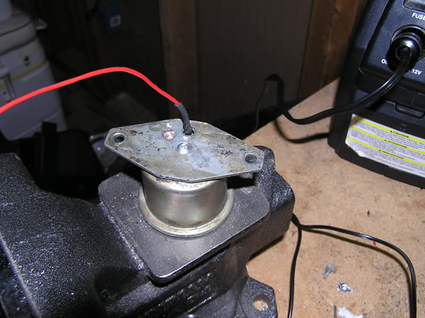

Place the ceramic base back into the bottom, lining the holes up. I used a pop rivet to secure it. Some solder was melted into the ground hole to secure the ground pole to the casing.

I have a portable compressor with a 12v supply I used to test. You should be able to feel the base heat up and watch the port gradually close. I secured the top back on with a little wire. It will be easier to get back into if another repair is required. It's working fine so far. I think it's possible the heating coil could break, however it could be easily replace with a little solder work.

Since you already pulled off the side port, I suggest removing the top port, too. This lets you remove the rotating cylinder, enabling you to clean the bore completely. Make sure when you're removing the bimetallic coil that you mark the position - this determines the "calibration" of the AAR.

I actually played around with the calibration as to how long I wanted the high idle to last. Things change after 30 years. The heat coil doesn't heat up as fast as it used to and the bi-metal coil has been through umpteen heat cycles. YMMV
