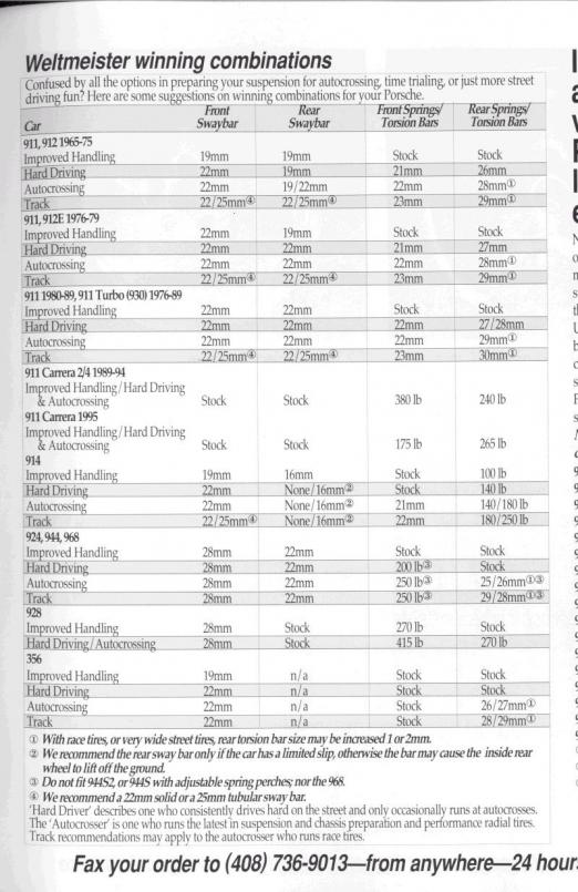

sean_v8_914   I agree with Dan. that is a AX car set up. street ...   Apr 21 2007, 11:03 AM
sean_v8_914   Weltmeister chart   Apr 21 2007, 11:08 AM
Eric_Shea   Brought to you by the friendly folks that sell W...   Apr 21 2007, 11:28 AM
