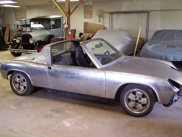

This is the black widow....naked

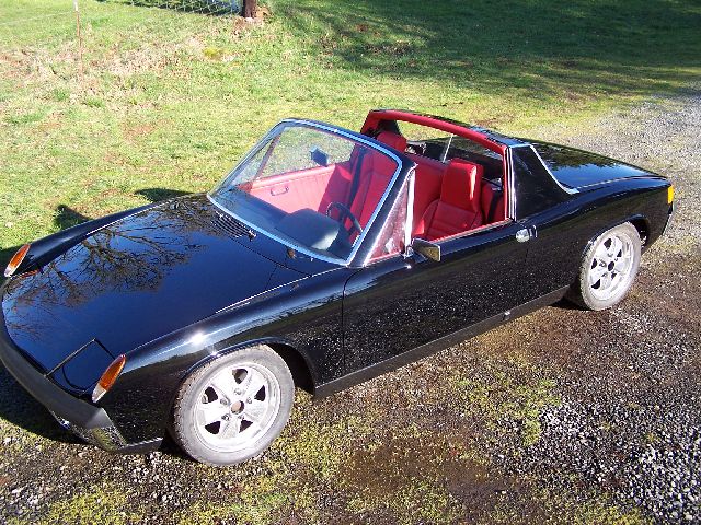

boxstr
post Apr 26 2007, 10:30 PM
Posts: 7,522
Joined: 25-December 02
From: OREGON
Member No.: 12
The black widow....basic black

QUOTE(boxstr @ Apr 26 2007, 09:28 PM) *
How many paint jobs up to that point, and how did you get it down as a complete car? Or did you?

The black widow was an original black 74. I purchased hte car from Dan Root, It appeared that just one repaint(very poor) was applied to the car.
I stripped the car and a couple of people hand sanded the car to what you see in the pic.
The body had no bondo or patch panels or rust. All of the lids and doors were removed for paint and reinstalled for proper alignment.
