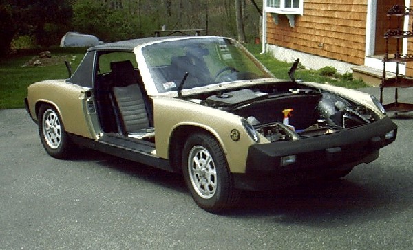

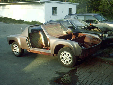

I too was worried about being able to get as durable a paint job as the factor, and also about removing paint from areas where I could never replace it. So I dipped my doors, engine lid, and headlight covers. Then I had the trunk lids blasted, to keep the paint plus Ziebart intact in the channels.
That pretty much left the four fenders, and after cutting them out for flares, there wasn't much of them either. My car had been repainted, back in '80, so I could hand sand the fenders and use the different paint layer colors as a depth gauge. I took it down to a mottled mix of original primer and original color, mostly primer.
My car was virtually rust-free. Trunks and engine compartment were Zeibarted after that repaint in '80. Terrible stuff to live with, especially in the trunks, but after soaking it off with solvent and rags, it had done it's job. I left it on the undersides, just cleaned it and freshened up the wheelwells.
Every car is different and needs its own strategy. The hybrid approach worked for me.

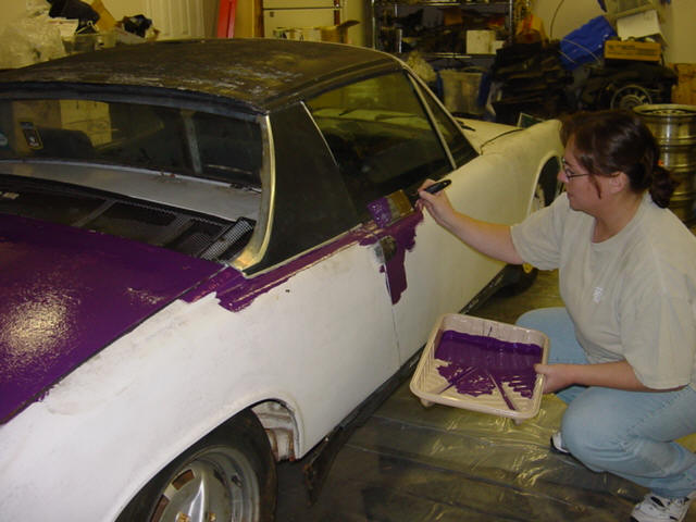

I don't think you need to remove all the old paint.. just get a nice, thick napped roller and paint right over that rust, dirt and anything else you happen to find.
Then the owner sees his car and ends up looking kinda like this...
Seriously.. with cars as old as ours, you almost have to take them to bare metal to get them right. After 35 or more years, you don't know what horrors could be hiding under the seemingly original paint.

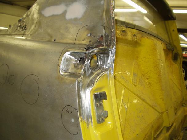

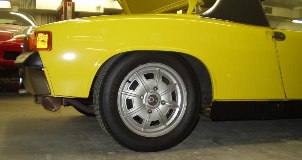

1st two 75's I restored, I just sanded down to good solid factory paint and stopped...Both later had rust seep through in places we thought were solid...
Current 73 model (Speed Yellow) was torn down to "tub on a furniture dolly" condition, media blasted to bare metal and we found rust damage in places we thought were solid...
Moral of the story, rust is sneaky and hides better than you thought...Take it to bare metal so you can find all the hidden rust and repair before paint...
You can fix it now or fix it later, but your gonna' fix it...

It's a tough decision if you are on a budget.....
Beneath this decent looking paint (redone in 1979) lies the reality of rust.
