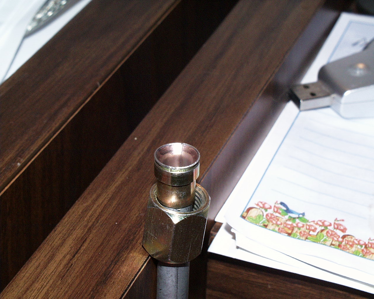

I didn't find any discusion on this so I thought I would pass this along.
I was working some more on my fuel system today and was practicing making some 37 degree AN flares on the tubing. Well as it turns out standard brake line tubing doesn't seem to be seamless. After flaring the tubing the seam will start to split and leave a nice path for a leak. So, it's now either get a roll of SS seamless tubing or get the pre-made line from Tangerine Racing.
