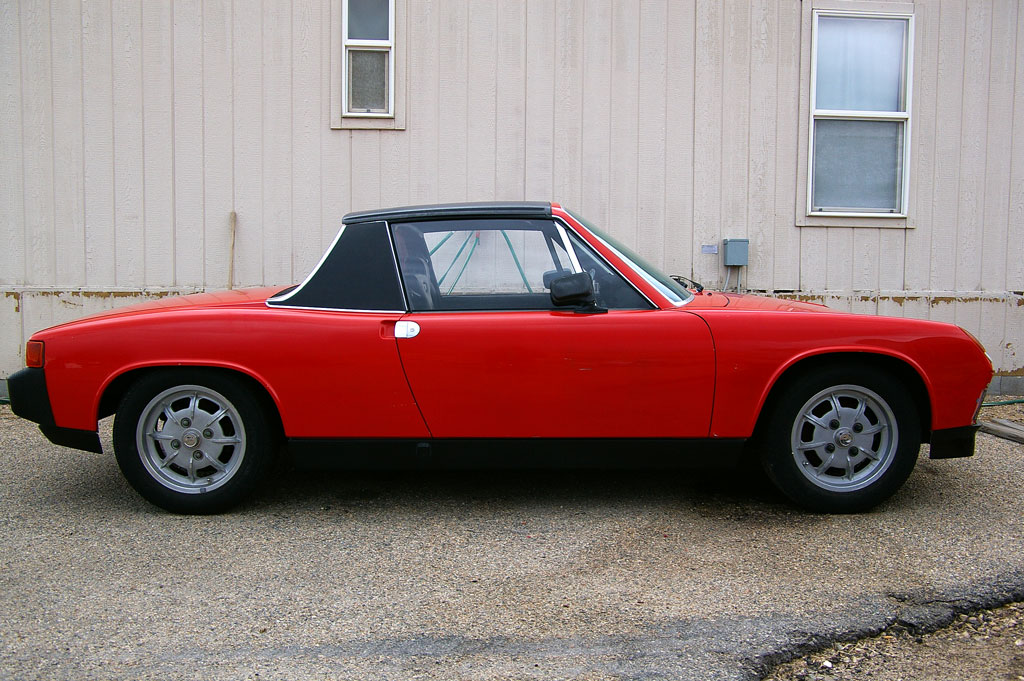

After installation and off the jack stands... minus glass front bumper.

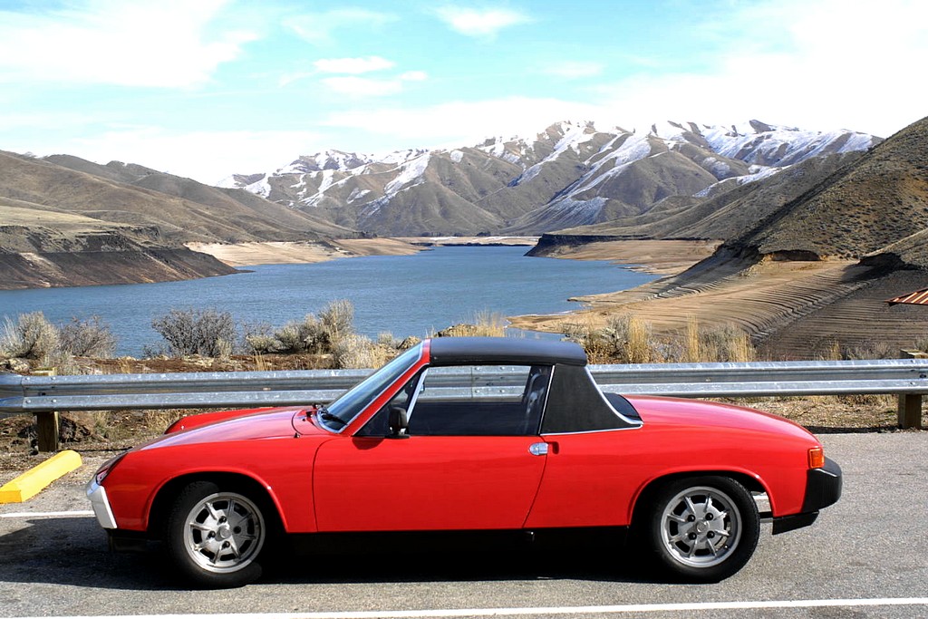

Running, first road trip to Lucky Peak Lake, Idaho.

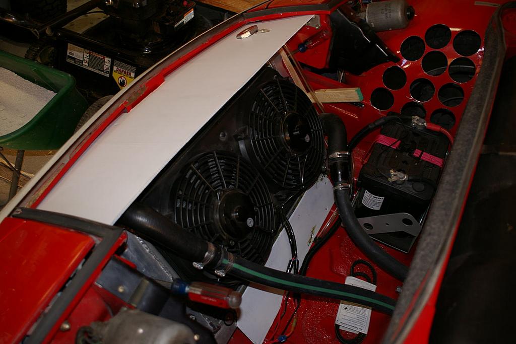

Tonight I cut shrouding templates from corrugated plastic (looks like cardboard but is made of plastic) glued in place with 3M super adhesive to see if it makes a difference. If it does then I'll use the templates to cut the shapes from aluminum and put in place permanently. Foto attached of the templates (the screwdrivers and wood blocks are there to hold templates in place while glue dries).

What fans are you guys running? I'm looking for a nice compact fan set-up and I like the built-in shrouding you've got.
Jeff
dbledsoe
post Jun 21 2007, 11:10 AM
Post #60
Mutineer
Posts: 300
Joined: 13-May 03
From: Boise, ID.
Member No.: 687
QUOTE(GS Guy @ Jun 21 2007, 07:03 AM) *
Don,
Jeff
Jeff,
My fans are the Flex-A-Lite Dual 10 (Model 310) with adjustable thermostat control. The best price I've seen them at are on eBay:
http://cgi.ebay.com/ebaymotors/310-Flex-a-...5QQcmdZViewItem
Don
