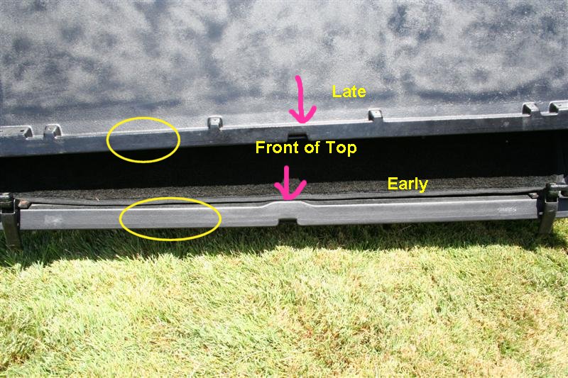

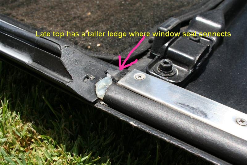

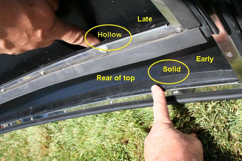

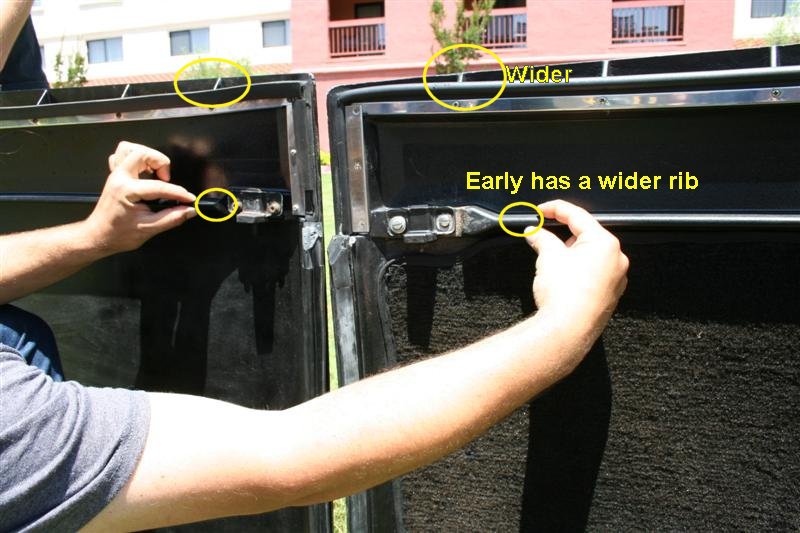

The differences between the early (pre 73) and later Targa tops is shown below. The most significant difference is the step where the window seals attach. I suspect due to the different windows used in the 73 up cars. I'm checking that out now. The step is noticeably taller or hangs lower on the later tops.
Other differences are shown but I suspect they won't have a major impact.
Thanks for those at WCR who volunteered their tops for the inspection

I've got a late top and early windows and it does not seal right at all.
The top should match the windows ...
(IMG:style_emoticons/default/shades.gif) Andy
PS: Maybe the transition year was '72, can't remember. Somewhere in there they switched windows and tops ...

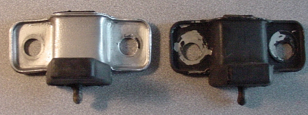

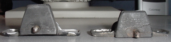

Any yet another difference...the height of the rubber bumper

When using a late roof on an early car should the early rubber stops be switched over to the late roof? (I have 74 doors on my '71)

So which rubber block is early/late?

Looks like it's early on left and later on right.
If I'm not mistaken.
