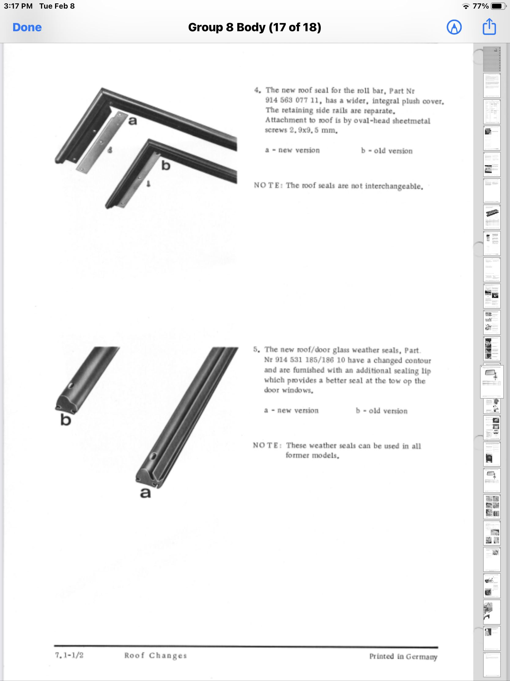

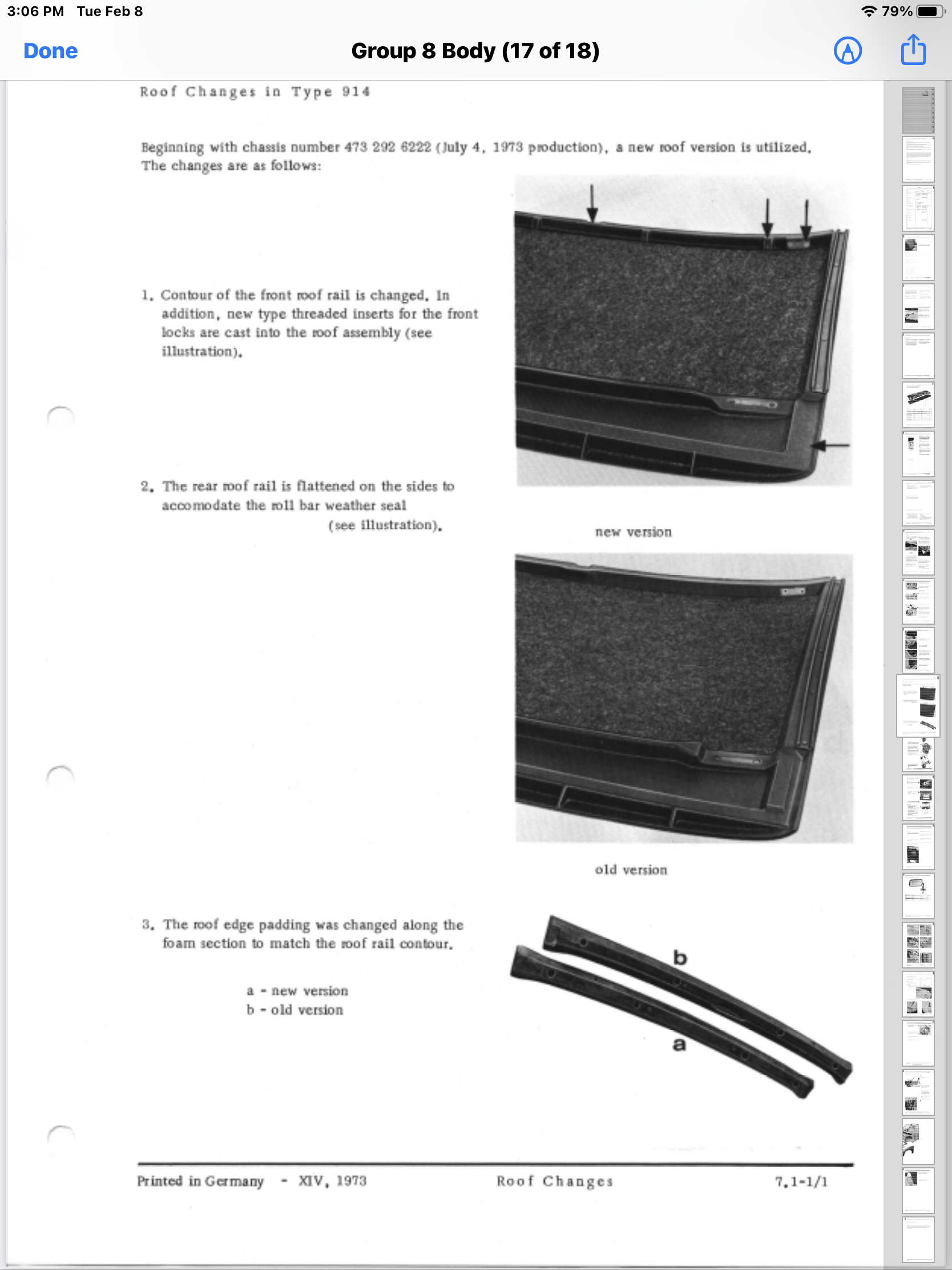

The official word from the factory manual.

I have 2 tops for my resto and I was just looking at 914 Rubber today for seals and found out there was an early and late top. So now I know that both my tops are late tops. Great info, thanks.

Also, as established from the manual, 73 cars starting from VIN 4732926222 (July 4th, 1973) used the late top, whereas early 73 cars (most 73s) had early top, yet with late window mechanism. This has been correlated by many owners. (IMG:style_emoticons/default/smilie_pokal.gif)
