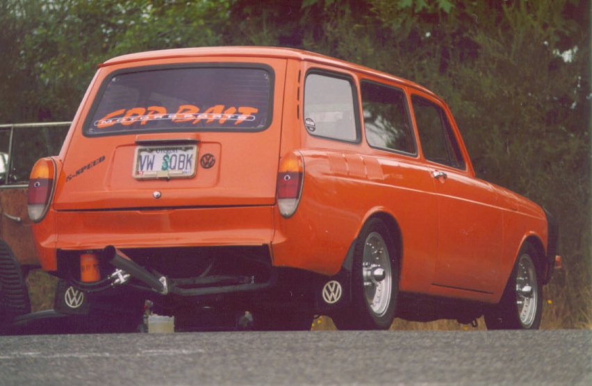

Go to the powder coating shop and look at their samples! The place we go to has a Safety Orange that looks like the exact color for '72 Bright Orange (our car color (IMG:style_emoticons/default/wink.gif) ).
