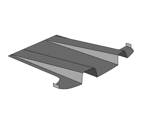

I want to make a diffuser/engine pan for my car, and last night I started gluing foam sheets together to make a mold. My plan is to form the foam into the shape I want and then seal it with body filler, and then primer and polish. I have been reading up on making molds for composite work and most seem to talk about making a copmosite piece for the mold rather than what I am planning. If I make my mold as described will my composite part rip the mold apart when I seperate the two? (assuming I use a PVA mold release film).
Also, if I make the part with carbon fiber, how do I finish the edges of the piece when I'm done?
I would like to vacuum bag this part because the part will be visible from the top and the bottom... Can I get away not bagging it and get a decent finish? (I'm not super concerned that it has a perfect surface really).
-Tony
Finished part will look something like this...
With the long straight edge meeting up against the firewall and the two tunnels exiting right under the bumper.
