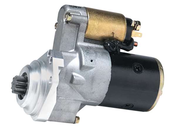

ConeDodger   McMark says that they engage too deep. He would pr...   Aug 16 2007, 11:01 AM
propricer   Was that the hi-torque starter that you buy on eba...   Aug 16 2007, 12:34 PM
Dr Evil   That looks a little bit different than the one I b...   Aug 16 2007, 12:40 PM

McMark   Perry, I agree with your logic. My concern is th...   Aug 18 2007, 12:40 PM
HIPERFORMANCEUSA   Perry, I agree with your logic. My concern is t...   Aug 18 2007, 02:50 PM

McMark   Yep, there seems to be two different high torque m...   Aug 17 2007, 11:31 AM

Dr Evil   Digging further, I can tell buy the picks in Sam...   Aug 18 2007, 12:10 AM

SLITS   Sam uses the Hitachi starter it appears. The IMI ...   Nov 2 2012, 11:11 AM
HIPERFORMANCEUSA   Sam uses the Hitachi starter it appears. The IMI...   Nov 2 2012, 03:59 PM

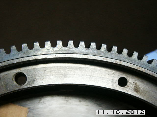

larryM   :cheer: RIMCO VW does it all - $130 includ...   Nov 8 2012, 05:50 PM

larryM   here is a picture of the RIMCO repaired ring gea...   Nov 16 2012, 05:35 PM
