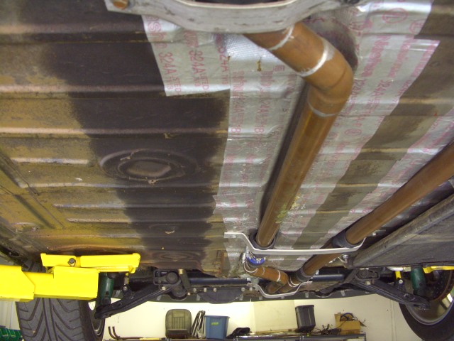

Vacca Rabite   I don't know about the copper tubing for the c...   Aug 17 2007, 09:49 AM

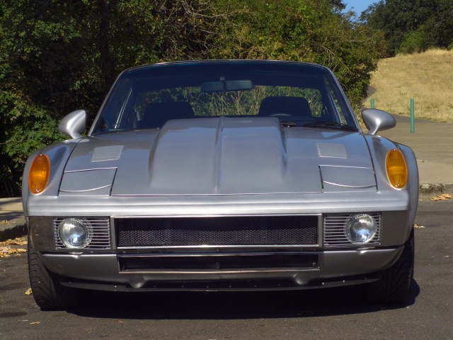

aircooledboy   I'm not sure what I think about that hood, but...   Aug 17 2007, 11:02 AM
Elliot Cannon   One of the nicest conversions I have ever seen. I...   Aug 17 2007, 11:45 AM

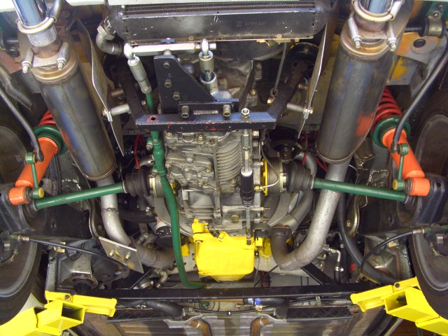

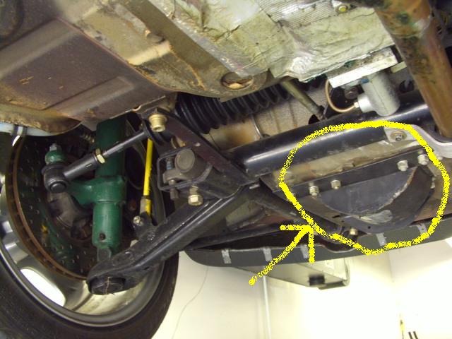

Jeff Bowlsby   Is this for power steering? See also the front tr...   Aug 17 2007, 12:42 PM

Series9   5) Heatshields installed where needed. 6) Provi...   Aug 19 2007, 10:28 PM
alpha434   I'd like to point out the heat shielding. Arou...   Aug 17 2007, 03:00 PM
zymurgist   I'd like to point out the heat shielding. Aro...   Aug 17 2007, 03:19 PM

Series9   Well the guy doesn't know how a rear sway bar ...   Aug 19 2007, 02:40 PM
Series9   What? No replies? Look. Horizontal drop links d...   Aug 19 2007, 09:38 PM
Brian Mifsud   What? No replies? Look. Horizontal drop links ...   Aug 20 2007, 12:32 PM
jmmotorsports   It seems typical of the type of person who puts an...   Aug 21 2007, 08:26 AM
Series9   OK. Here's how it should look. See that the d...   Aug 19 2007, 09:52 PM
