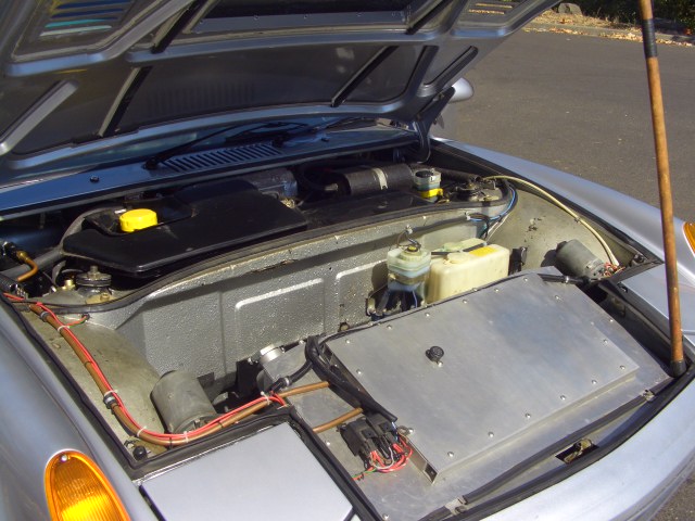

I'd like to point out the heat shielding. Around the mufflers and around the copper tubing.
VERY nice touch. Attention to detail. Maybe the guy was a helicopter mechanic.
And to justify the copper tubing... The idea was probly to displace as much heat as possible before getting to the radiator and before getting to the engine. Not being as strong might have been an oversight. But I doubt the guy would've "lost" his presence of mind driving over a big speed bump. Not if the rest of his car indicates what he's like.

I also don't think you can tell that it's been technically thought out and well engineered because there's a lot of well-done bodywork and some expensive bolt on parts.
Yes, you CAN see that things were well thought out. Here are some examples:
1) Rear Oil Cooler Placement, set up on rear bumper in high drag/vacuum part of slipstream for good airflow
2) Careful cable and tubing routing all over the car (I've already said my bit about the cooling lines under the car.. not a big risk). Wire and cables are well insulated and secured.
3) Great Sheetmetal work: all holes/apertures cut into the body are well finished off so no sharp edges to cut cables/wire/hands etc.
4) Weak parts of car reinforced.
5) Heatshields installed where needed.
6) Provision for engine room cooling.
Each of those items indicate to me that this guy understands cars, and has an eye for detail. He also has enough experience to ANTICIPATE problems, and thus, put the solution in place ahead of time.
I don't see many "fancy" bolt-ons, mostly handmade one-off solutions, but they look rugged and sensible. It also looks like you can get access to the service items you need to.

QUOTE(alpha434 @ Aug 17 2007, 05:00 PM) *
Heat in the cockpit... hmmm, maybe the guy owns a Corvette.

A guy took a 914, and he put a V8 in it to make it really fast. Rather than just cram in a poorly planned conversion, he appears to have thought out every last detail right down to appropriate suspension and brake modification, chasis reinforcements and a modified shift linkage. He carried out the conversion in about as bullet-proof and badass of a fashion as he possibly could, apparently leaving no potential problem unaddressed. He customized a few things along the way to his taste, maybe a few over the top, ultimately resulting in a car that any objective car guy would have to respect as being amazingly well executed from an engineering and mechanical point of view. (IMG:style_emoticons/default/aktion035.gif)
Yeah, those copper lines are great (IMG:style_emoticons/default/rolleyes.gif)
And the hood!! Are you kidding? this isn't a Chevelle or Camaro....
Everything else looks OK I guess, I think it is just a little over the top (IMG:style_emoticons/default/biggrin.gif)

Don't think he has to worry about crushing the copper ... it sits like a Cayenne ...

Sweet front hood prop..... (IMG:style_emoticons/default/biggrin.gif)
