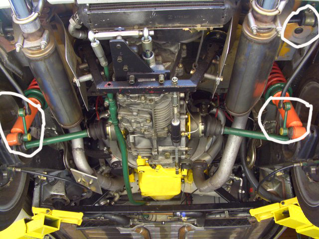

Well the guy doesn't know how a rear sway bar works.
The brackets are in the wrong place, rendering the bar completely nonfunctional.
That alone, calls into question his ability to build a quality car.

What? No replies?
Look. Horizontal drop links do absolutely nothing. The bushing brackets are about 2" too far aft.
It seems typical of the type of person who puts an American V8 in a 914. They're looking for 1/4 mile performance, while having no understanding of how a sports car actually works.
Have a look at the white outlines:

OK. Here's how it should look.
See that the drop link is vertical?
That's how it goes:

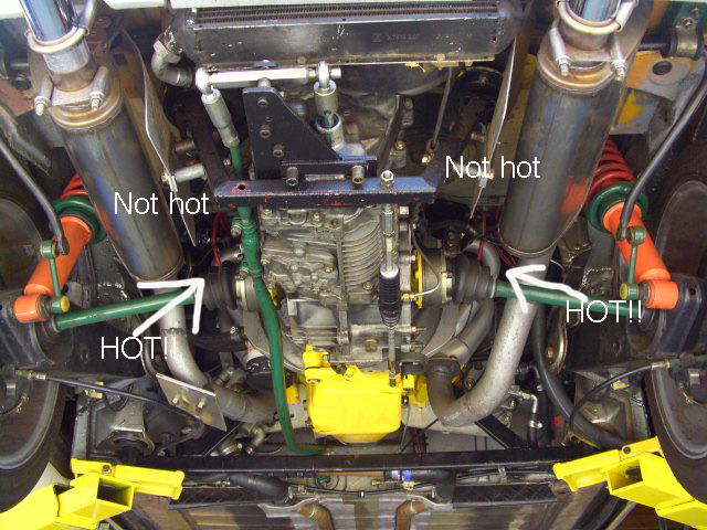

QUOTE(Brian Mifsud @ Aug 17 2007, 03:02 PM) *
5) Heatshields installed where needed.
6) Provision for engine room cooling.
Bullshit. He covered cool parts with shields and left the CVs uncovered.

I think when the car is sitting on it's wheels the angle of the links will improve. The wheels are at full droop. He has the springs set to ride higher so they will force the arms farther down when it's on a lift. His car may squat quite a bit when he takes off hard. Your yellow car sets quite a bit lower so the rear arms don't drop as far when the weights off the wheels. The bar could have already been on the car and he didn't notice the angle. He probably has never raced the car anywhere but at the stoplight, don't try him there with your porsche 3.6. you might get a lesson in torque. Also the shields are on the mufflers to prevent the heat from getting to the oil cooler it looks like to me. He put the bulge on the hood for the same reason I've got one on my k5 Blazer, he liked it.
Charlie

QUOTE(charliew @ Aug 20 2007, 02:19 AM) *
I think when the car is sitting on it's wheels the angle of the links will improve....
It's simply not true. The bar is mounted to the wrong place on the chassis. That bar doesn't work.
