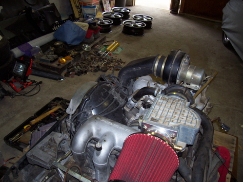

Los Angels Porsche parts dismantlers . 6500.00 complete . Motronics and a tac . Delivered to central coast ( monterey Bay ) About 110 thousand . I did a leak down , 12/10/12/15/15/15 . Nice numbers and a 90 warenty. don welch oil tank 1000.00 . Well u get the idea . (IMG:style_emoticons/default/smoke.gif) Well werth every penny .

Smokey,
That is going to be a very nice ride.
