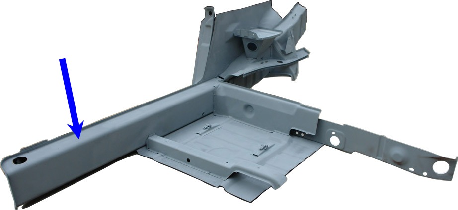

From: Bay Area, CA
Member No.: 7
That crack is a flex crack in the longs, I never noticed it in mine till McMark pointed it out, he tells me that they commonly flex and crack in this area.

The paint is not perfect, it is not bad though a couple bubbling spots etc ... and I had anticipated a new paint job down the road. I am in no way emotionally tied to this car, just the fact I bought it and want to get it the way I want it. As for top dollar no, but had I known what I know now (bet there are a lot of people on this list who have been in the same situaion) you would not have seen me for dust. In the end I only have myself to blame, lesson learned.
Back to the problem at hand, I am concerned about getting the car in the air and taking of the outer rocker as with the inner so bad it is the only thing holding it together on that side. Is the arrowed item the inner part of the clambshell?
