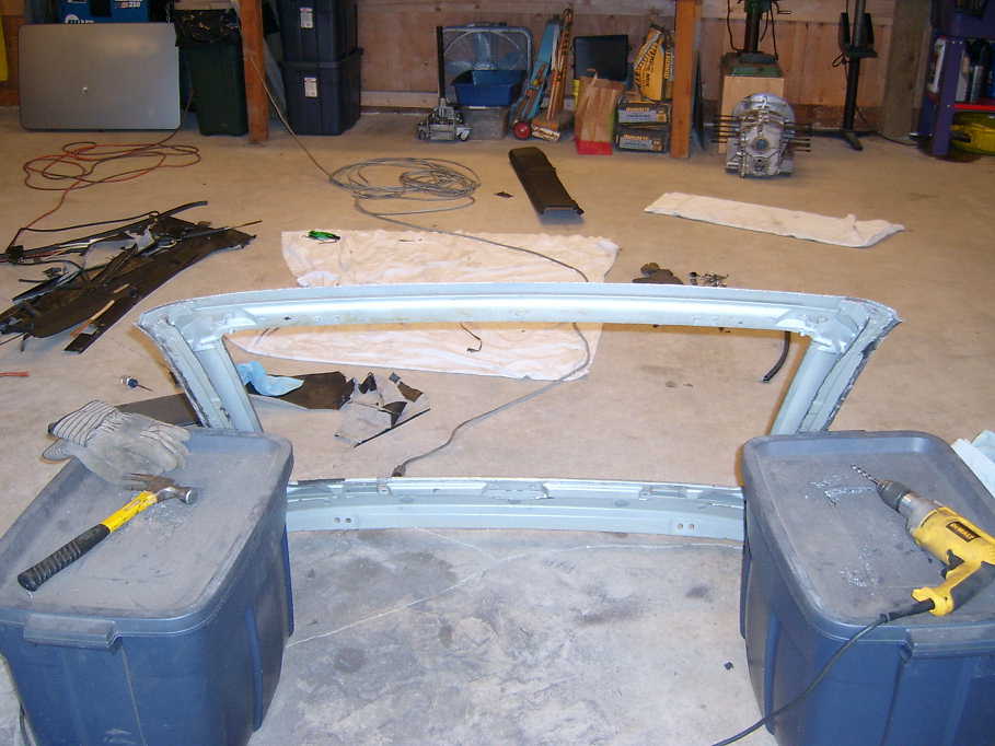

The first thing I started with was a handful of measurements and compound curve demensions. Then my son and I zipped on down to a local bone yard and started checking out roofs on various cars. I wanted to keep it in the "Porsche family" or at least in the P-VW-Audi family, so we started there. Turns out, the 944 has an almost spot on match to the first main raidus required for the job. Hmm, $100 and a sawzall later and we had the top of a 944 sitting back at the house. Here is the basic starting piece I had. This is where the fun and frustrations began. (IMG:style_emoticons/default/wink.gif)
My first cut was for the front, measured from the windshield frame back to where I figured the back should end correctly. I studied 100 916 photos and had them plastered everywhere during this whole process.

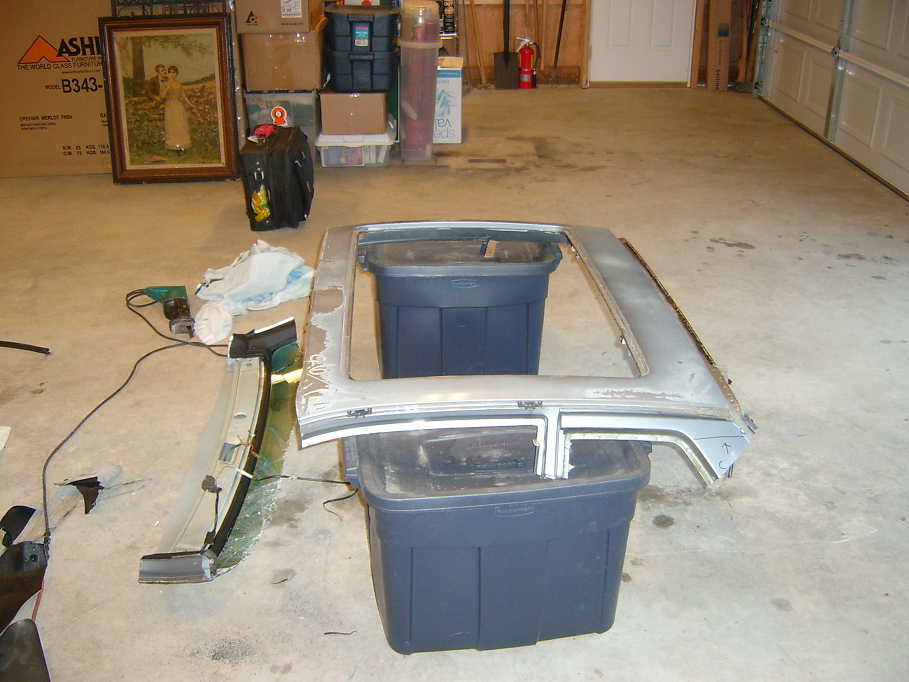

Here is a little more cut off, there is A LOT that was removed and yes, I wanted a sunroof and yes, the drain tubes are hooked up and yes, it all works and is completely unseen as if done by the factory. So yes, you can have your cake and eat it too on this one. This conversion completely changes the car. I also have the Engman inner long kit installed and holy crap, it's a stiff one!

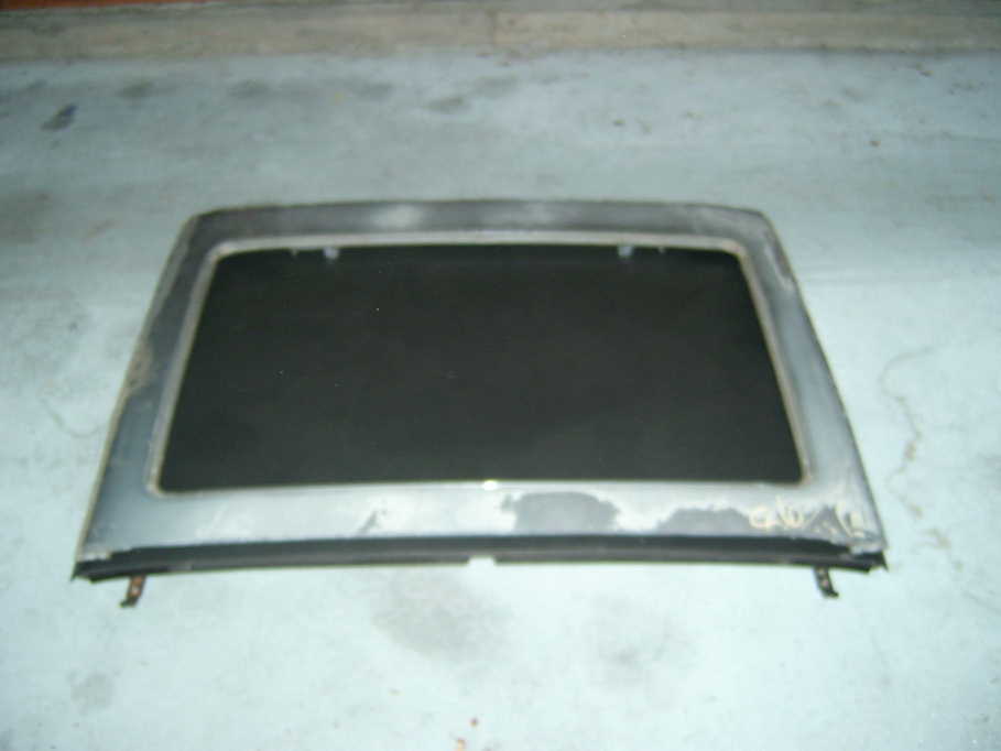

This is one crappy photo, sorry about that. But after cutting off much of the sides that would meet up with the doors and rear quarter windows, I was able to start laying the steel section on top of a 914 top to start getting ideas of where to go from here. One thing I noticed right away was I was going to have to create something to add about 1 inch to each side and make it have a compound raidus. Nothing like keeping it simple huh? (IMG:style_emoticons/default/sad.gif)

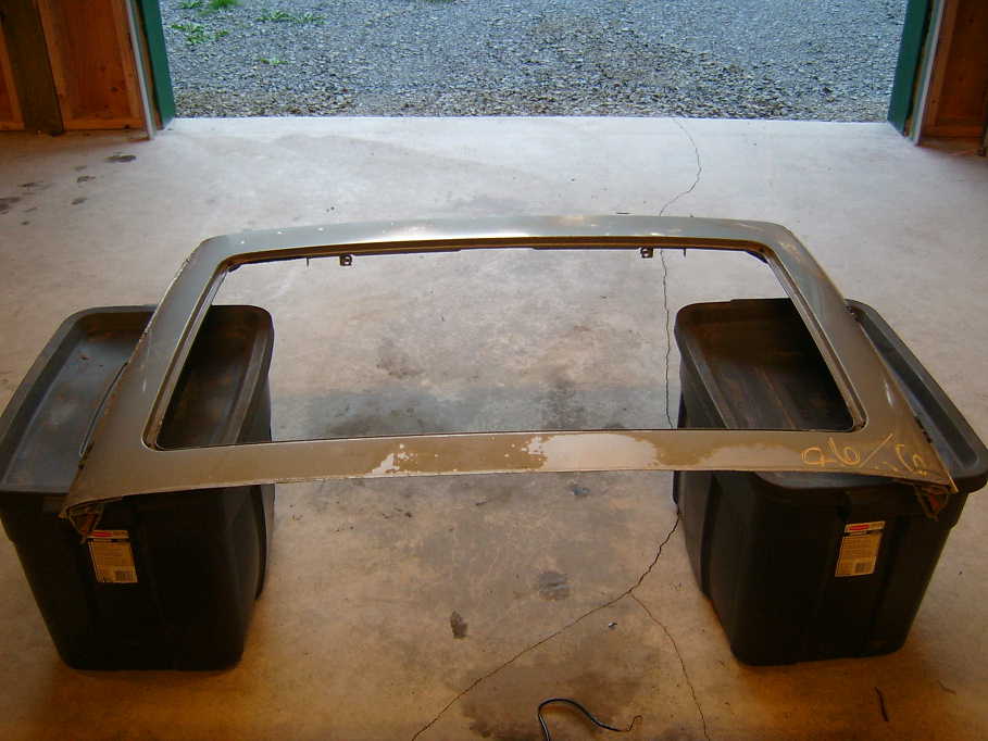

Here is a better shot showing more of the material removed. I must of drilled out 1000 spot welds, ground down and cut off gobs of metal trying to leave as much alone as possible to retain strength. You can also see some 944 interior parts laying around. I went through I think about 5 versions before finally settling on the final one. Oh yeah, the finished top with sunroof in and all interior parts wieghs 6lbs more than the glass top, I figure with welding and skim coating(body work) max of 10lbs added to the car.

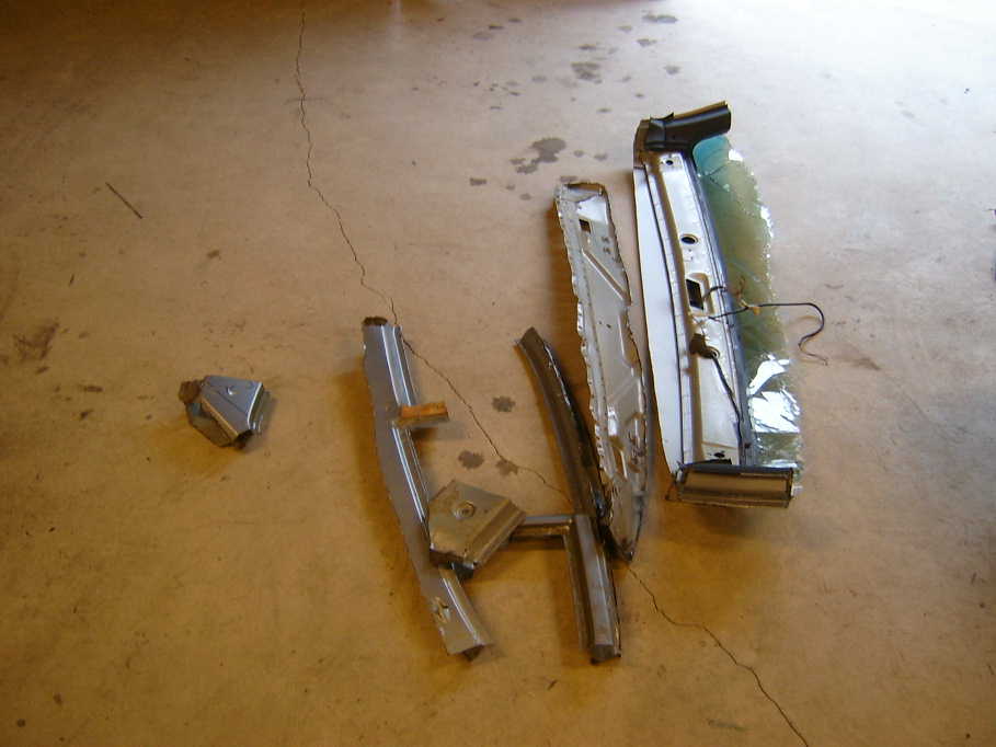

Here are the final first version removed pieces from the 944 roof section. I wound up having to build and box in top out longitudes for both sides to acomplish my goal, stiff as a 916, but still with an open roof. It was too cool watching the Yard Dude cut the roof off the 944, he pretty much sawzall'd right through everything, glass, sunroof cables etc. 944's are plentiful at bone yards right now. Last post for the night, more to come later this week. (IMG:style_emoticons/default/wink.gif)
