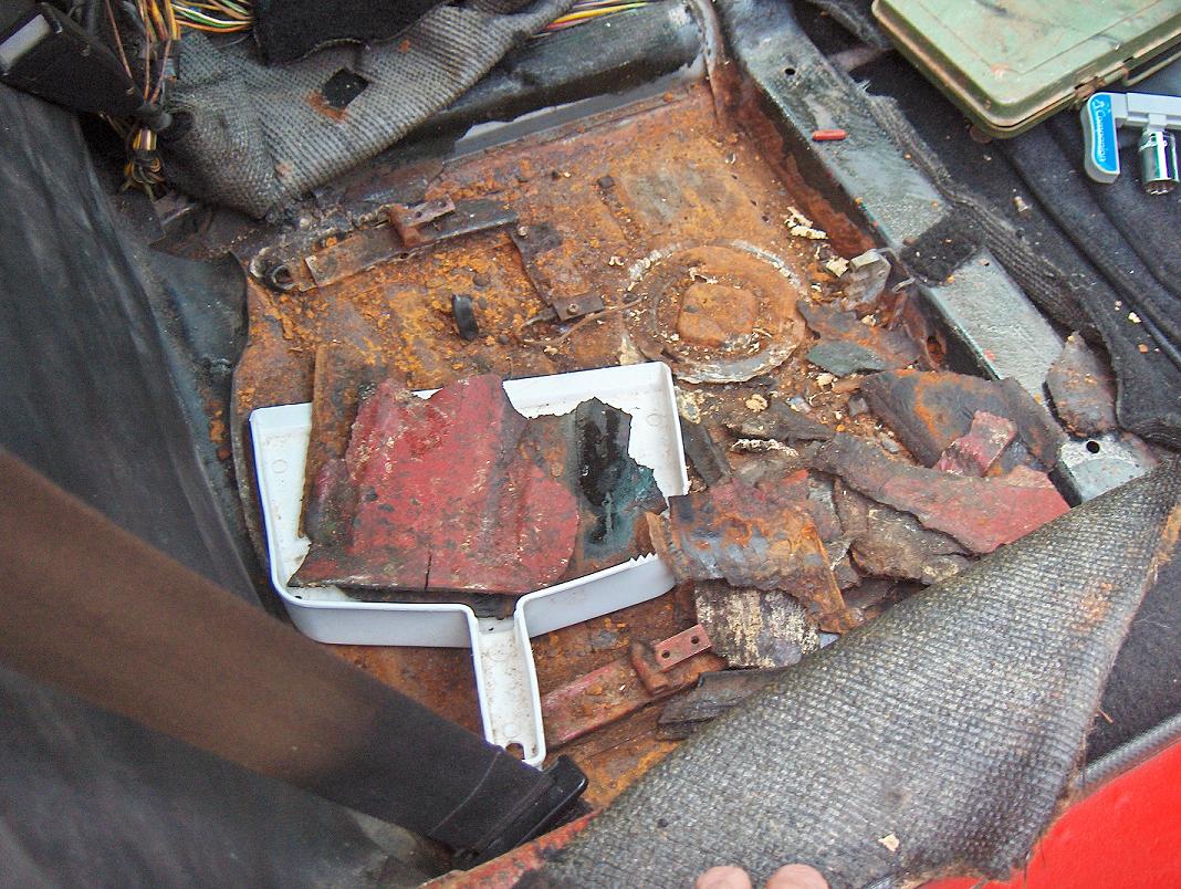

type47   is it rusted through, that is, do you see the road...   Sep 23 2007, 02:18 PM
stateofidleness   Now I've pretty much read EVERY thread in the ...   Sep 23 2007, 02:21 PM
stateofidleness   Type, it is rusted through in SOME spots but not a...   Sep 23 2007, 02:25 PM
Blood red 914-6gt   I have a new rear pan with the stiffeners that I t...   Sep 23 2007, 02:57 PM
Bartlett 914   That all looks repairable. I would look over the l...   Sep 23 2007, 03:02 PM
Chuck   Don't worry. You can do this. At least your se...   Sep 23 2007, 03:39 PM

swl   You'll have to change your handle if your are ...   Sep 23 2007, 07:23 PM
swl   heck - that ain't rust! You're good t...   Sep 23 2007, 07:26 PM

stateofidleness   ok so today i really started tryin to get the fact...   Sep 26 2007, 05:11 PM
stateofidleness   it actually looks patchable right now. how do i t...   Sep 26 2007, 05:24 PM
SirAndy   do a search here. McMark posted some good pics of ...   Sep 26 2007, 05:31 PM
flipity   I wish my car was in that condition! My floor...   Sep 26 2007, 05:34 PM

McMark   Lots more cleaning to do. Grab some rust converte...   Sep 26 2007, 06:49 PM
stateofidleness   i was wondering about that.. the order of events i...   Sep 26 2007, 07:21 PM
McMark   Rust converters such as POR-15 MetalReady can be u...   Sep 26 2007, 07:31 PM
