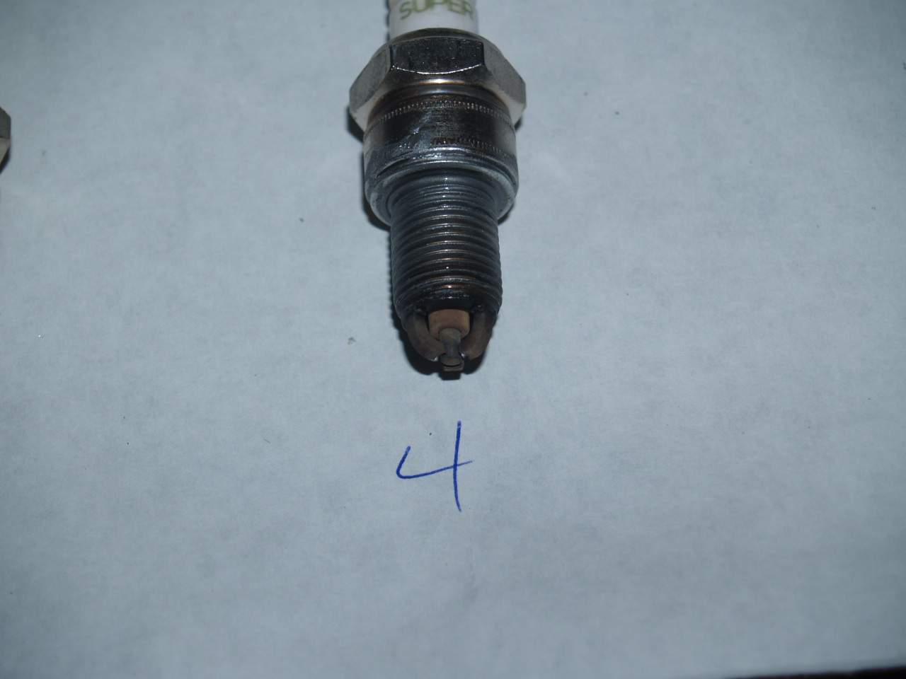

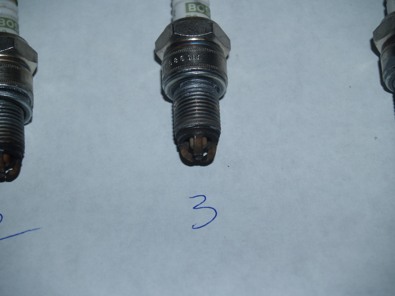

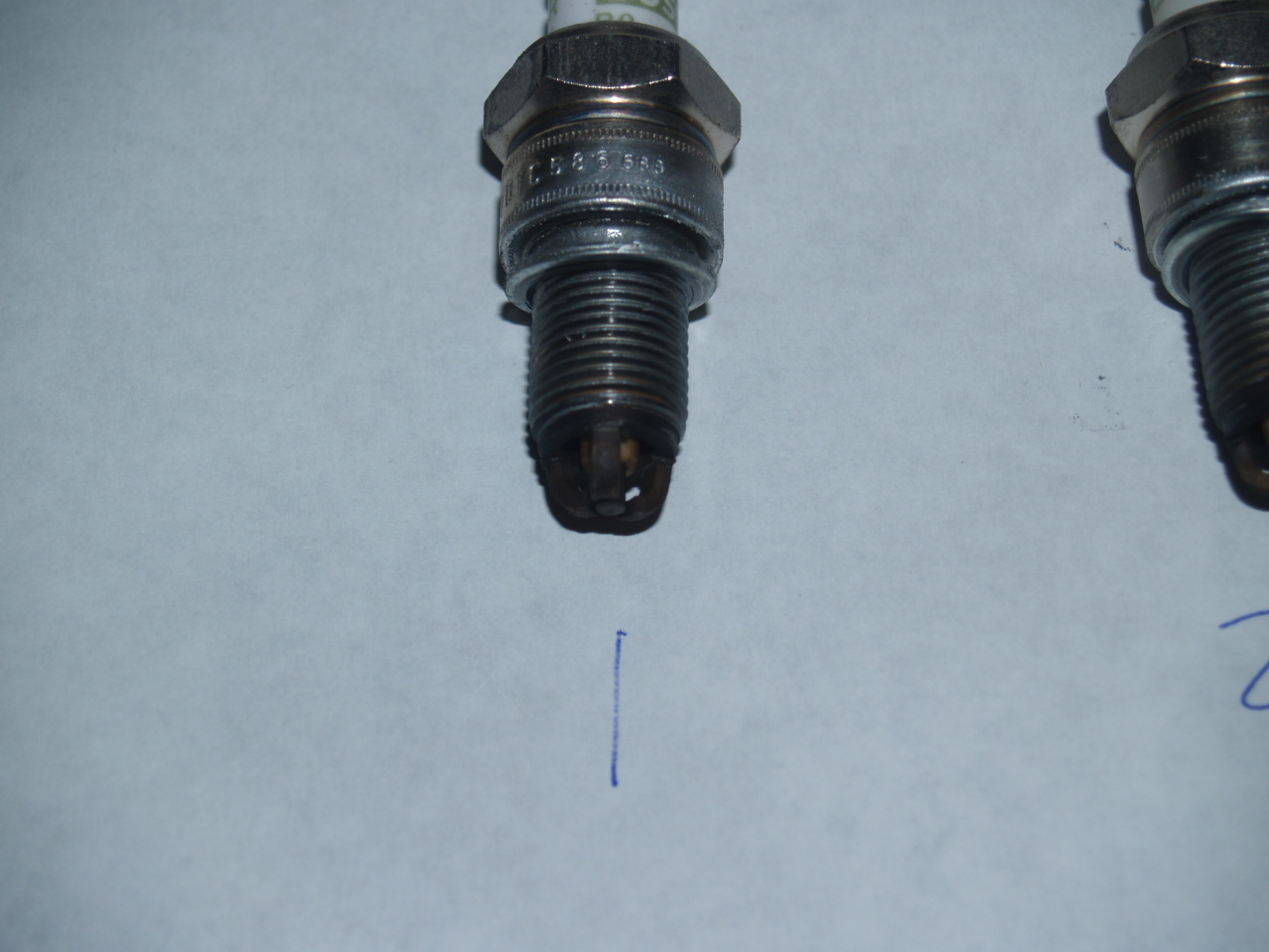

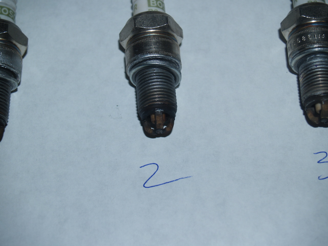

Here are some pics of the spark plugs that were in the car for a little bit. there are 4 pics.

#2

#3

#4

the problem with plug tuning is they kinda tell an average.
unfortunately by the time you idle down and pull into the garage or pits to pull them, that average includes a lot of different throttle positions and coasting.
If you were to do a full power run and then turn the ignition off on the track or road, and let off the throttle and coast to the side of the track and pull the plugs on the actual track, then the plugs may tell you wide open throttle.
but you are not going to find a situation where the plugs can tell you throttle tip in
only a wide band is going to be able to show you that.
set your floats and then use other's experience to jet your carbs and you will be close without a wide band. Or get on a dyno to go from there.
