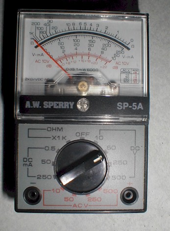

do i have the dial on the right setting?
do i look at the most middle row of numvers - 10,20,30,40,50 ??
ClayPerrine
post Oct 4 2007, 09:58 AM
Posts: 16,445
Joined: 11-September 03
From: Hurst, TX.
Member No.: 1,143
Yes... you have it set right. Now you have to figure out which scale to use.

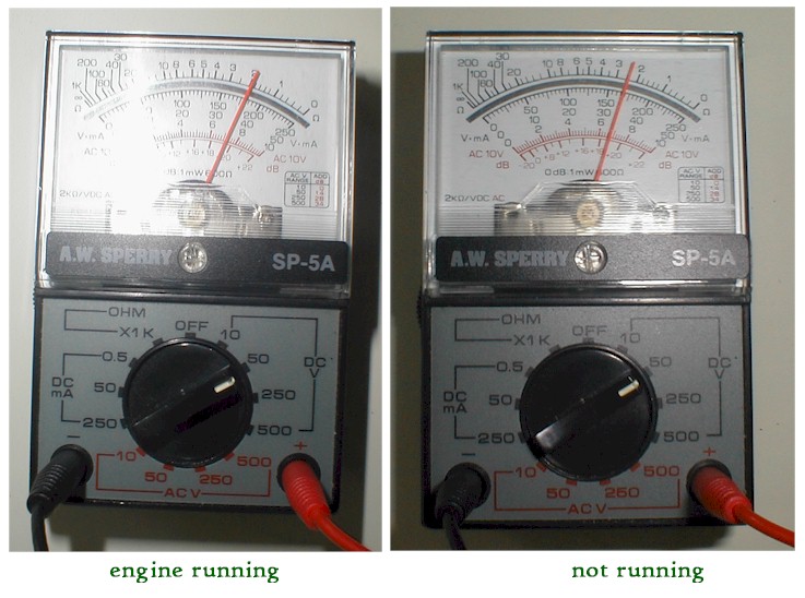

my car is 1975 914 with 1973 2.0 engine
here is a pic of the tester with engine running - and not running - jim
i get similar reading not running as i do with my subaru impreza.

If I am reading the scales correctly ... your battery voltage (not running) is 33 VDC and running it is 37 VDC .... so the alt is working.
However, I don't think your meter is set correctly. Does the indicator needle set on "0" when not connected to anything? If not, you have to zero the needle with the screw on the front face of the multimeter. It should read in the range of 12 VDC to 14 VDC (on the 50 scale) (assuming the voltage regulator is working correctly).
EDIT: If you zeroed the meter using the right hand zero you need to zero the meter using the left hand zero. Reading from right to left the readings would be 17 VDC at rest and 14 VDC running, which would indicate the alternator is not functioning.
To many problems here... the meter appears to be reading incorrectly ... I need an aspirin.
