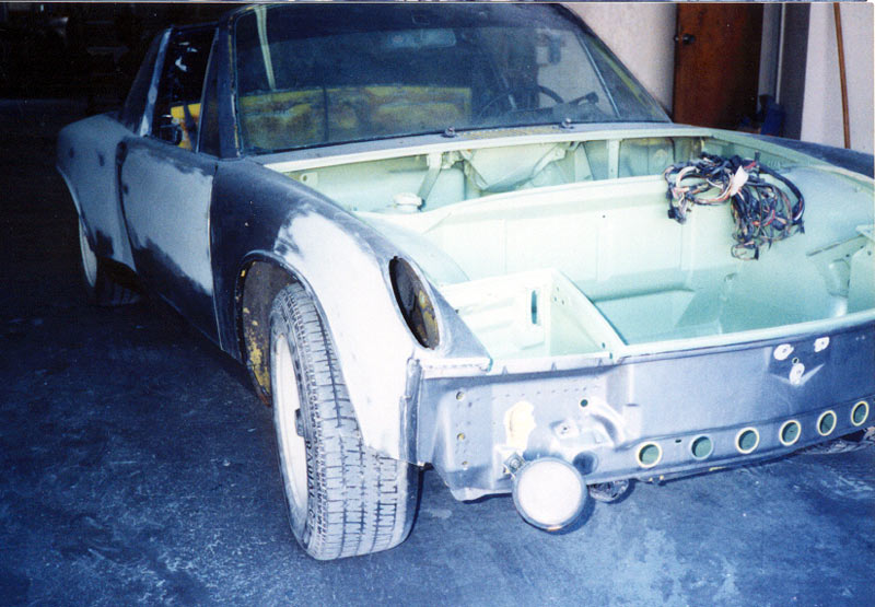

Mine was soda stripped over 6 years ago - no lingering effects or residue (that I can see)

Nice Mt914, Realy Nice. (IMG:style_emoticons/default/aktion035.gif)
