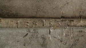

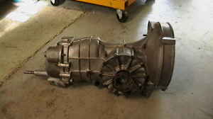

jimkelly what trans is this? Nov 4 2007, 06:13 PM
PRS914-6 I'm not positive but it looks like an old 901 ... Nov 4 2007, 07:02 PM
McMark :agree: Nov 4 2007, 07:12 PM
jimkelly the owner says it is a 901 but i thought the 914 t... Nov 4 2007, 07:23 PM
davep your model is just a casting part #.
There should ... Nov 4 2007, 07:45 PM
brant the 914 trans is technically a type 914 trans...
(... Nov 4 2007, 07:45 PM
914Sixer Early 911,912. 65-68. You need the Type preceedi... Nov 4 2007, 07:59 PM
Cap'n Krusty Chill cast aluminum case, Type901, used from 1964-... Nov 4 2007, 08:51 PM
Richard Casto
Chill cast aluminum case, Type901, used from 1964... Nov 5 2007, 02:42 PM
