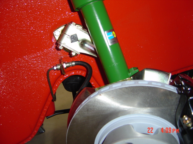

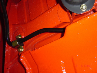

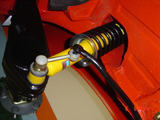

This 6 didn't come from the factory with sway-bars, but I always wanted them. I welded in these cool mounts for the brackets before paint. They look like factory, at least to me...

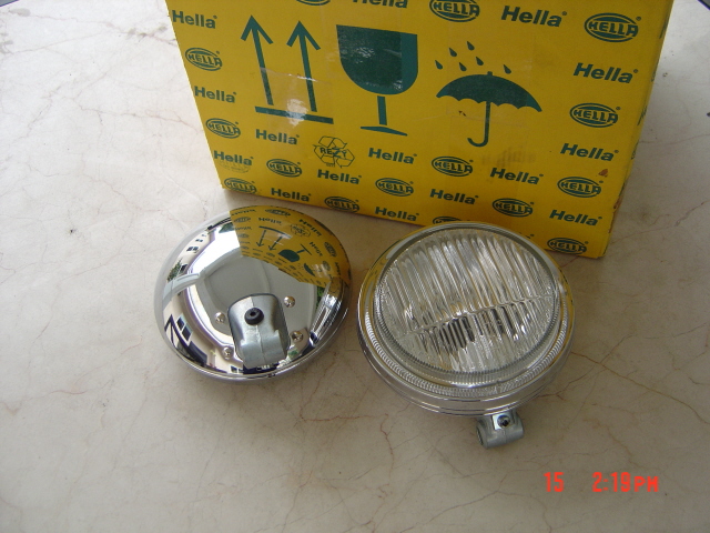

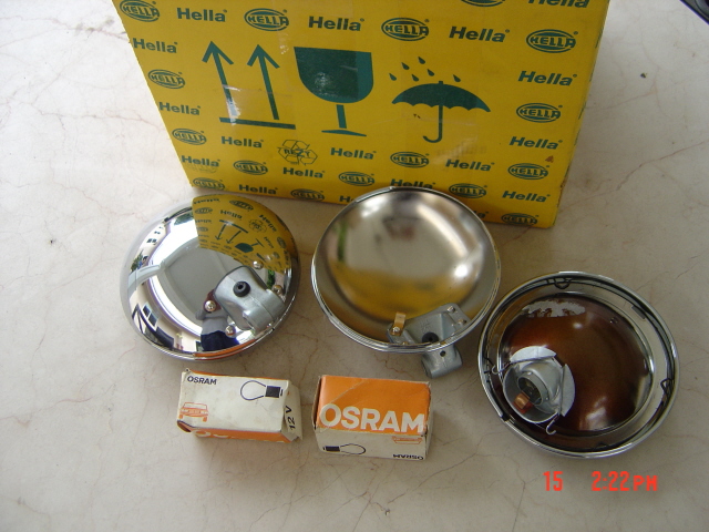

These Fog Lights are the ones usually used on the early 911's with the thru-the-grill set-up. I know the 914 units are black, but I think these'll brighten up the front bumper area along with new chrome Fog Light grills.

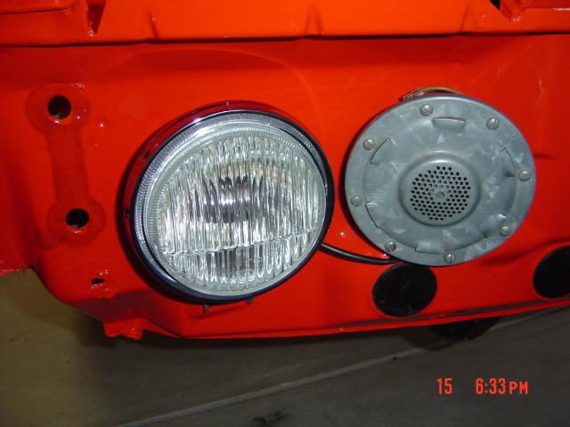

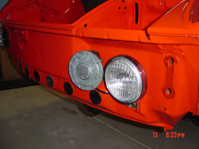

These are the horns that came with the car. I assume they're the original's. I cleaned em with steel wool and degreaser.
The fog's are mounted too.

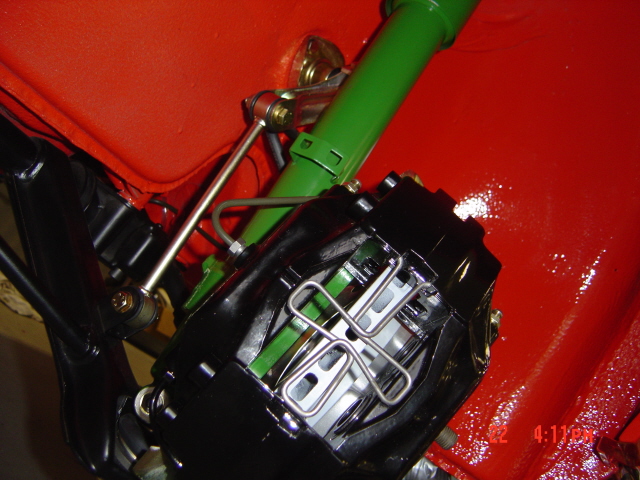

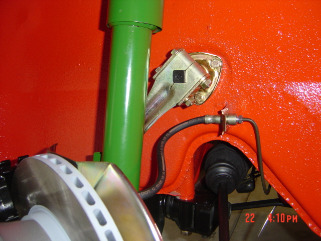

Got the front stabilizer installed today. New rubber, repainted 15mm bar, old hardware replated in yellow zink.
This six was not equipped from the factory with this option. I hope it will improve handling. The Bilsteins should help too.

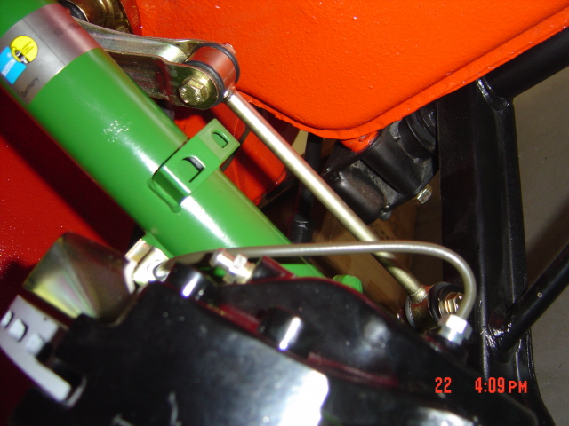

Some more pics of the Stabilizer.
I also replaced all the metal brake lines as well as the hoses.

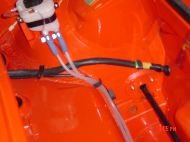

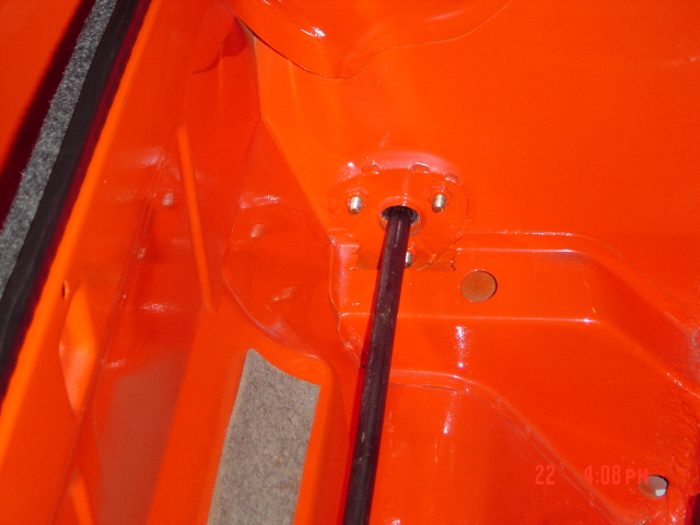

Inside pics of the Stabilizer under the gas tank.

If ever a car needed an anit-sway bar it's a 914... even a six. Good work (IMG:style_emoticons/default/smilie_pokal.gif)
(that was the "only" mod I did to mine)

I did the mod's for the rest of the hardware. BTW, same mod for the rear bar.
