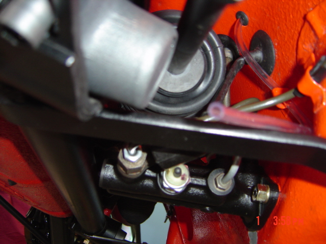

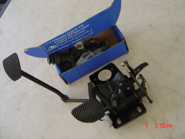

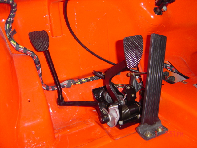

Went back in the garage to do some work. Started by installing a new 19mm master and the rebuilt pedal assembly. Also put in a new gas peddal.

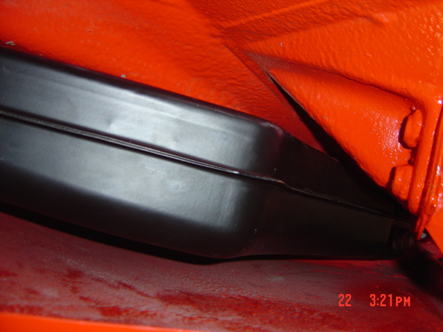

Member No.: 2,378

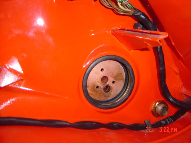

Installed the NOS oil tank with all new seals, washers, boots, hoses etc.

Member No.: 2,378
More progress on the oil tank.

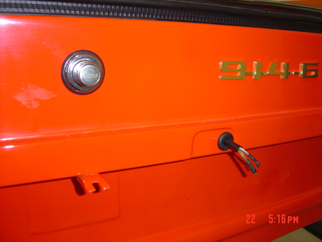

Member No.: 2,378

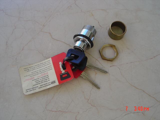

NOS rear trunk button. I had a locksmith use the internals out of the old button so I could use the original key. He made me some extra keys from NOS blanks too.

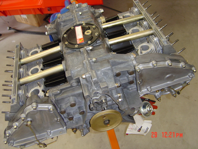

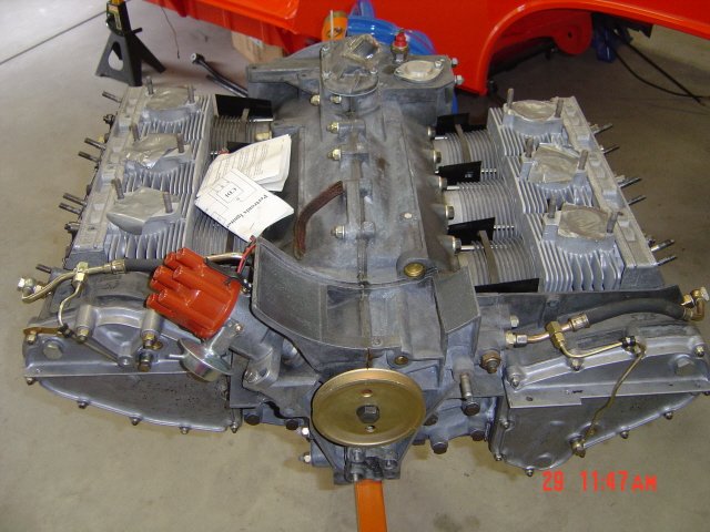

Long-block is back from a local OC engine builder. This is a '76 2.7 S engine which was true.
I decided on this build because I want a high RPM carburated Peeky engine with more HP that torque. This is a copy of the 2.7RS spec. which should make around 200HP.
Case:
All the oil plugs were removed in order to clean the pasages. The bypass was done, the squirters were replaced and a 3.0 oil pump was used. Allign-bore was done. All bearings were replaced, time certs installed and new dilivar head studs were installed. The counter-shaft gear was neplaced with new. This is a commonly overlooked, but affects the cam and ignition timing.
Crank:
All plugs removed, galley's cleaned and new plugs installed. Crank was micor polished and balanced.
Rods:
Al rods checked, balanced, and small end bushings replaced with new.
Cam Towers:
Machined to flat surface. Oil tube removed, cleaned out and replaced with new plugs.
New German billet Cam Blanks ground to "S" Spec. and hardened.
Heads:
Replaced all valves with Aasco, guides with silicone-bronz. Replaced springs, keepers, retainers. CIS injector holes were welded closed and machined since I will be running Webers. Ports were opened and polished. Air injector holes were pluged.
Cylinders:
New Mahle 8.5-1 RS type pistons and cylinders.
Chain Boxes:
New ramps and chain, and pressure-fed tensioners.
Take a look...

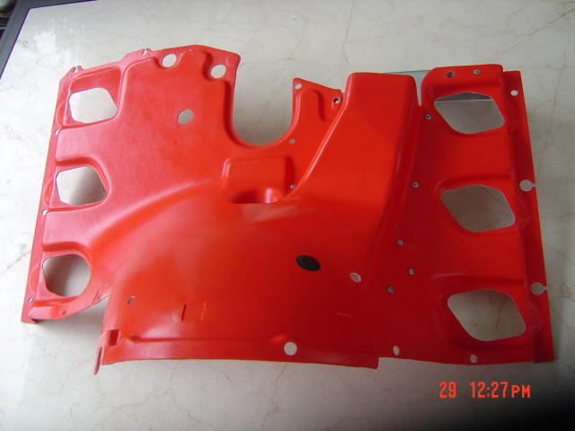

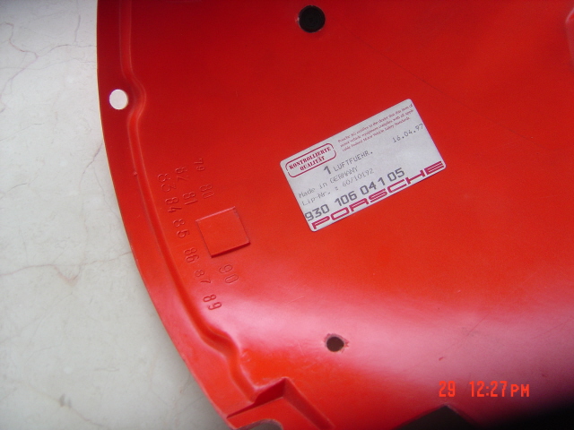

New 930 shroud will give a "S" kind look.

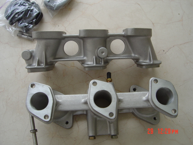

Member No.: 2,378

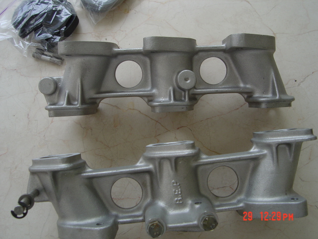

PMO Tall manifolds will math up to the large intake ports on the heads.

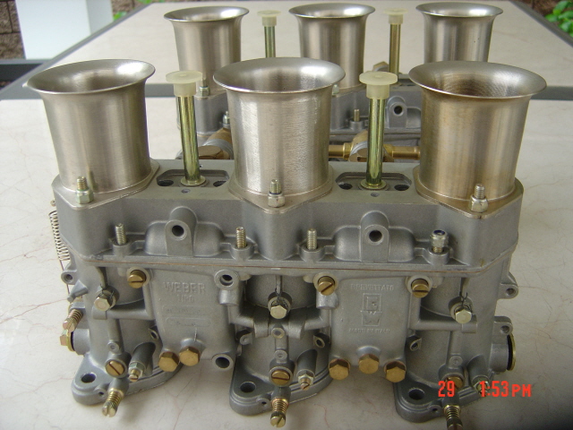

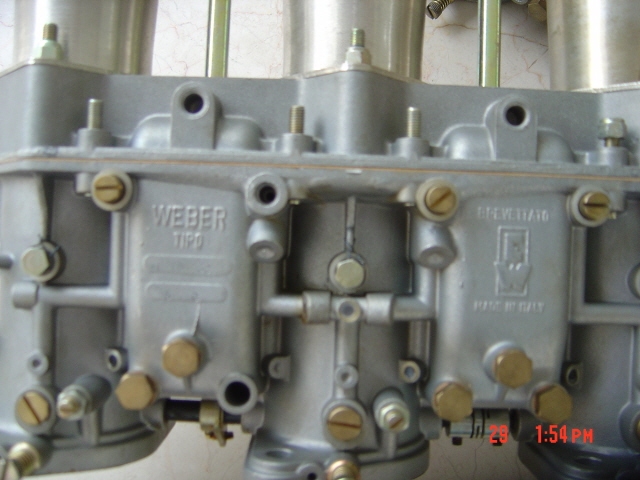

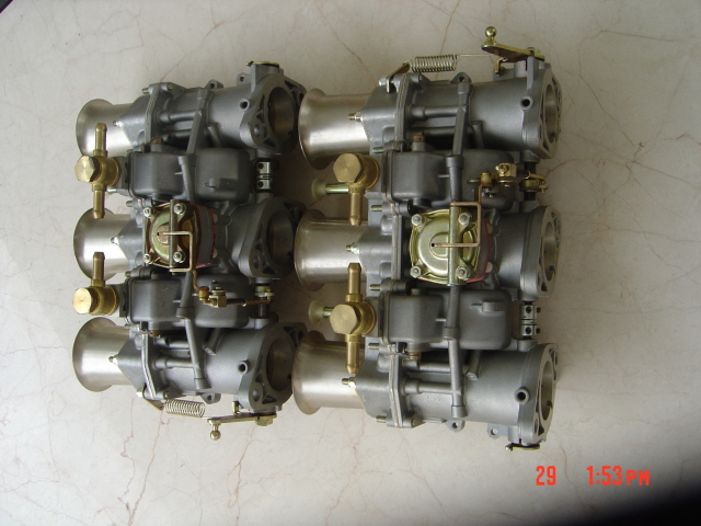

The Holy Grail. NOS Weber 40IDAC3 carbs. OMG!!

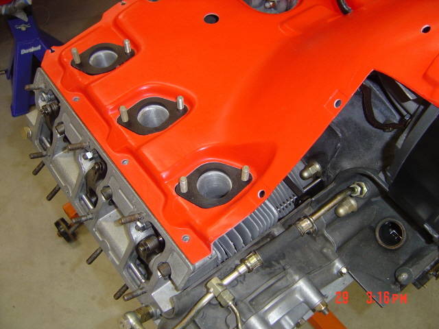

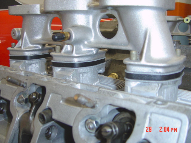

Putin' some of the stuff on...
Plastic insulators are used between the heads and the manifolds to keep the carbs cooler which helps to reduce perculation.

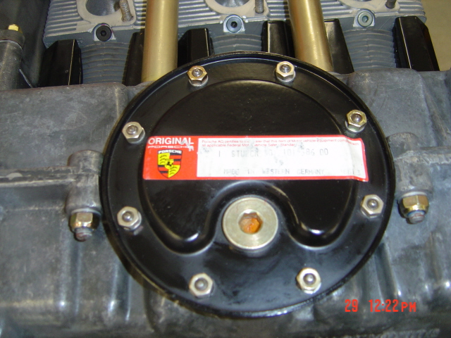

New tubes and supmp plate.

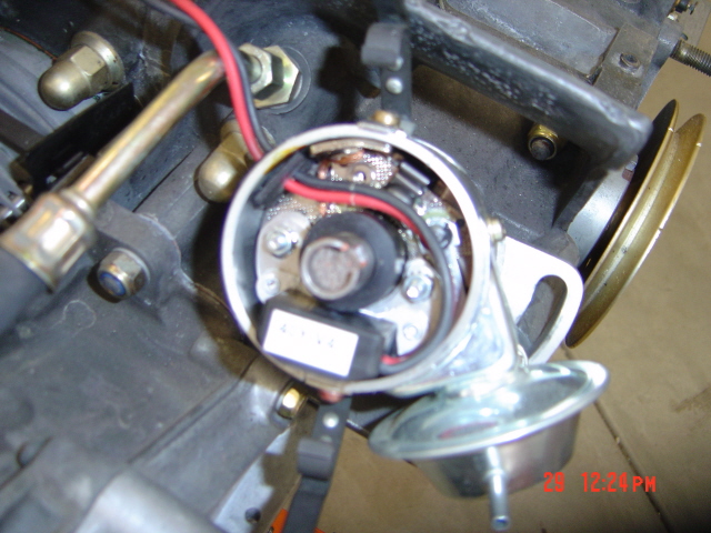

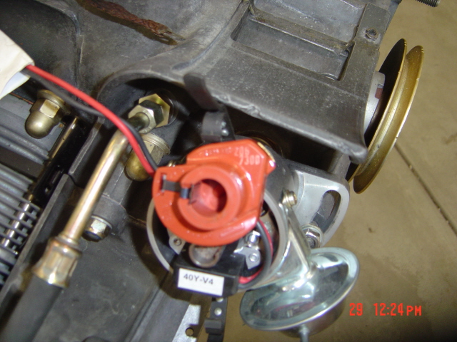

New RS Bosch distributor with new Pertronix and a 7300RPM rotor. WEEEE

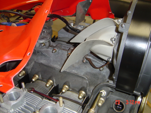

Shroud and Fan going on
