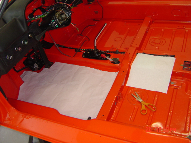

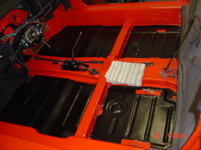

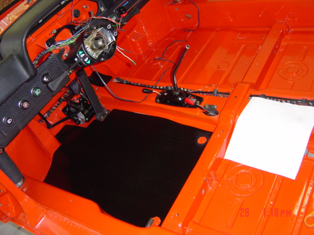

Paper patern and first piece of Sound material cut out.

Use a heat-gun and the results are awesome (at least to me). The material shrinks down to all the reliefs in the floor.

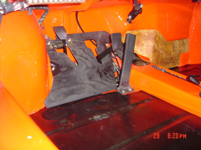

Last shot of the peddal board installed.

I asked my body shop to reccomend a sound deadening material. They said the Honda (I know rice burner) product was the best. I cut paper patterns, cut the material, and installed. This product is adhesive on the back. After it was stuck in place, I used a heat-gun. This material is like flat heat-shrink, and I think it's on for good.
No kiddin? What (and how) do they charge for that stuff? Id it by the square foot?

QUOTE(9146FAN @ Jun 28 2009, 10:21 PM) *
Be sure to cover the surface of the wheel well. That's where most of the road noise comes from. That thin piece of sheetmetal is all that's between you and the tire.

AA has the floor sound pads already cut to size.

QUOTE(Gint @ Jun 29 2009, 06:25 AM) *
QUOTE(9146FAN @ Jun 28 2009, 10:15 PM) *
The Honda product only comes in 48" square sheets. The pic I posted shows the part number. It is packaged in a flat box, not a roll. My local Honda dealer charged me $88.

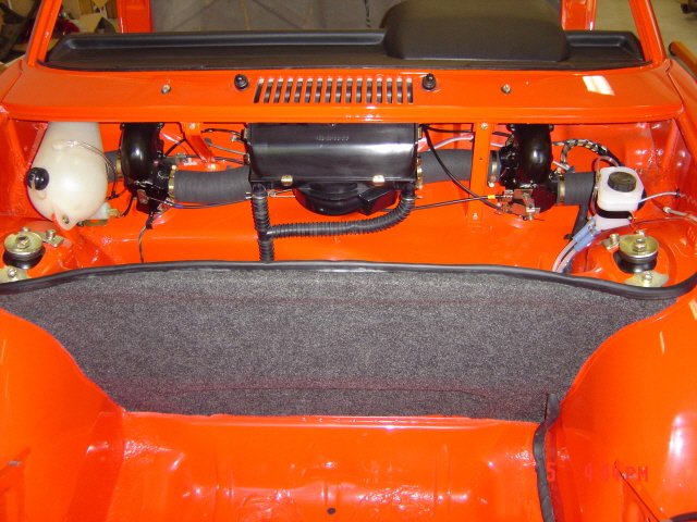

Got to work in the garage this weekend. The air-box is installed.

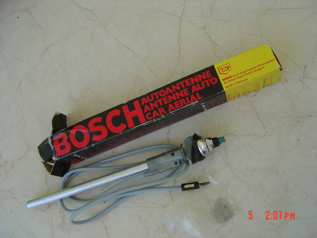

I was lucky to find a new old stock Bosch Blue Tip antenna for 914 on ebay (but I'm sure these antenna's were used for many other models too). Even came with the two keys.

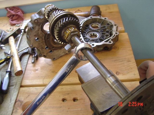

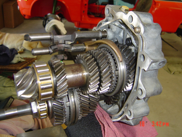

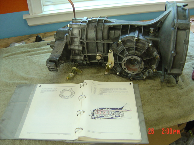

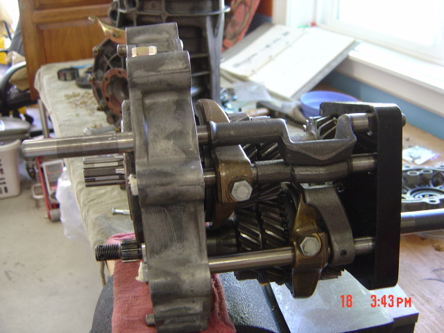

Started to repl internals on the original 914/6 transaxle. Repl all front and rear bearings, side bearings, syncros, and of course converted to side-shifter. I saved the old shifter, linkage, internal selectors and rear cover.

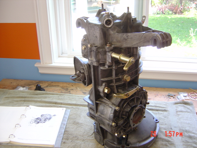

Big wrench is a must.
Back together.

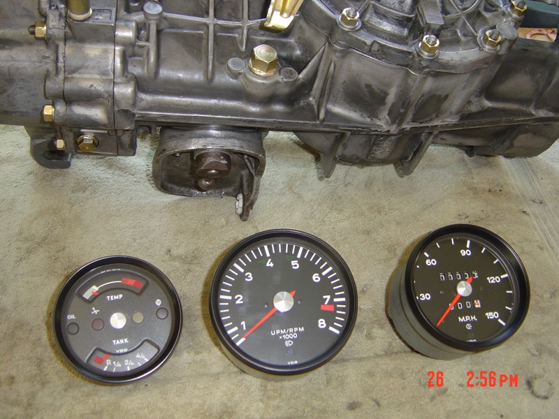

another pic of finished transaxle.

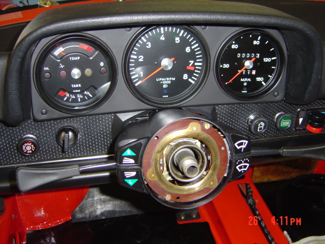

I received the restored gauges from North Hollywood Speedometer; their work is beautiful. The combo gauge is original, the speedo is new 914, and the tach is '70 911E (I asked NHS to move the redline to 7200 to match the Distributor). I'll keep the original 914/6 gauges.
9146FAN
post Aug 2 2009, 05:05 PM
Post #175
Posts: 294
Joined: 20-July 04
From: ROSSMOOR, CA
Member No.: 2,378
Gauges installed.
