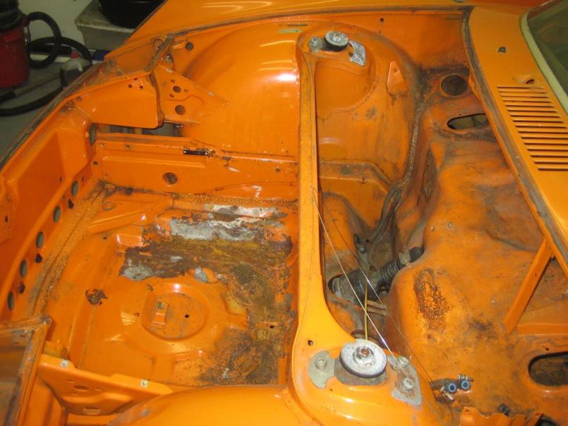

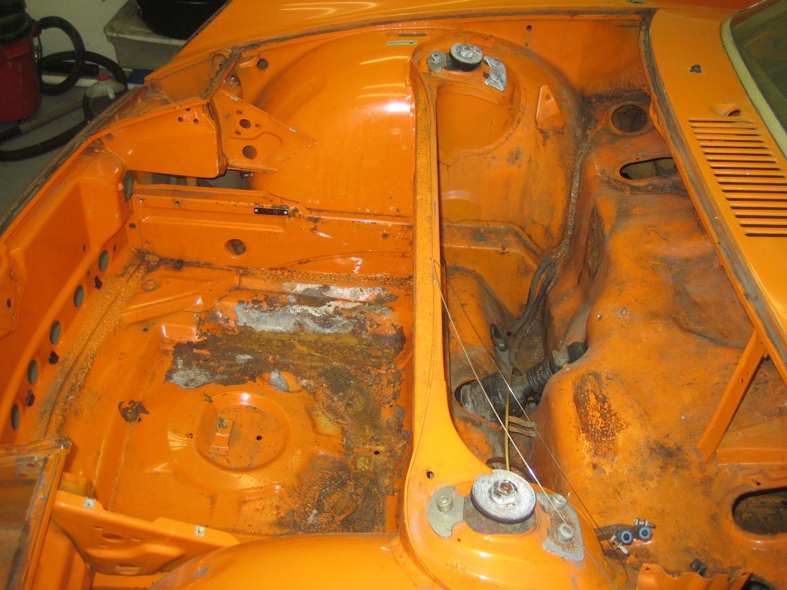

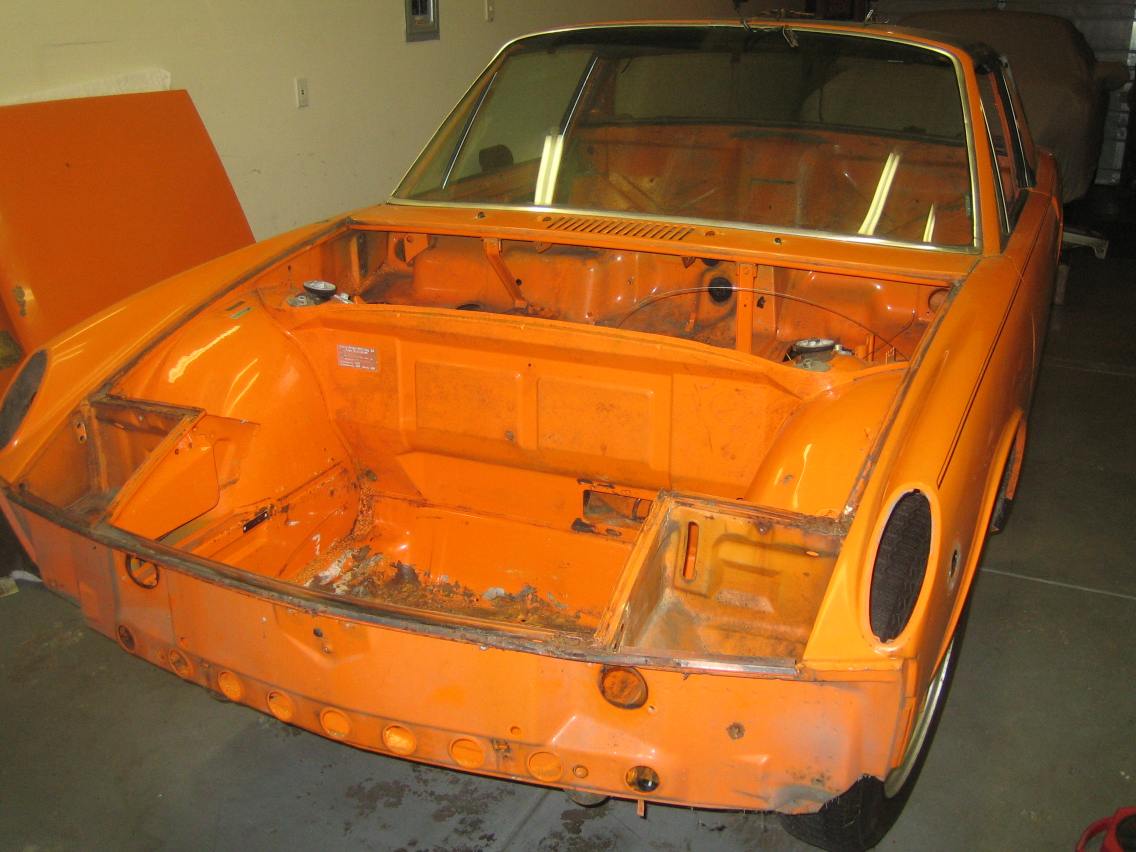

Anyway back to 914 subject matter, the good news is I have not found too many issues which is a relief and I can start to order parts and make some investment in tools. It is a perfect time of year for indoor projects as it is below freezing all the time now and skiing does not start here till after xmas.

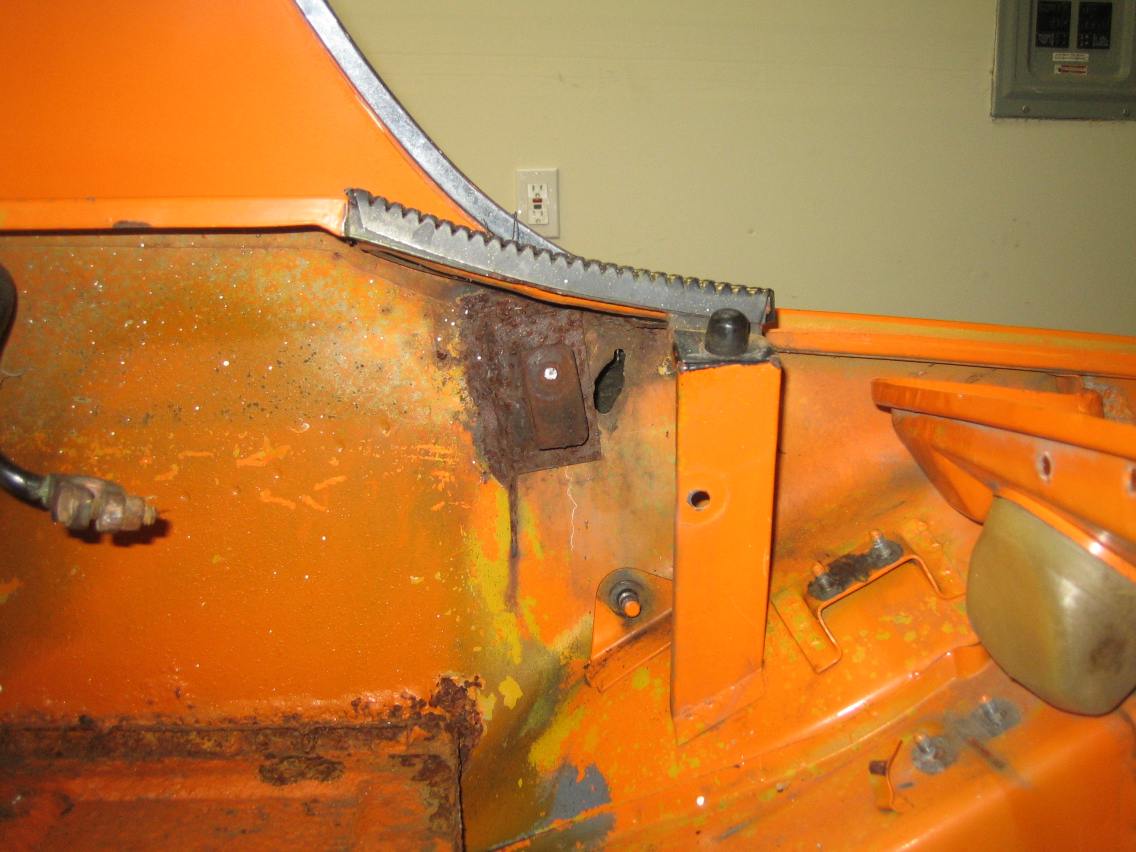

Surface rust and dirt in the front trunk but that is about it, will need to repiar a couple of areas around the hood seal.
Chris

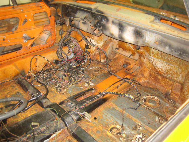

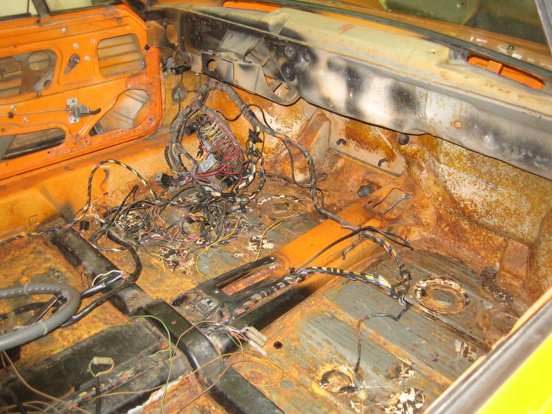

Interior needs a bit more work, car was in Seattle for some time in its life so water had found its way into the interior I guess. Rear pans will need patching, when I clean the area up will see how much good metal there is, right now just a couple of pin holes.
Chris

Some more surface rust around the pedals but everything else seems solid.

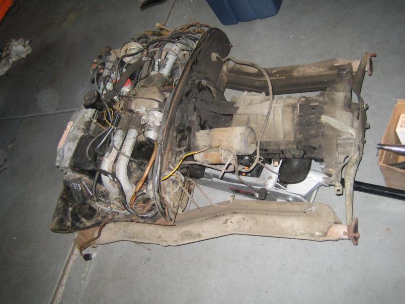

I decided to remove the engine today, I was hoping for help but in the end decided to just do it myself. Could have done with another jack though, the universal joint on the gear shifter linkage could not be disassembled as the grub screw had been rounded by a PO. With the engine bar removed there was just enough room to pull out the whole assembly.
Chris

Despite prodigous prodding with a large screwdriver I could not find any weak areas in the hell hole (IMG:style_emoticons/default/piratenanner.gif) .
Someone has done a real nice bodge on the passenger side trunk pivot point.

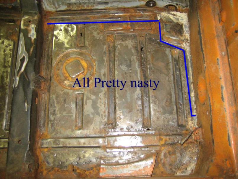

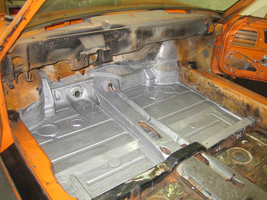

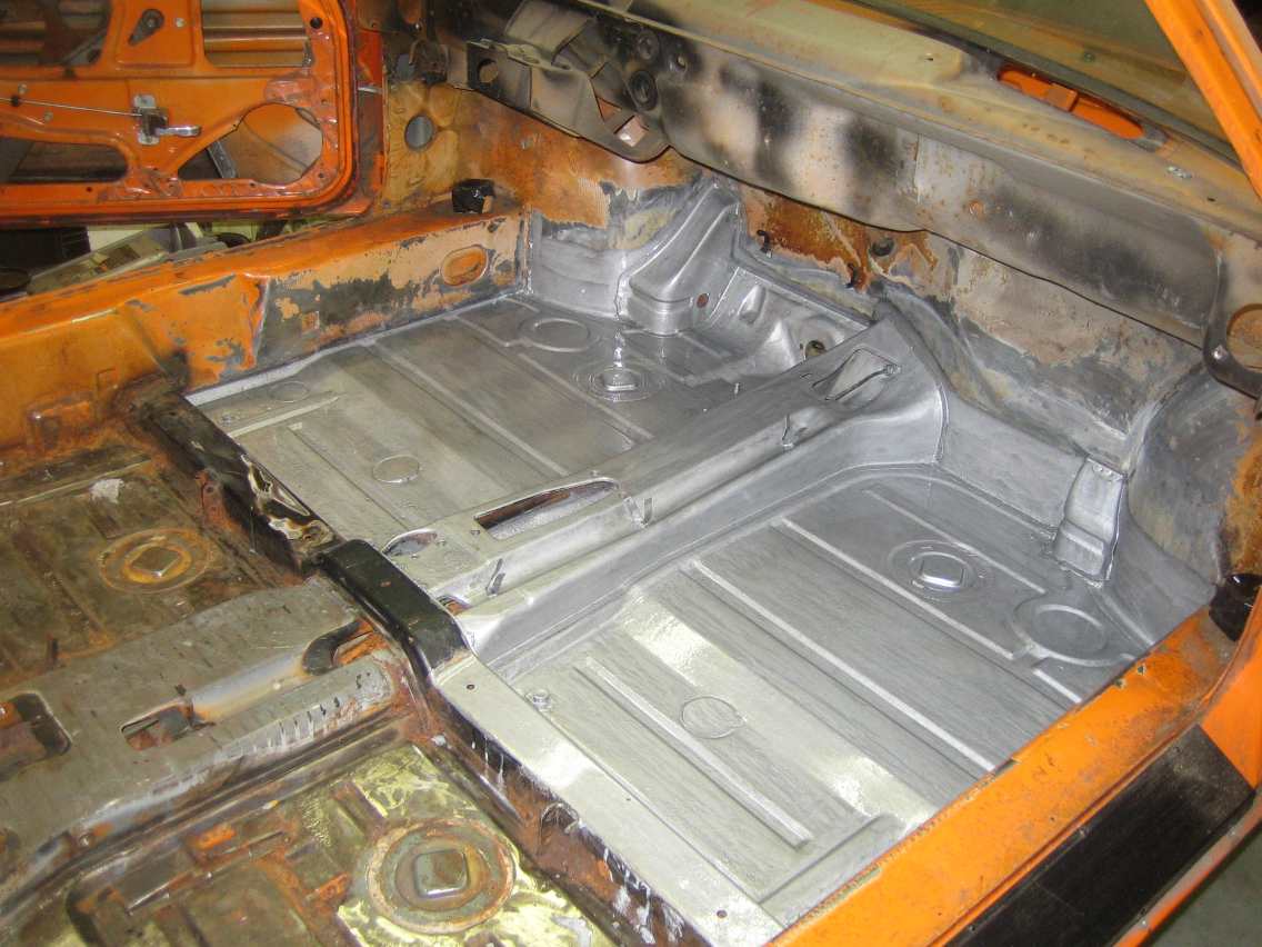

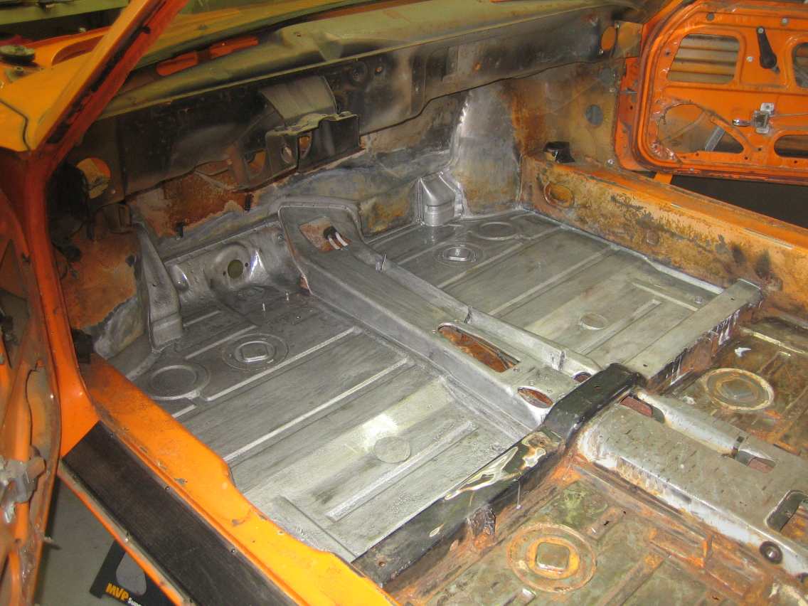

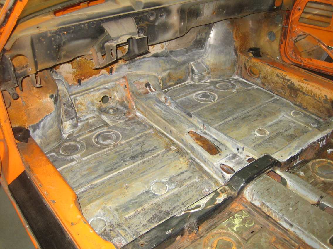

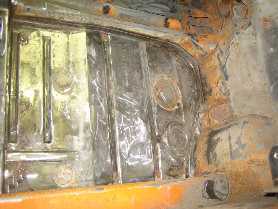

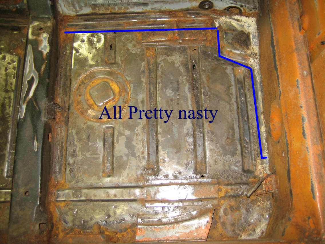

OK got a couple of hours in yesterday and today with my angle grinder and associated abrassive attachments, also made some progress in the engine bay but more on that tomorrow.

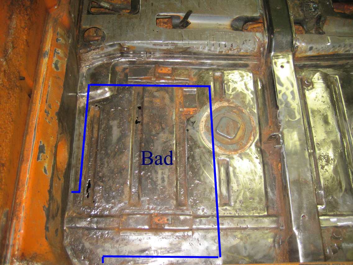

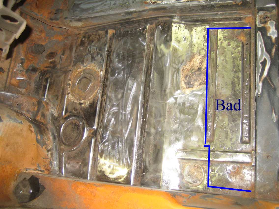

So after digging in deeper there are more holes than I thought, the metal in the rear pans is pretty thin although most of the metal around the edges is good except the passenger rear quarter.
Some of the front of the drivers side pan is not so good but the majority is OK, front of the passenger is all good. Nice and shiny.
All of this rot was from the inside, so a leaky cabin over the years was the culprit.
Should I order front and back pans? Replace all of the rear and just the bit of the drivers side front that needs it? Just wondering what some of you have done.
The ugly.

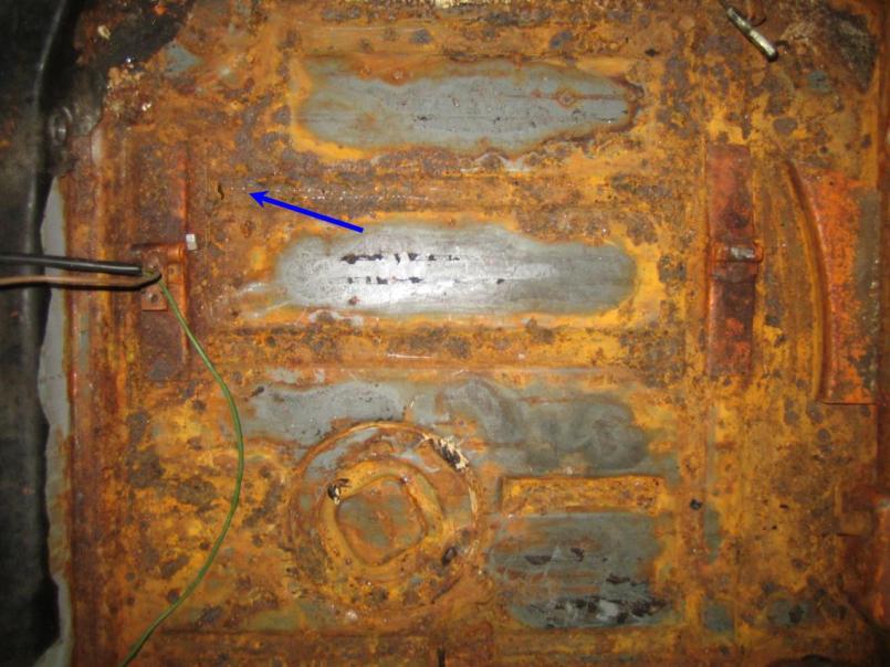

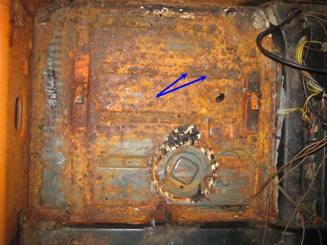

my928s4
post Dec 30 2007, 02:35 PM
Posts: 349
Joined: 18-August 07
From: Spokane, WA
Member No.: 8,018

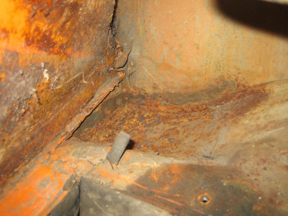

The bad
The good

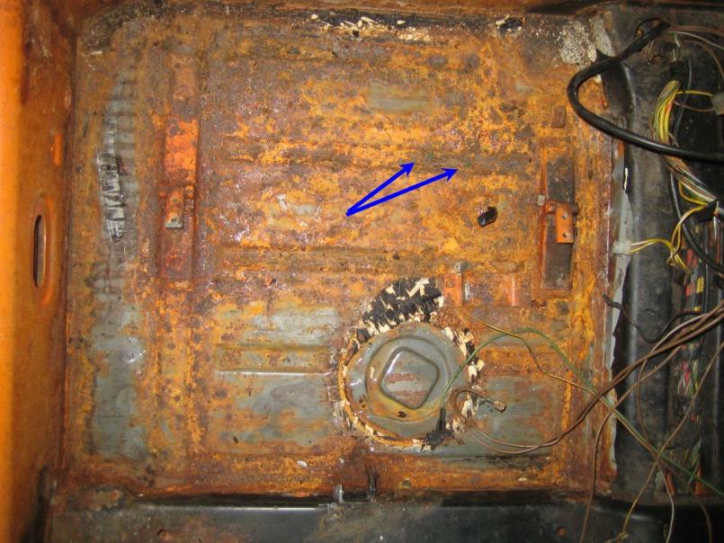

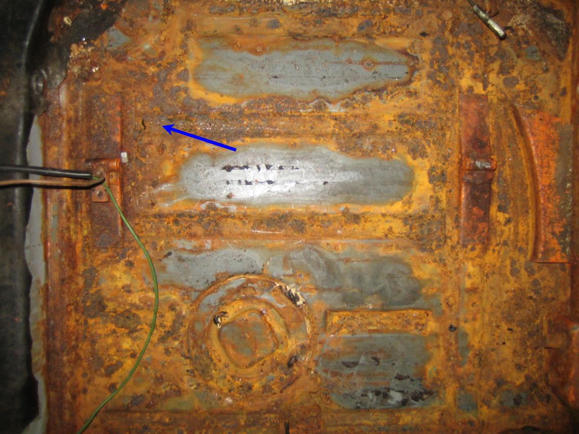

my928s4
post Dec 30 2007, 02:37 PM
Posts: 349
From: Spokane, WA
Member No.: 8,018
Messed up.
scotty b
post Dec 30 2007, 05:18 PM
rust free you say ?
Posts: 16,375
Joined: 7-January 05
From: richmond, Va.
Member No.: 3,419
rear pan section is definitely needed. IMHO that small area in front of the seat mount does not warrant a new pan section. You picture doesn't show any real damage there and I would recommend at the most making a small piece of metal to replace there instead of the cost and werk of a pan section.

Thanks Scott, appreciate the input. There are two small pin holes in the front pan and the rest of the metal in the first indent is pretty thin but as you suggest it does seem a waste to get a new front pan for that small area.

McMark
post Dec 30 2007, 10:59 PM
914 Freak!
Posts: 20,180
Joined: 13-March 03
From: Grand Rapids, MI
Member No.: 419
I would section in the rear pan, not do a complete job. Removal is a PITA and it would be better to just leave enough to butt weld the whole section.

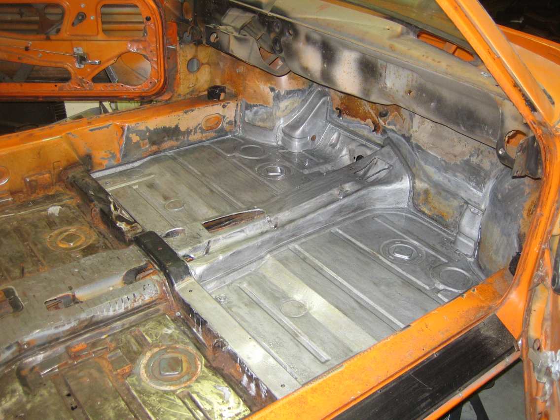

So while making progress with the grinder and wire brush is the right thing to do it can sometimes get a bit depressing finding more areas that need work so I decided to do something that looked like forward progress.
I have been reading a lot of the archived threads on rust prevention and if I had the equipment I would use epoxy primer, but I don't (yet) so I bought a POR15 starter kit and thought I would try it out. I used the Marine Clean on the front pan area followed by the Metal Ready and that was fairly painless.
Pan after Marine Clean and Metal Ready
I then followed with the first coat of POR-15 Silver.
my928s4

And then a 2nd coat, looked pretty good so I will finish of the interior with this followed by primer and color later.

What should I do with the driver side jack post? This area looks to be lacking in rust but metal fatigue seems to be an issue, any suggestions? I searched the archives and there did not seem to be an easy way to gain access to the upper portion of the jack post to remove. Maybe I am missing something obvious.
Drivers side sail panel, no doubt this looks a lot worse underneath, do I need to replace the whole part of just cut out the bit that needs replacing?

IMO the jack post should ALWAYS be cut out as they tend to rust from the inside and you can't see what is going on until it is to late. Drill out the spot welds and if all is good, treat it and re-weld the metal back in using the original spot weld holes. Floor is looking good !! (IMG:style_emoticons/default/aktion035.gif)
