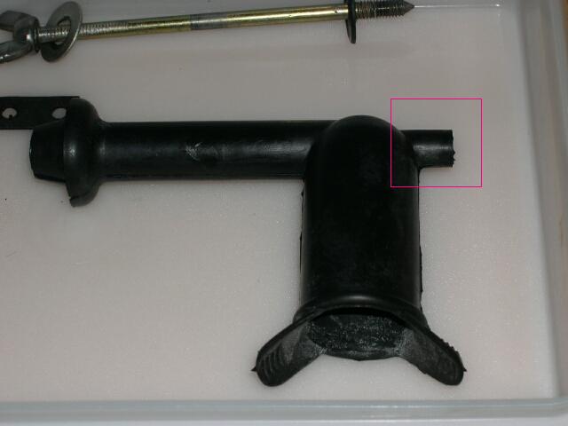

This is the factory replacement for the aforementioned. I say "replacement" because the part seems to be ROW-based, rather than US/Canada - based.
About a 1/2 inch inside the rear "tit" (see pic) is a molded in plug which must be drilled out for the side marker wires to go through.
This was made in July '06, so it isn't old shelf stock.
Current PET shows the same partno for all 914's. 914.631.217.10
