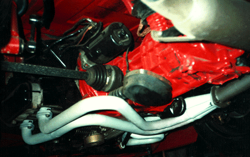

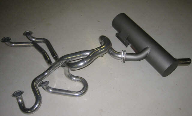

(IMG:http://www.paragon-products.com/photos/P914.4-158HM-2.jpg)
I know the Tangerine headers are great and all that but the price is out of reach for most of us teeners. I found these while seaching for a cheaper alternative. They come with stub pipes and the muffler. Hell, if you subtract the cost of the muffler system that puts their entire header at around the cost of Tangerine's stub pipes alone.
Yes, I know cost isn't everything but they do look like a nice system. Perhaps a little free market competition could benefit everyone. And Jake says any engine mods are a waste of time without a high-flow exhaust.

Looks like a Euro-Race being sold by Paragon. I have a Euro-Race. They are good, but apparently still a notch or 2 below a Tangerine.
My feeling is, if you spend the money for a kit from Jake, I would take his advice all the way. No point buying from him, if you don't believe what he preaches. If you are just trying to add a header to a stock, mostly stock, or "on a budget" motor, the Euro-Race is probably a suitable alternative.

i have those very headers on my car. got them from stable energies. i believe they are a euro-race header. they sound great and are very easy to install! The only drawback is having to re-tune the carb to adjust for them. paid around 7-800 for them

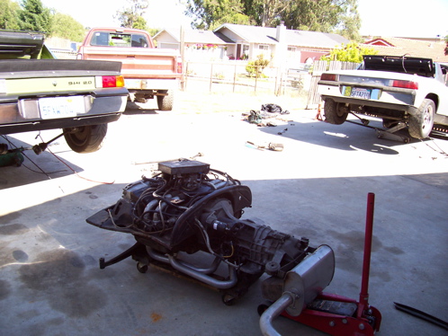

I have them on my 2056 with 9550 Raby cam and 96mm KB pistons, they work very nicely for my setup.

QUOTE(Dan (Almaden Valley) @ Jan 4 2008, 03:19 PM) *
Thanks for the photo. I think your setup is exactly what I'm shooting for. It seems to be the best price/performance combo.

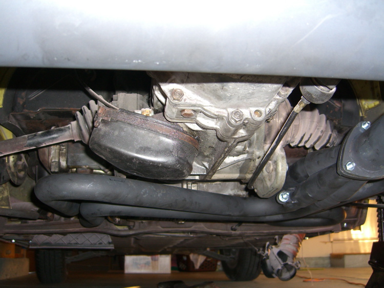

actually the Triad header for the 4 cylinder looks very much like the Eurorace header on my car. Very different than the Tangerine.
here is the pic from Triad's website.
looks pretty much like the Eurorace to me (IMG:style_emoticons/default/biggrin.gif)

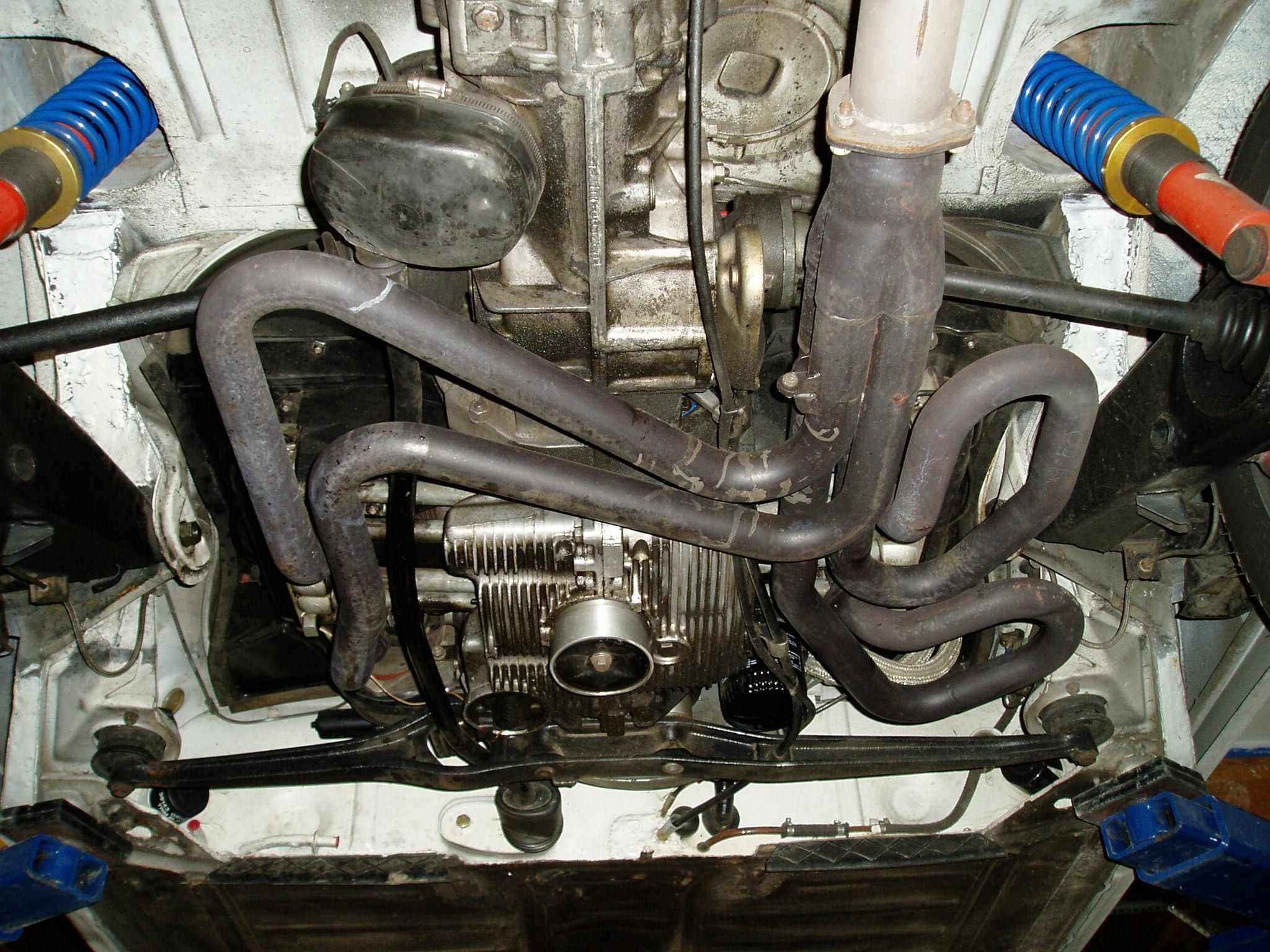

here is a pic of CFR....tangerine headers....notice 4 into 2 into 1
eurorace and triad are 4 into 1

QUOTE(Dan (Almaden Valley) @ Feb 1 2008, 10:59 PM) *
Yeah, I've never seen those. I am mistaken.... My facts were not right (IMG:style_emoticons/default/blink.gif) (IMG:style_emoticons/default/av-943.gif)
