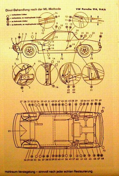

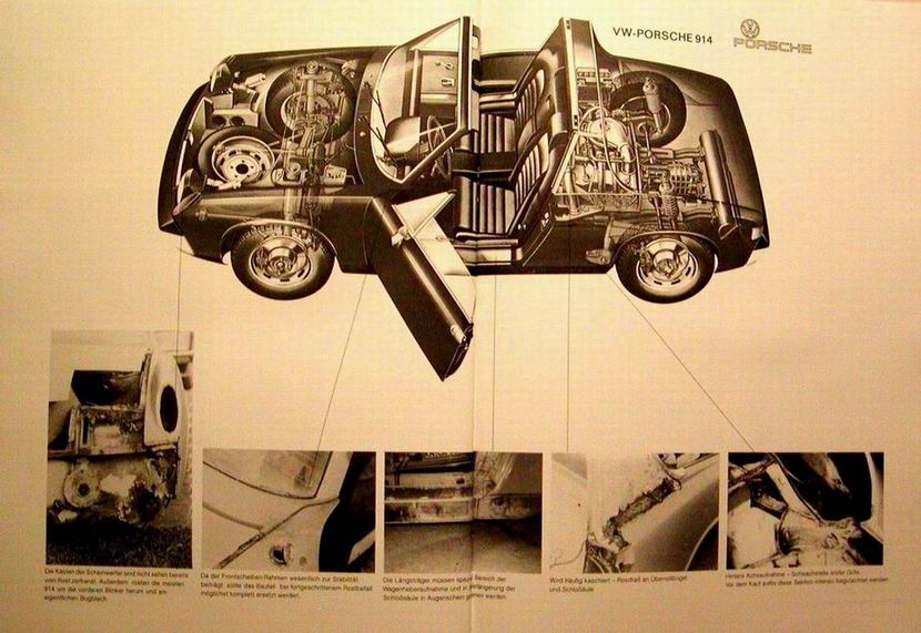

Just look here. It's everything and everywhere the factory said it would be in 1970.
