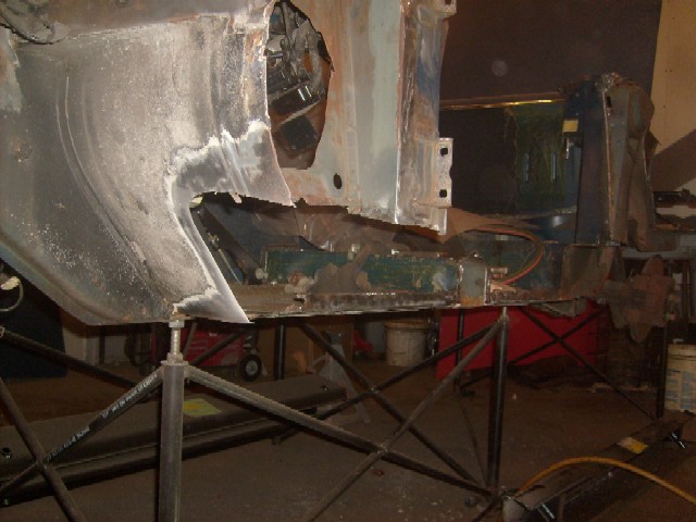

No worries Scotty! That is exactly the same section I'm doing. Here's the front floor.

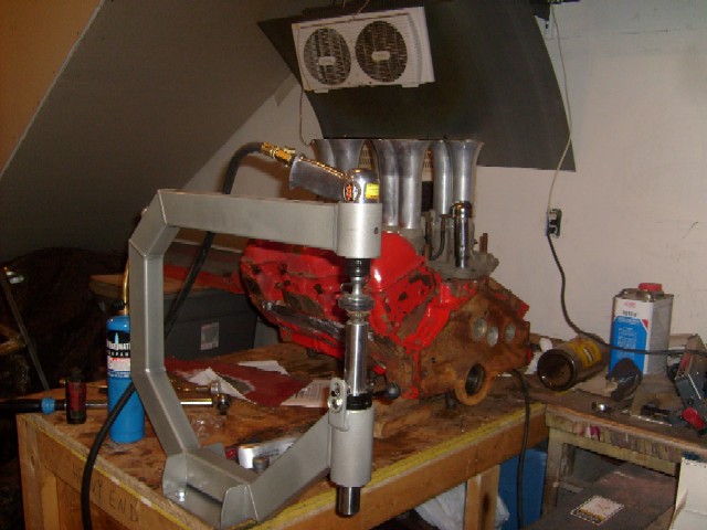

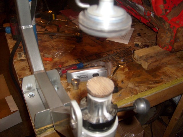

Hey Rich, Here's my hammer. I modified with this shrinking hammer. It doesn't do much but it will smooth sharp dings and edges.

Rick if you're interested in building a larger hammer there WAS ( I can't seem to find him now (IMG:style_emoticons/default/sad.gif) ) a guy on E-bay that sells a C.P. style hammer with the mounting bracket for around 750.00 I have been looking at several options and he has the best price, but doesn't state which size air unit it is. A friend of mine got one of them and it was a pretty nice unit. I am, planning on building one similar to this when I get a little more room. If you're interested, I also have the specs on building the holding bracket from a metal shaper.org member from a while back.

Yes, different tool. The planishing station is for hand work. Panels you can hold. The disk is nice when you have a panel mounted on the car. My space is limited. I also have in floor heat so I don't really have a way to secure large equipment. When I build my next shop I plan on leaving an area where I can drill anchors into the floor.
