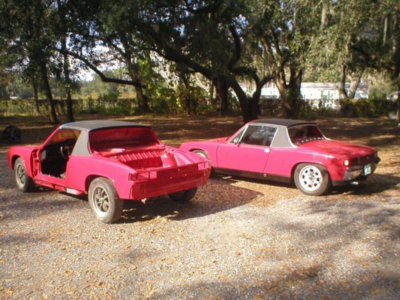

Well, since others are giving you their opinion, I'll add mine....
I'm partial to bahia red.... BTW, both are original bahia red '74 2.0
Here's a better shot of the finished bahia red driver...
Whichever color you choose, you're doing a great job....
-- Rob

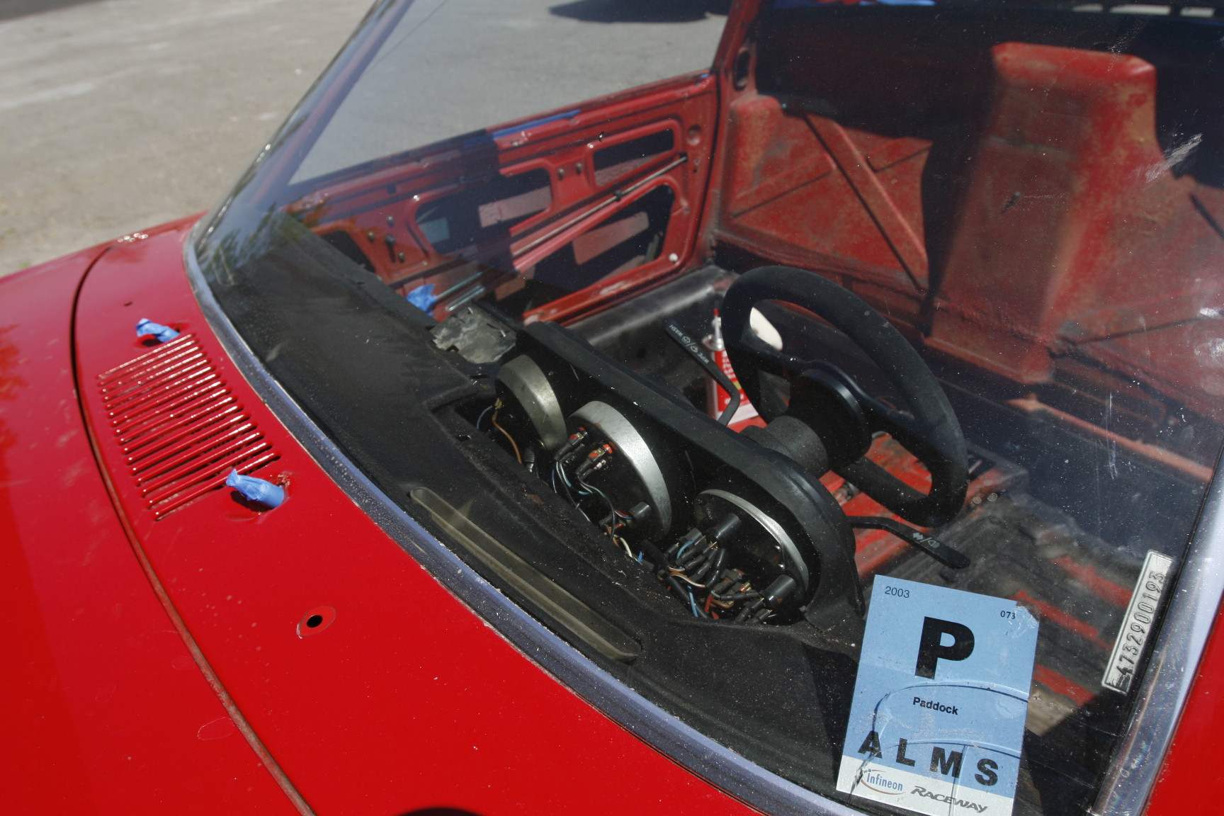

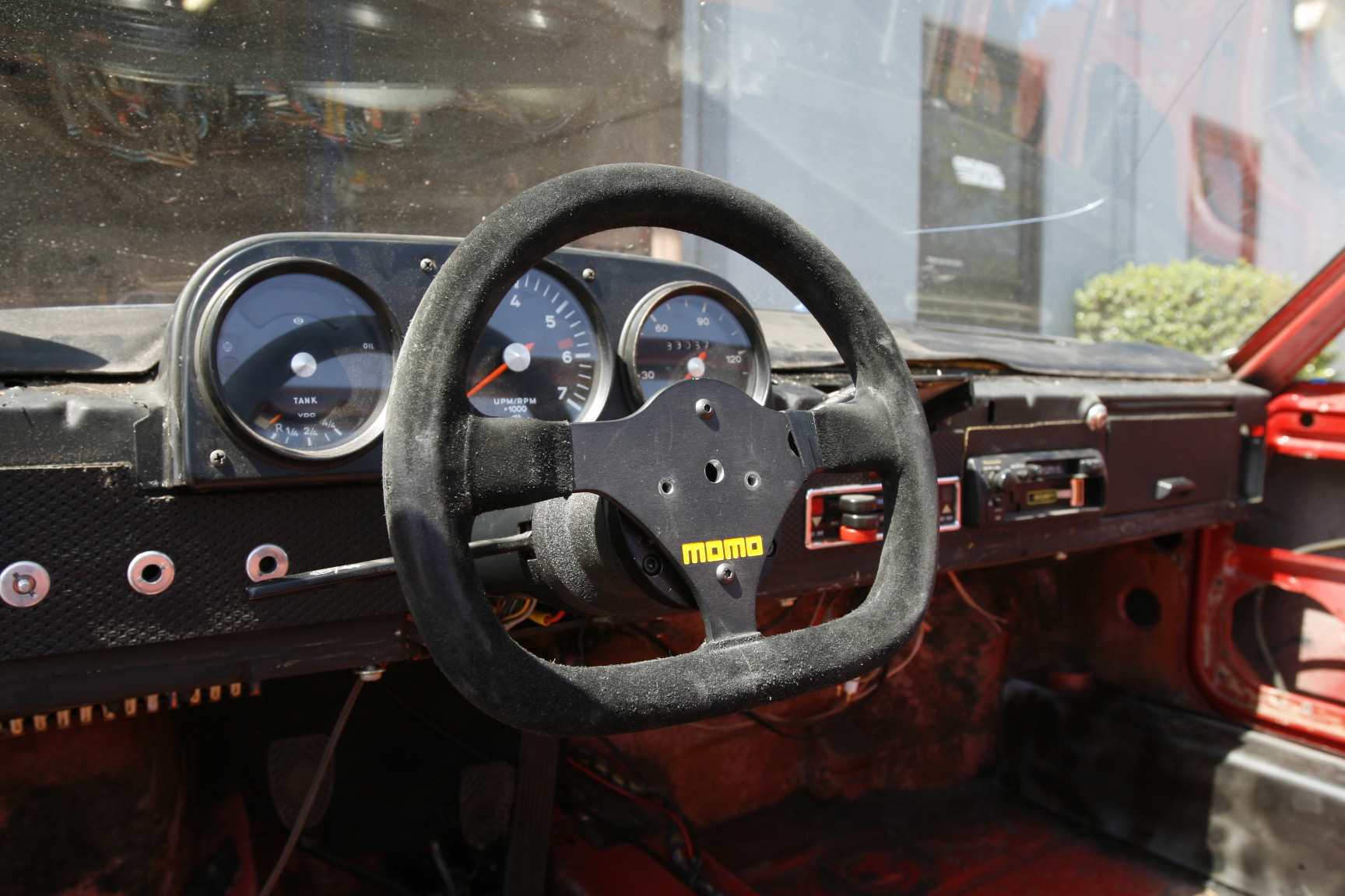

With its unusual formula car Momo wheel, complete with electrical tape to cover up the horn button hole-related failure...

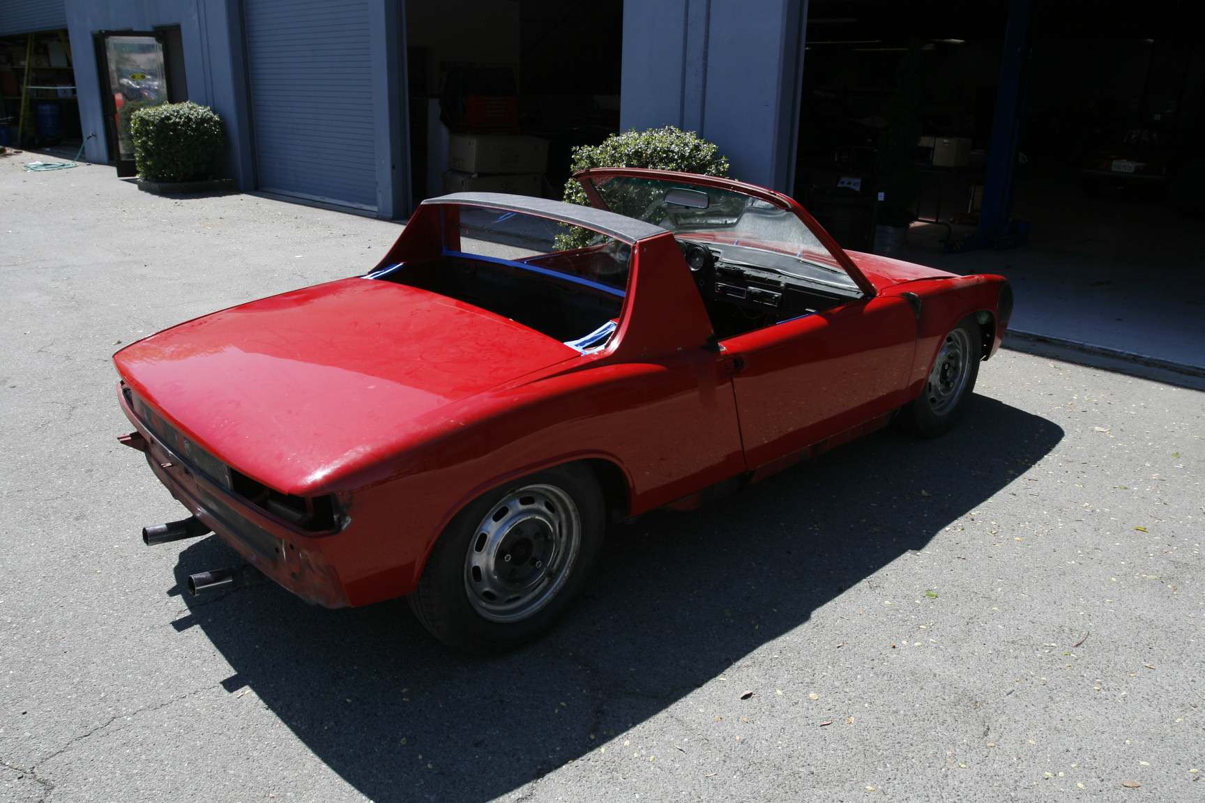

Getting close to ready for the paint shop. All that remains (this side of sanity) is windshield removal and a little adhesive removal on the firewall and front trunk bulkhead.
I may also make a deeper check of the previous rust treating (ca. 1991) at the back of the rear trunk floor. Or not. A cursory inspection showed it worked very well...

Finally, just for fun, we decided to weigh the car as is, with all mechanicals (it's a running, driving car but for its lack of a 15-pound driver's seat), both windshields, steel wheels, tar over most of the floors, the engine sound pad, the headlight assemblies less the lights themselves, and about a half tank of gas. Engine lid and headlight bits were in the back trunk.
To my surprise, it came out at 1,591 pounds.
My guess is that, with a light battery, alloy wheels, FG decklids and bumpers, Perlon carpeting, Plexi side windows on 356 GT/911R style strap adjusters but with seats, a top, all rubber seals, lights, and steel sides (fenders and doors), you might be able to build a streetable 914 in the 1650-1750-lb range.
Very tempting, but not what my car is.
pete
I'll let ya know (IMG:style_emoticons/default/biggrin.gif)
(P.S. Your steering wheel is bent)

QUOTE(Eric_Shea @ Apr 14 2008, 05:35 PM) *
So is the bottom of the one in my GTI... (IMG:style_emoticons/default/slap.gif)

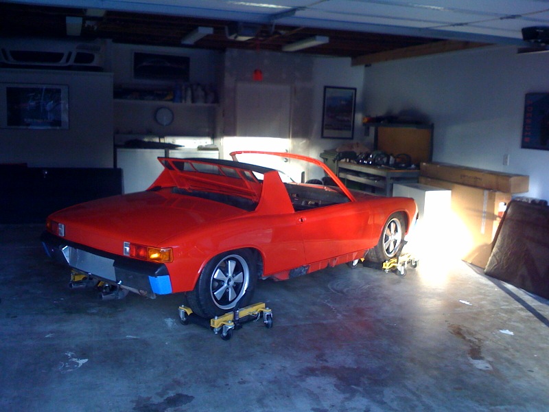

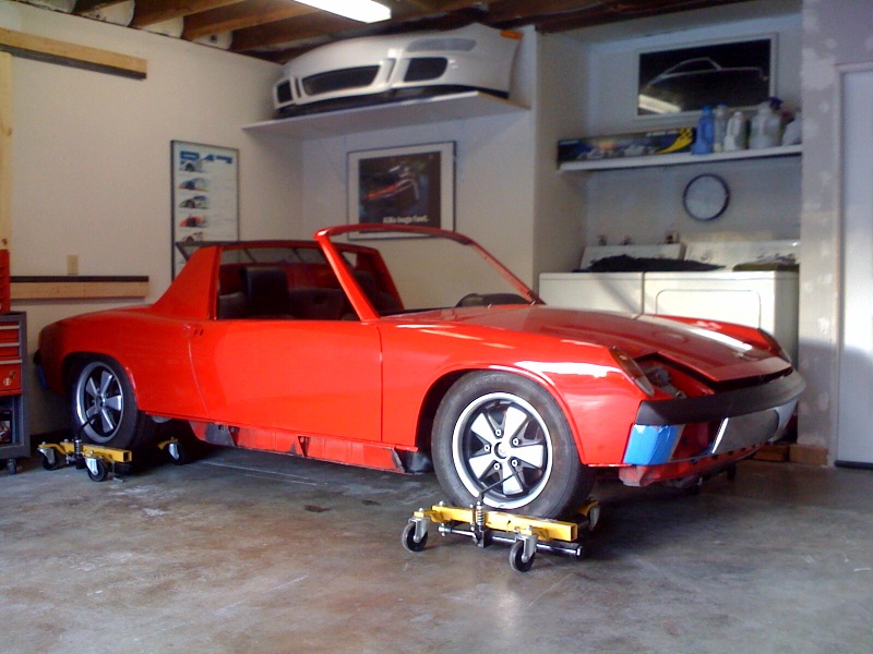

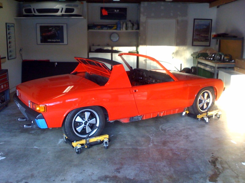

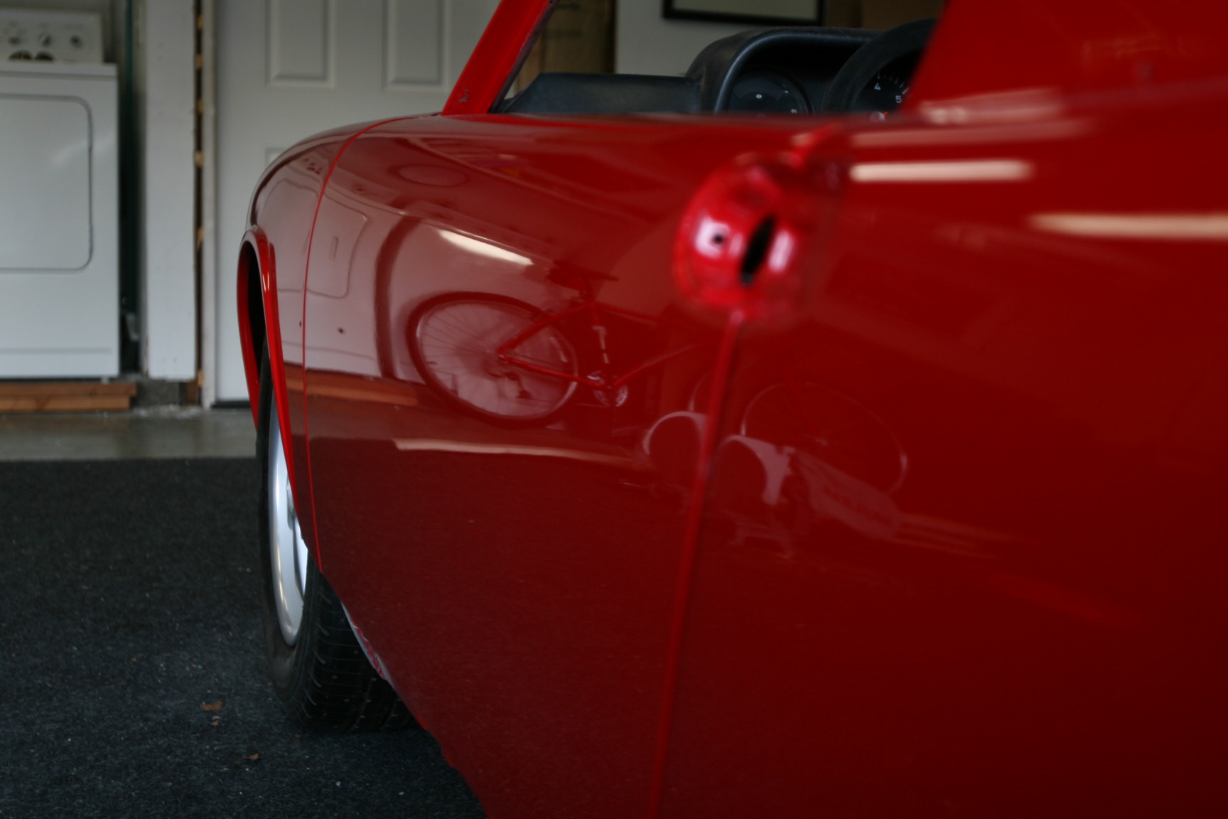

Well, many months later, my car has returned from paint. I have to say that while it took far longer than I had hoped or planned, I am thrilled with the results.

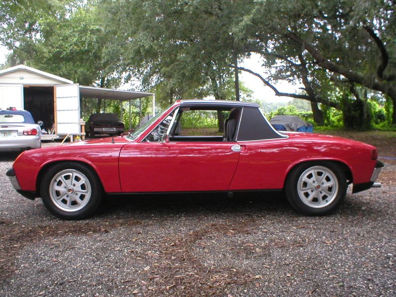

horizontally-opposed
post Apr 1 2009, 04:12 PM
Post #140
Posts: 3,456
Joined: 12-May 04
From: San Francisco
Member No.: 2,058
straighter than I've ever had it, and I've had it 20 years now...
