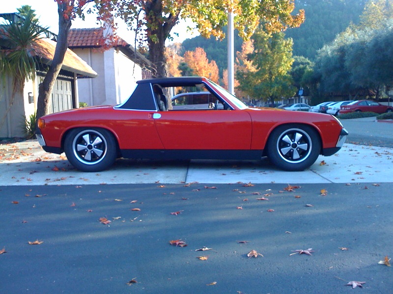

First time out in daylight in a long time...

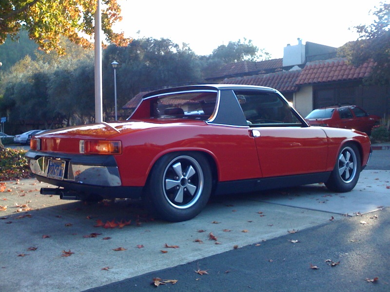

Hmm, trying to figure out center caps vs. no center caps... and what kind of lugs...?
Also, think I am going to go back to the LE spoiler...

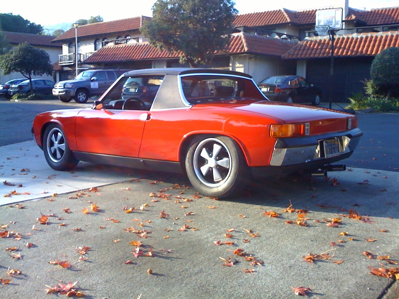

Kinda likin' the no caps thing...

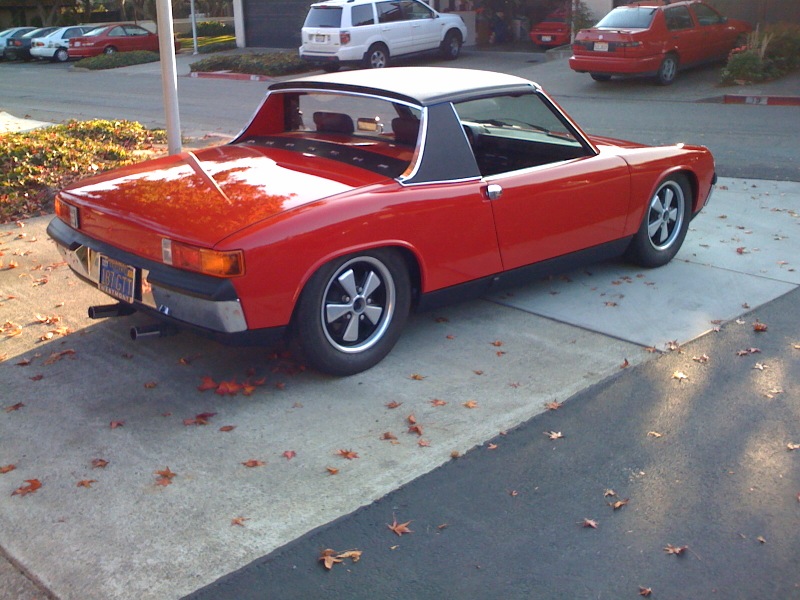

This just makes me want to head out for a drive. A long drive. Away from everything. Alas, much to do...

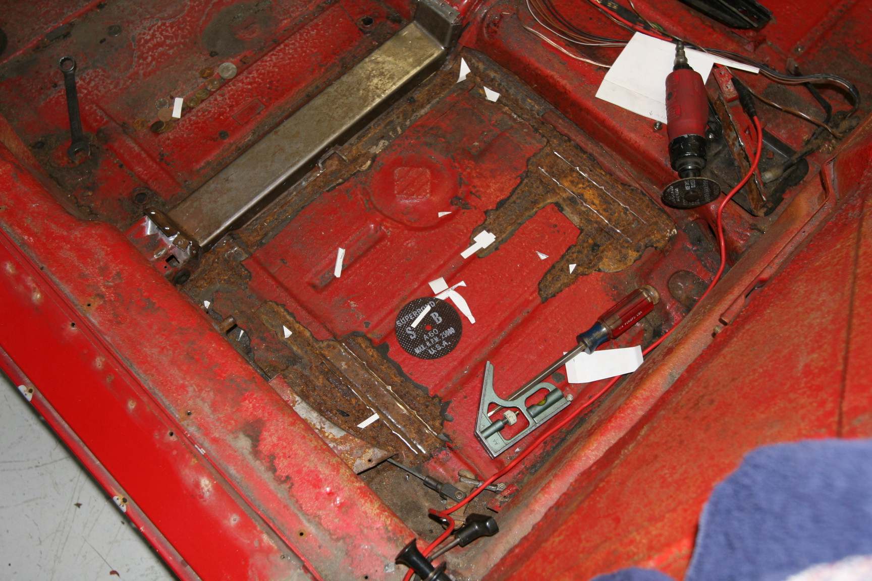

QUOTE(McMark @ Apr 14 2010, 09:44 AM) *
I'm actually a little unclear on the seat mod. At least with respect to how the seat mounts. It looks like you got rid of the hinges as well. So if I'm seeing it right, you lose up/down adjustment, but retain forward/backward adjustment.
Glad to see it's back on the road, Pete. I can't believe it's been a year! That means mine's been off for more than a couple... (IMG:style_emoticons/default/yikes.gif)
You've got it.
There is no more "height" adjust (which I really found to be more of a seatback angle and upper thigh support adjustment, FWIW), but the seat still slides back and forth on the stock gear. Essentially, John liberated the rails from the stock setup, then got rid of the hinges, then welded eight blind-nuts in where appropriate, and then I bolted the liberated lower rails back in, then slid the seats back on. The fore-aft works just fine — though doing all this with 911 sliders would be even slicker. I'd want to make sure they don't add height, though. For me, every mm matters.
Next time I've got the seats out, I'll try to take some more photos of the setup with the rails in place.
pete

Can you take a pic of the seat rail bolted in without the seat in place?
