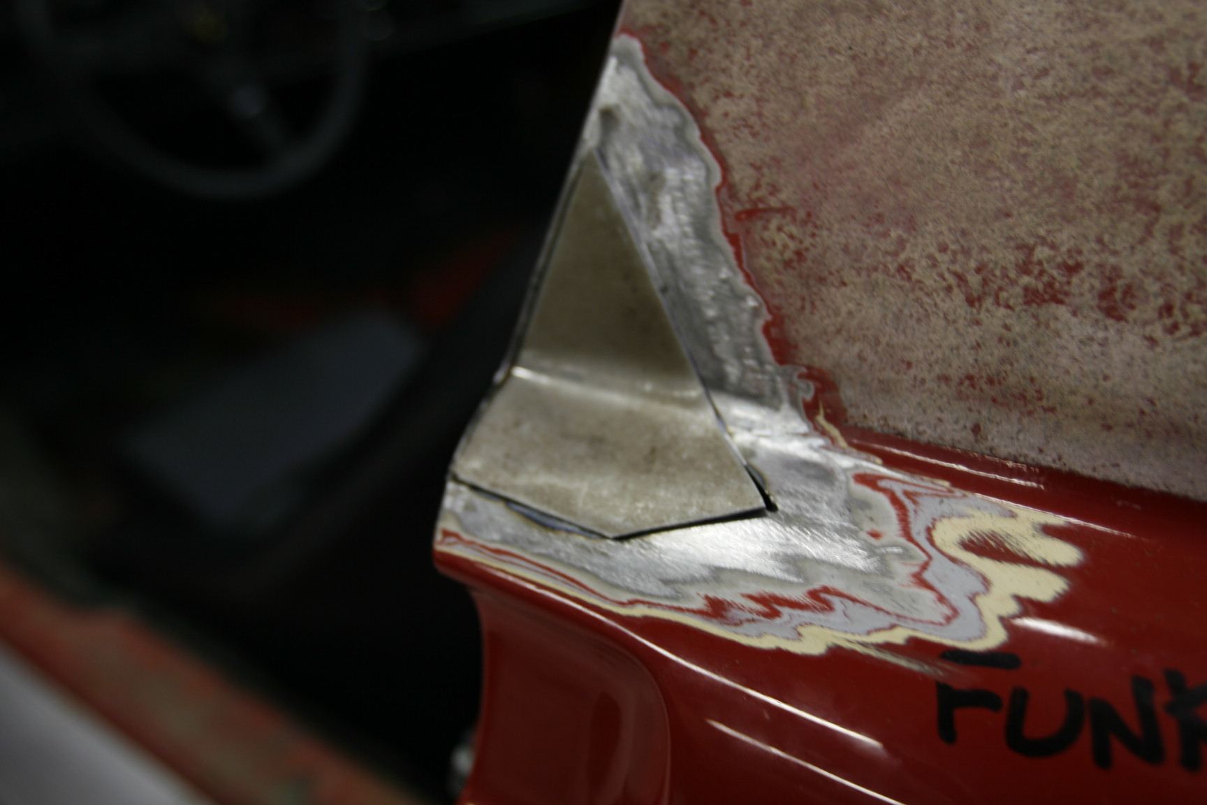

This is the left rear corner, has been bothering ... Feb 14 2008, 11:57 AM
John
you will have to remove *ALL* of the foam in th... Feb 14 2008, 12:38 PM

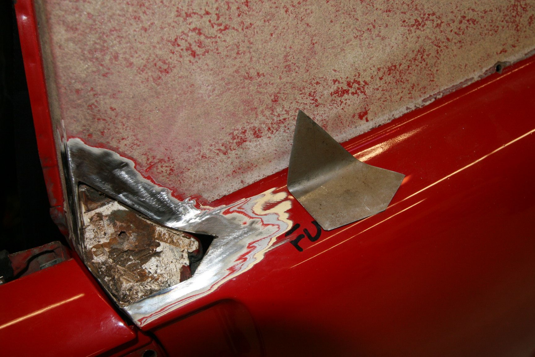

horizontally-opposed Other sail panel....
Two pinholes + the factory h... Feb 8 2008, 03:18 PM

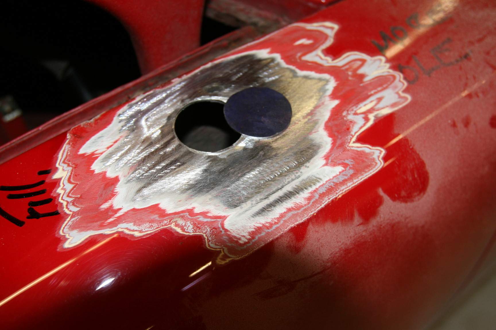

horizontally-opposed Two more pinholes in the right front fender, appar... Feb 8 2008, 03:22 PM

horizontally-opposed The two pinholes in the right front fender filled.... Mar 6 2008, 12:21 AM

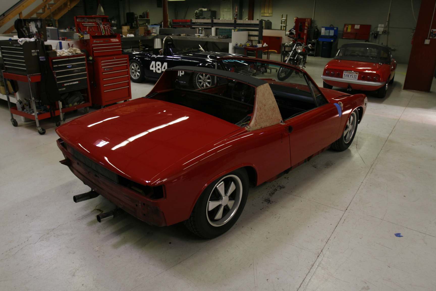

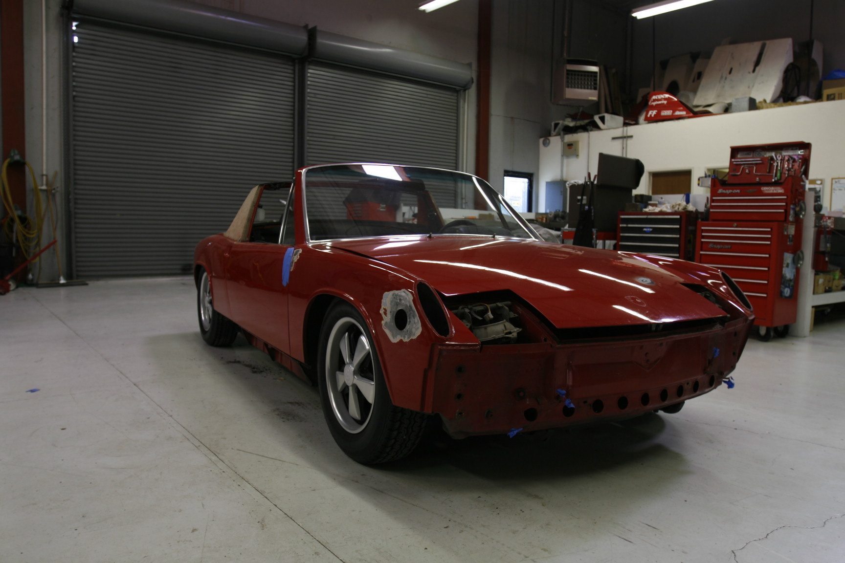

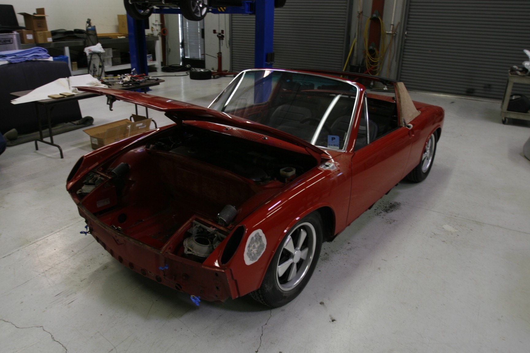

horizontally-opposed So this is where the car stands today. Just a litt... Apr 7 2008, 02:05 PM
horizontally-opposed And from the rear. Man those 165s on steelies are ... Apr 7 2008, 02:06 PM
