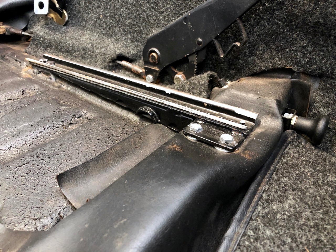

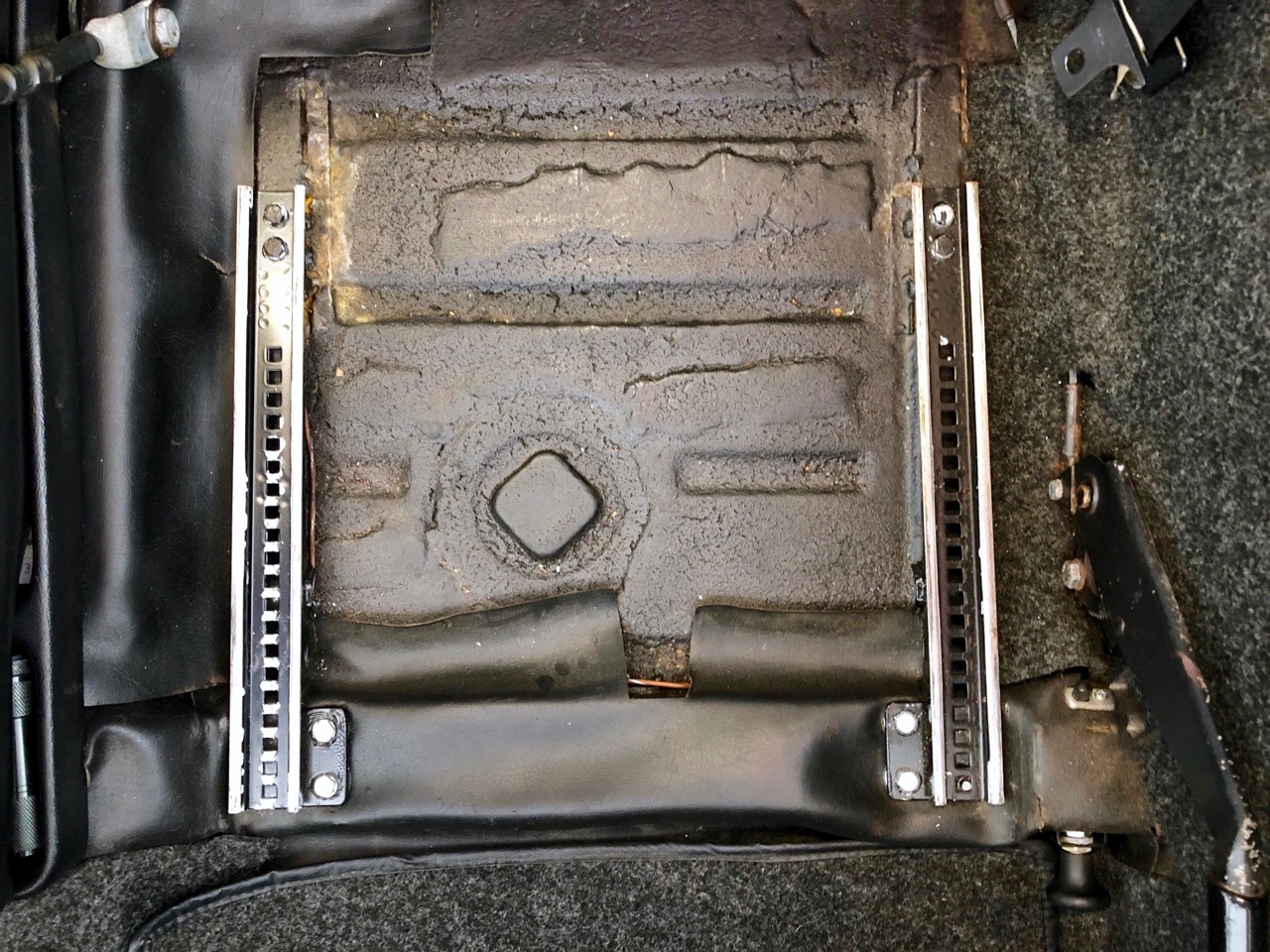

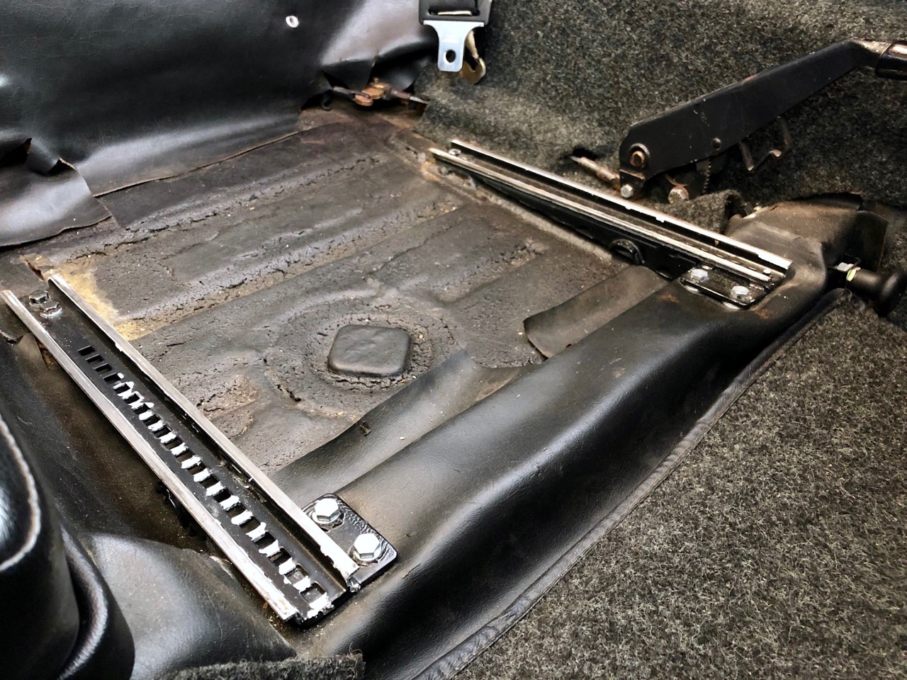

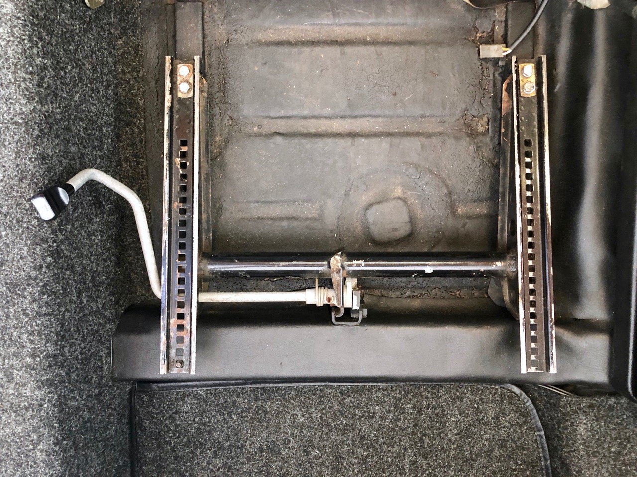

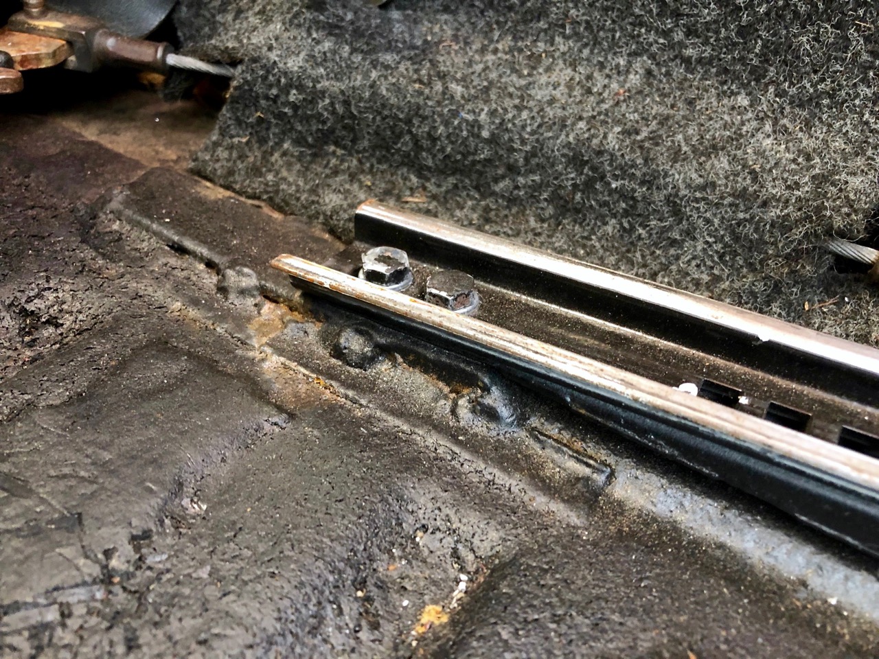

Hmm, I have to say if there is a downside to the mod it is that getting the seat on and off the rails is not fun. At all. I'll try to do it anyway next time I have the car out of the back of the garage.
Haven't made much progress of late. Need to re-do the brakes with new calipers (thanks Eric!) and re-do the carpeting in the front trunk. Then it needs to go back to the painter for a final buffing and detailing. I cannot believe how long it's been off the road, but buying a house and remodeling a kitchen and life has intervened. I am sure nobody can identify! (IMG:style_emoticons/default/biggrin.gif)
EDIT: Took the seats out and got some photos of the completed setup. Yes, it only took me fo-eva. Text from another thread on adding Scheel seats:
Many moons ago, someone asked for photos of how my driver's seat was lowered. Getting the last pair of seats out wasn't fun, as I didn't take the time to get the rails aligned as well as they could be, but I took the opportunity to grab some photos of the setup today.
You can see that the cross bar under the front of the seat was cut out and "stepped down" with thicker metal. This was done at Genoa Racing in Novato, CA at the same time that the Engman chassis stiffening kit was added. I lost the ability to change the seat angle (which doesn't bother me, as it's pretty limited in the 914, and not bad as is), but dropped about 0.8 inch. Well worth it, imo...

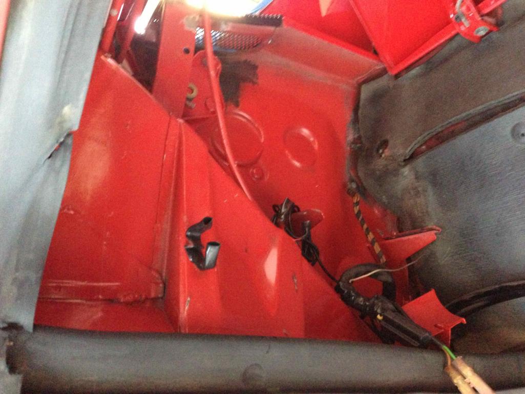

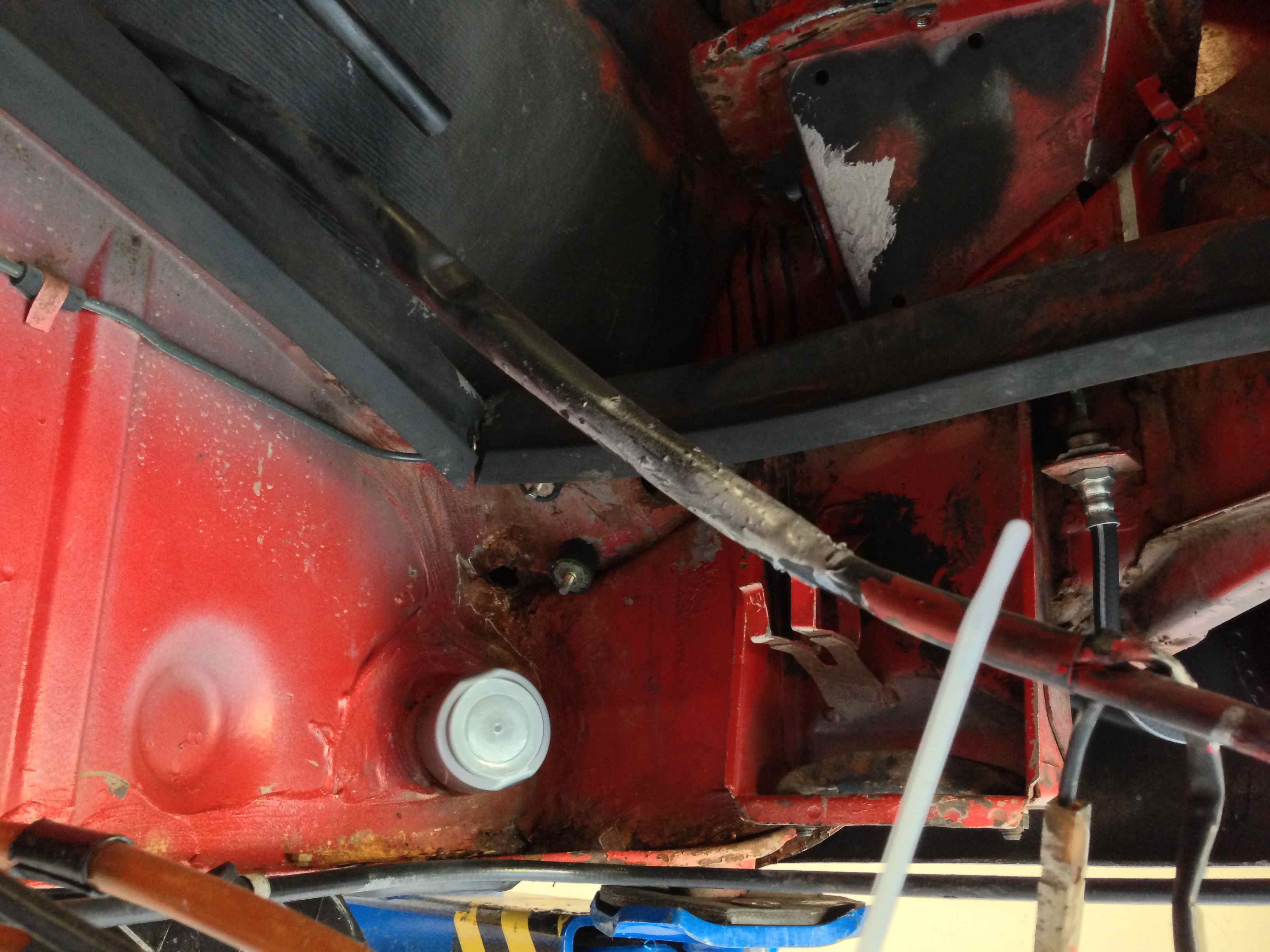

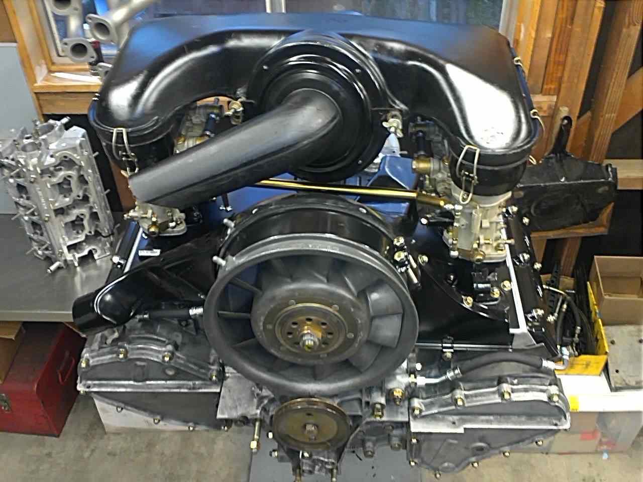

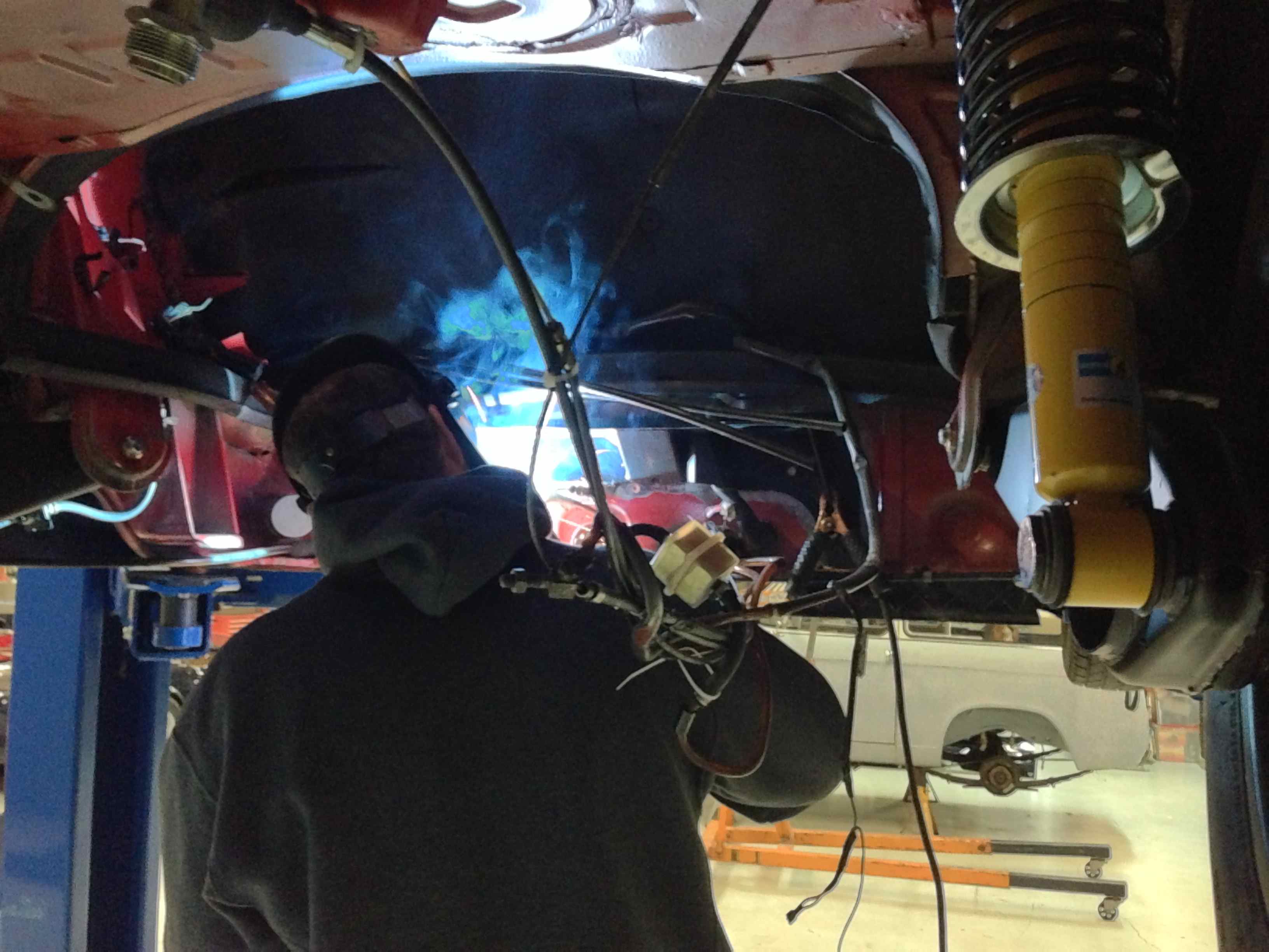

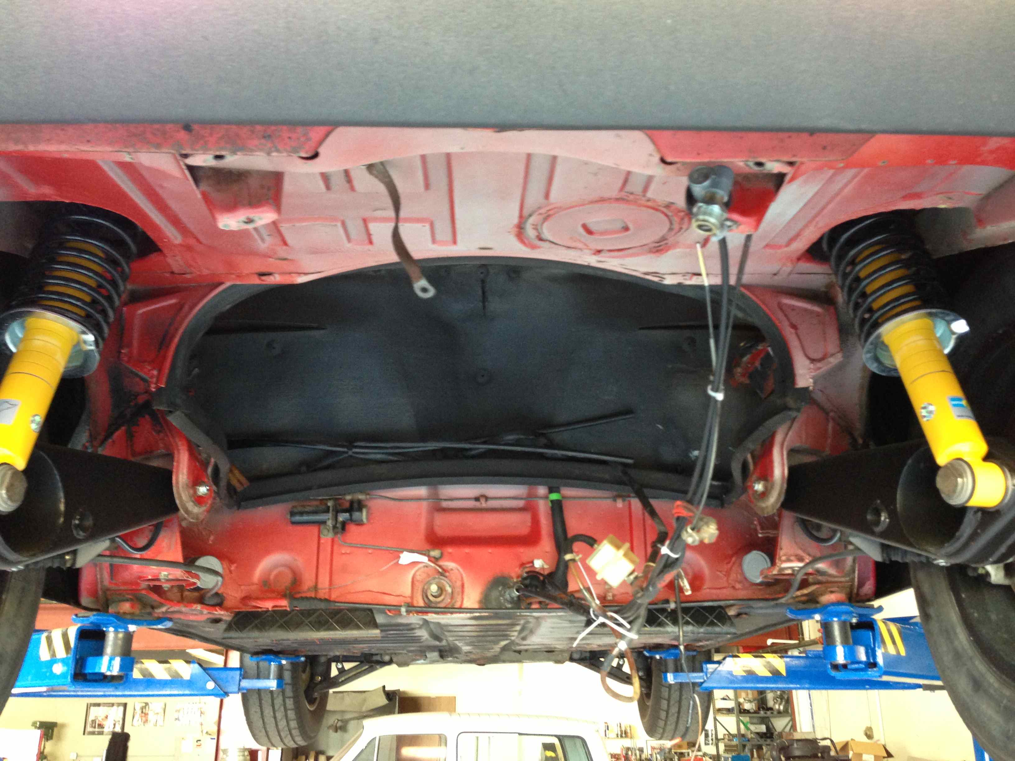

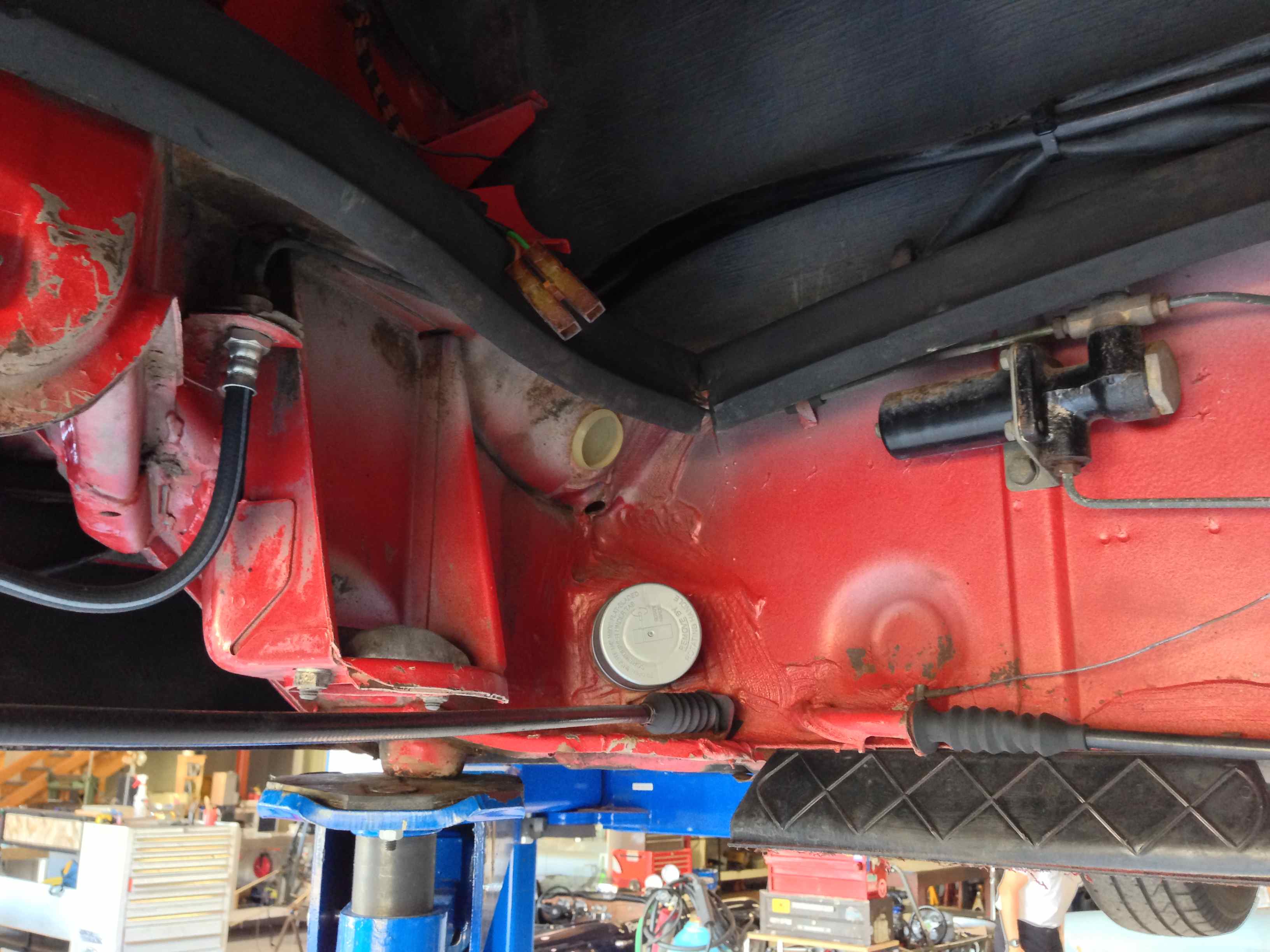

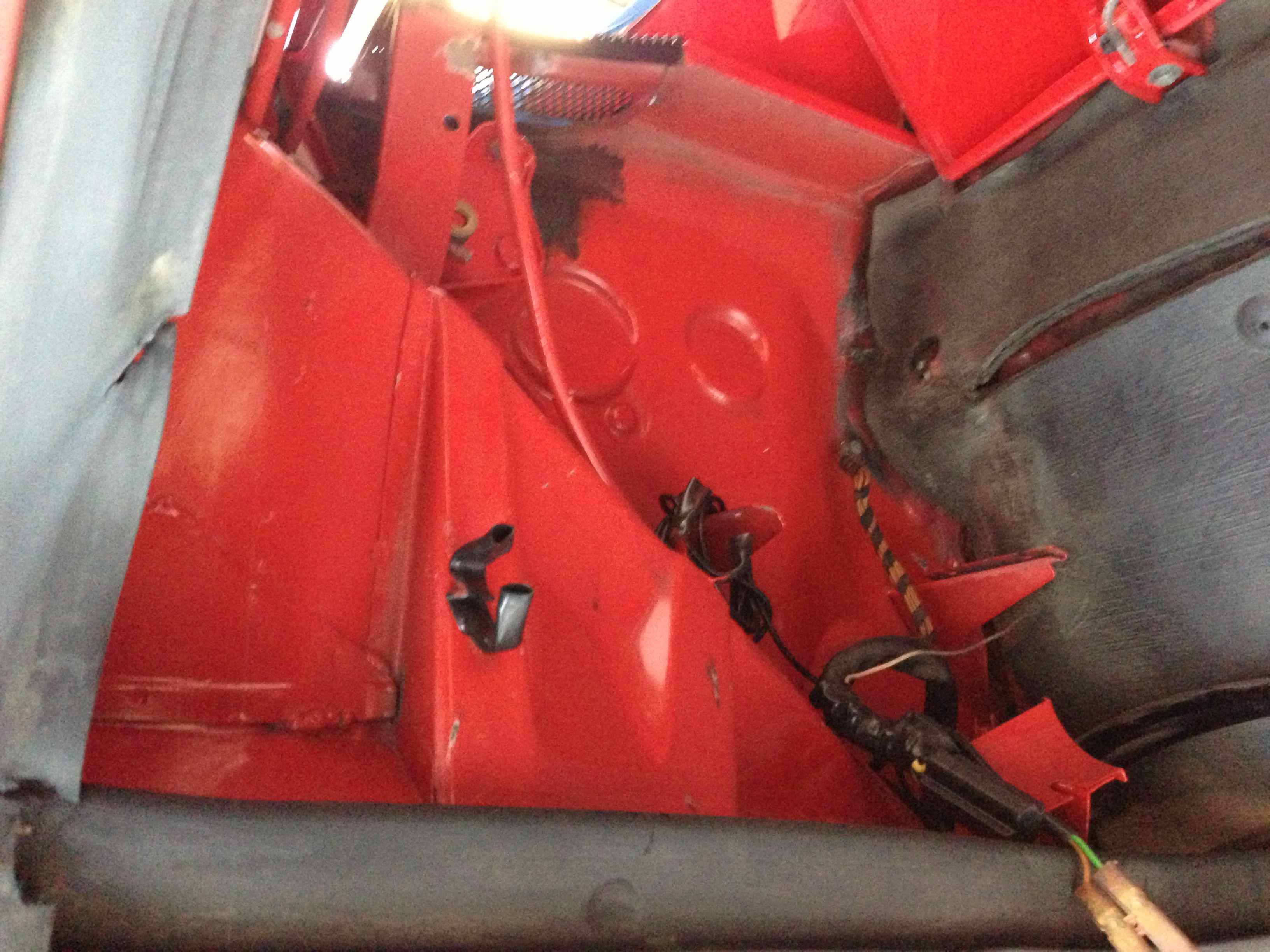

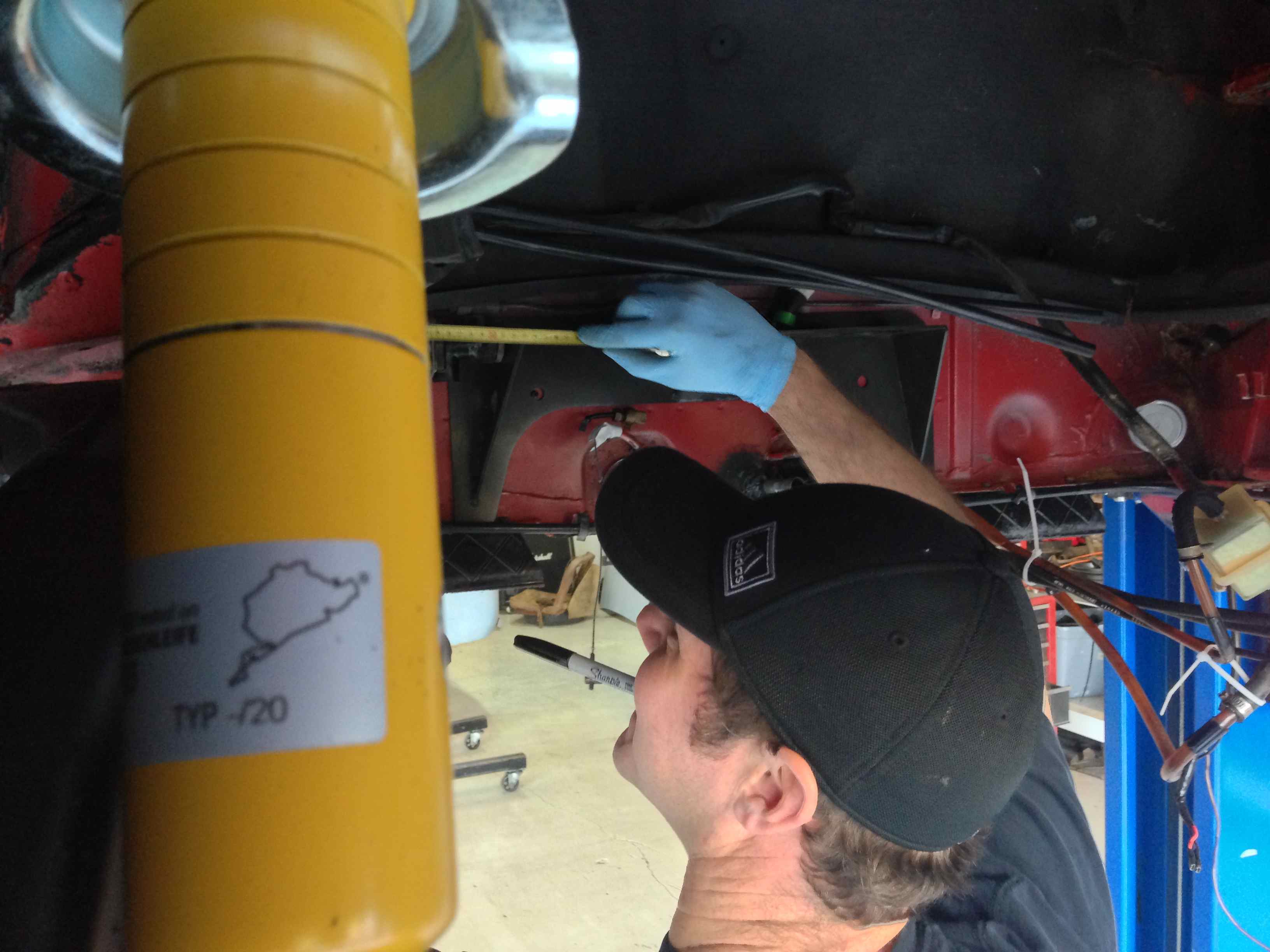

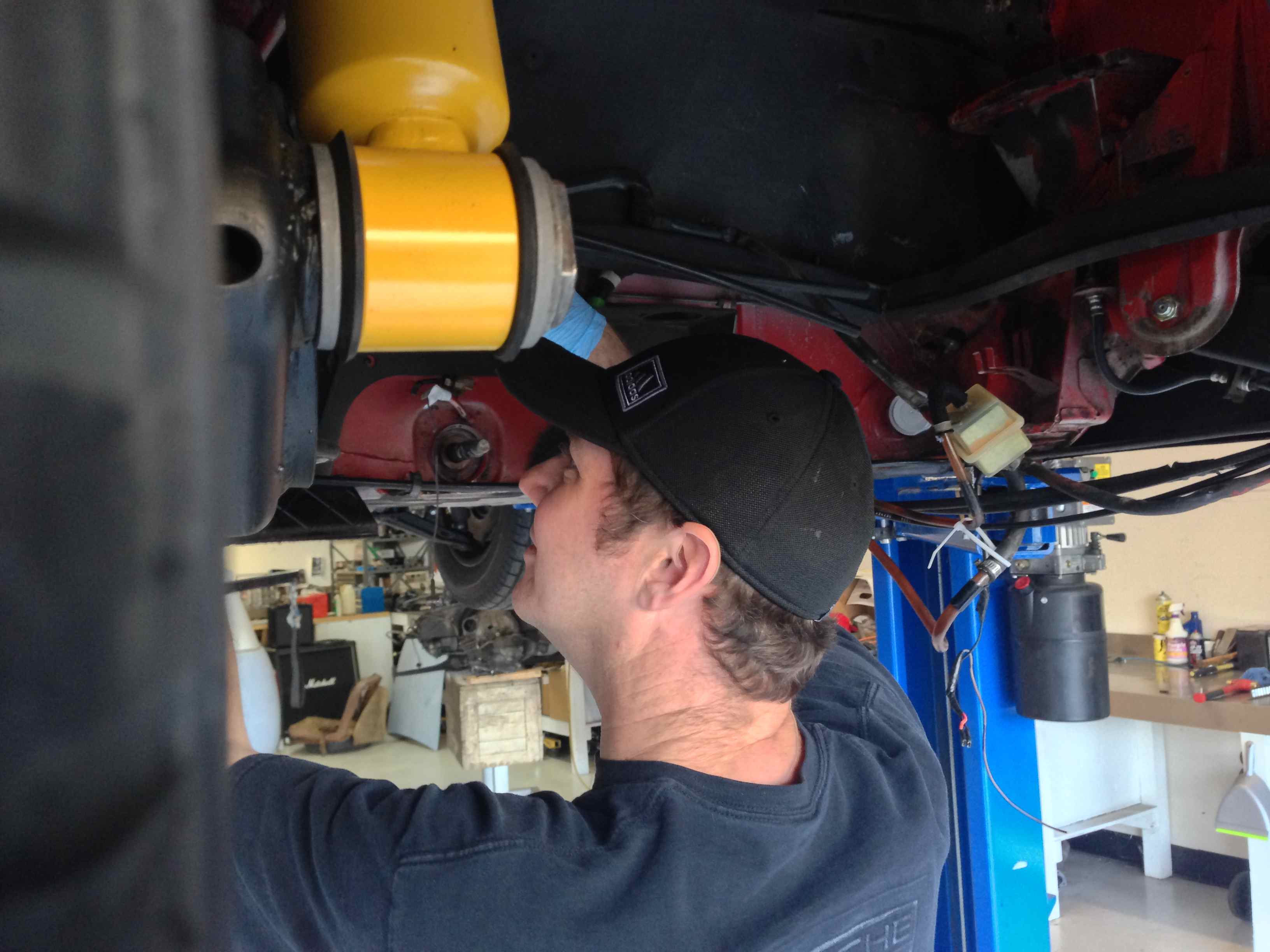

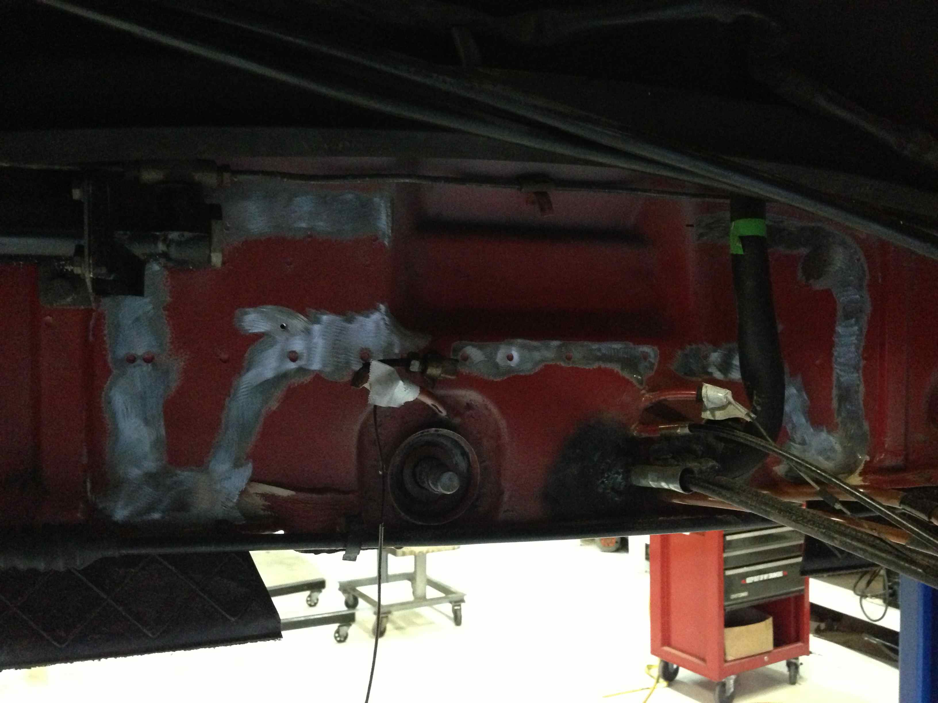

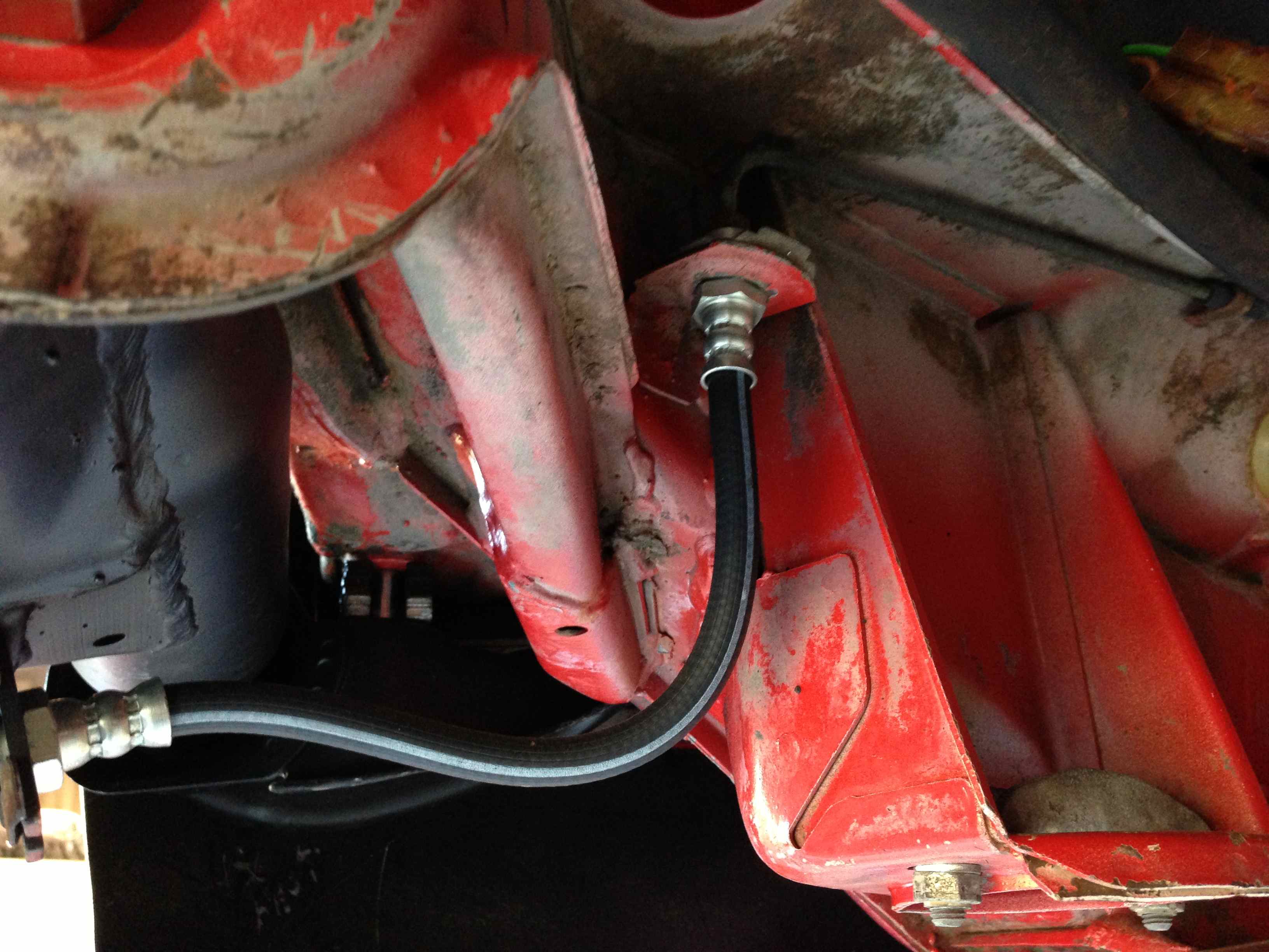

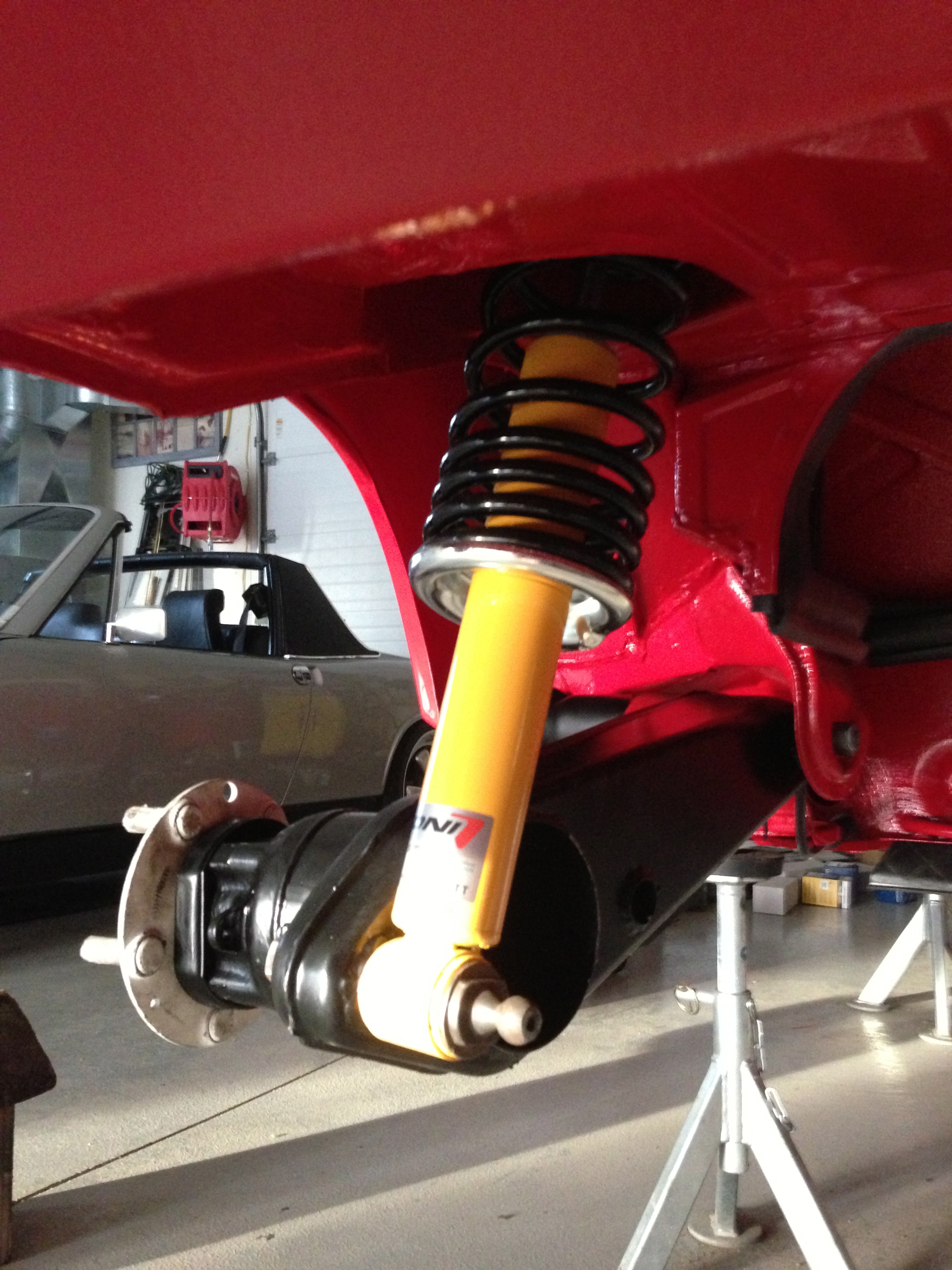

Long time no post. Kitchen remodel, bathroom remodel, job change, arrival of our first child, and the wildest year I've had in general conspired to put the car well down the priority list.
Anyway, got the motor out and had the engine/transmission area professionally steam-cleaned and detailed. After 250,000~ miles (est) and 40 years, I could not believe my eyes: It looks great down there. Everything passes the screwdriver test, and the hacky high-school job I did of cleaning up the original battery tray, repainting the area, and installing an Optima back in 1991 probably helped a lot.
Last night was the first (non-work) car time I've had in probably six months. And boy was it therapeutic. Three guys, one 914, and an empty race shop. (IMG:style_emoticons/default/chowtime.gif)

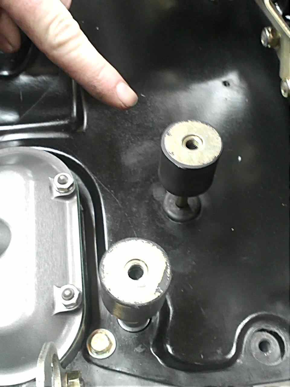

Objectives: Punch holes for NOS 914-6 oil tank and install Rich Johnson engine mount.
Fuel: Arun Thai, the best Thai food in the north bay by miles.
Outcome: Just a great night.
Photos: Below (click on any to make it a bit clearer...)
Update since last time: Engine is done, all suspension rebuilt.
Can't wait to drive this thing again...and can't believe how long this project has stretched out!

Since you've gone this far Id take out the back pad if you haven't already & just check for any damage or thinning due to tin worm that may be lurking.

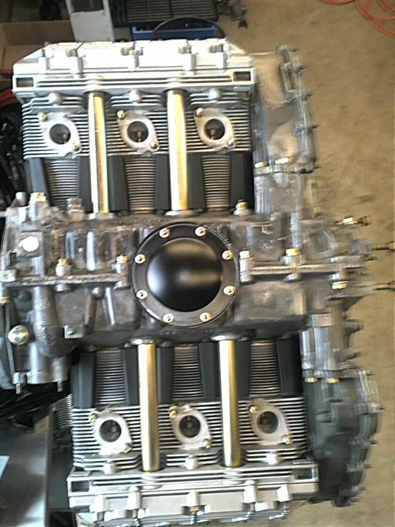

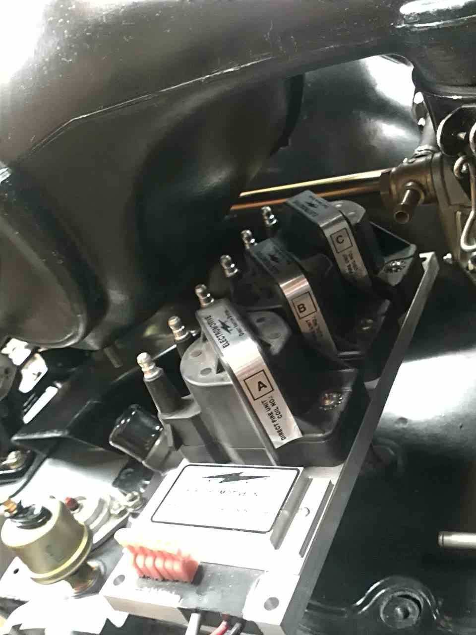

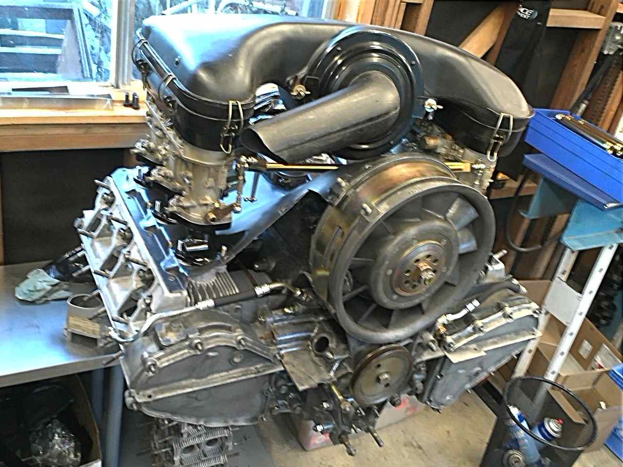

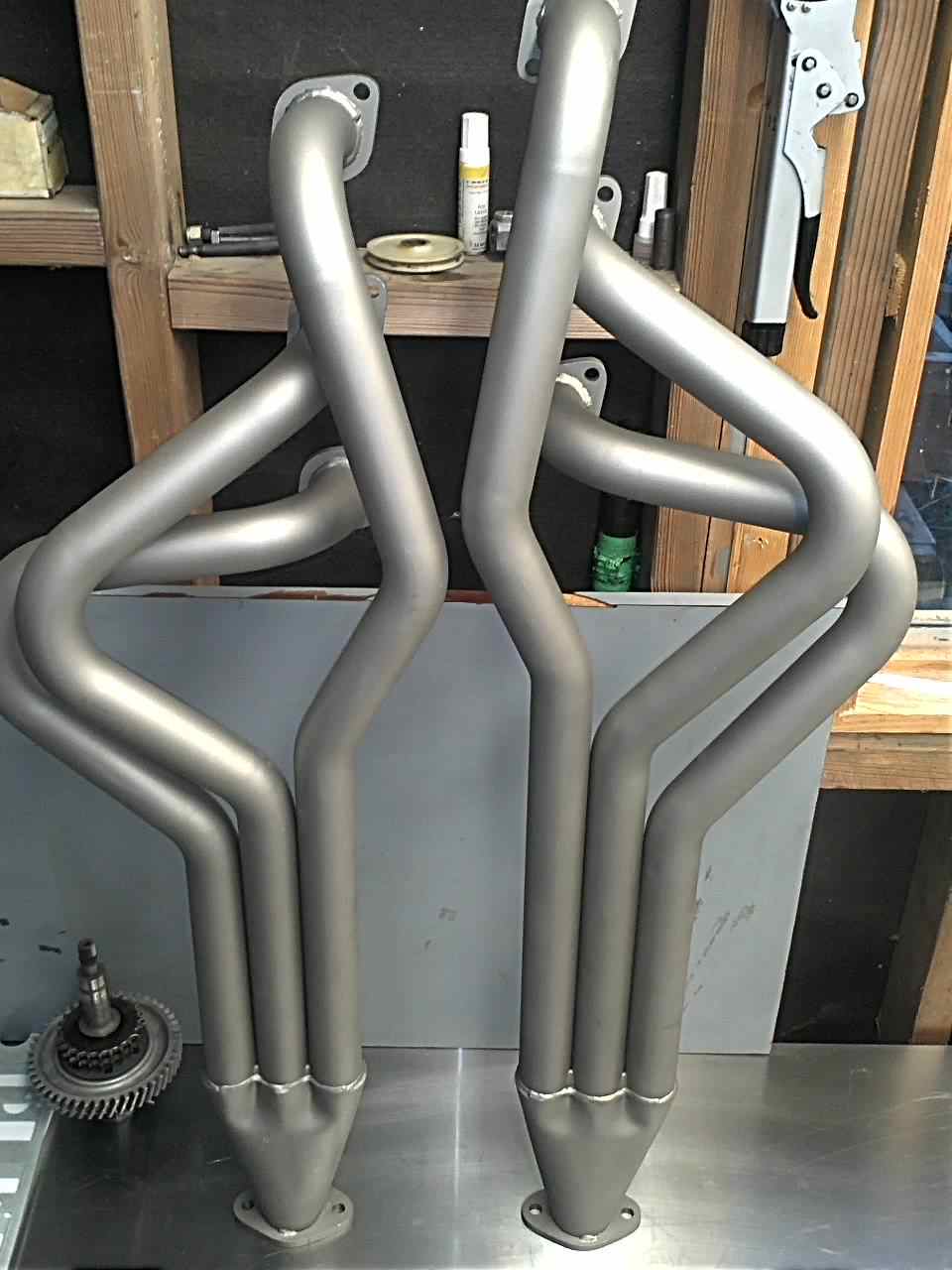

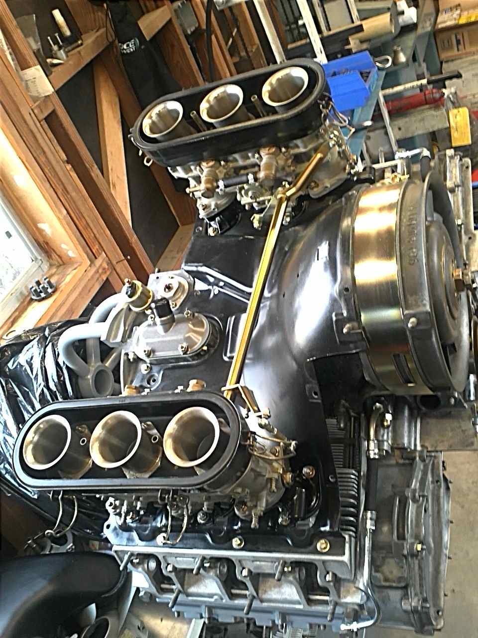

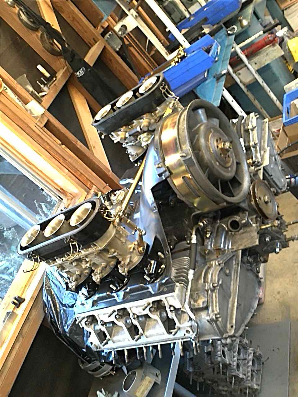

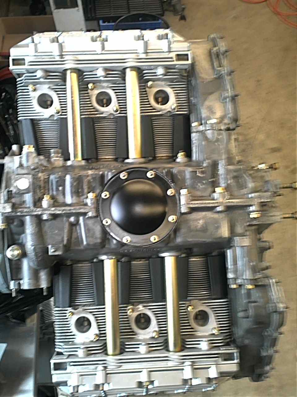

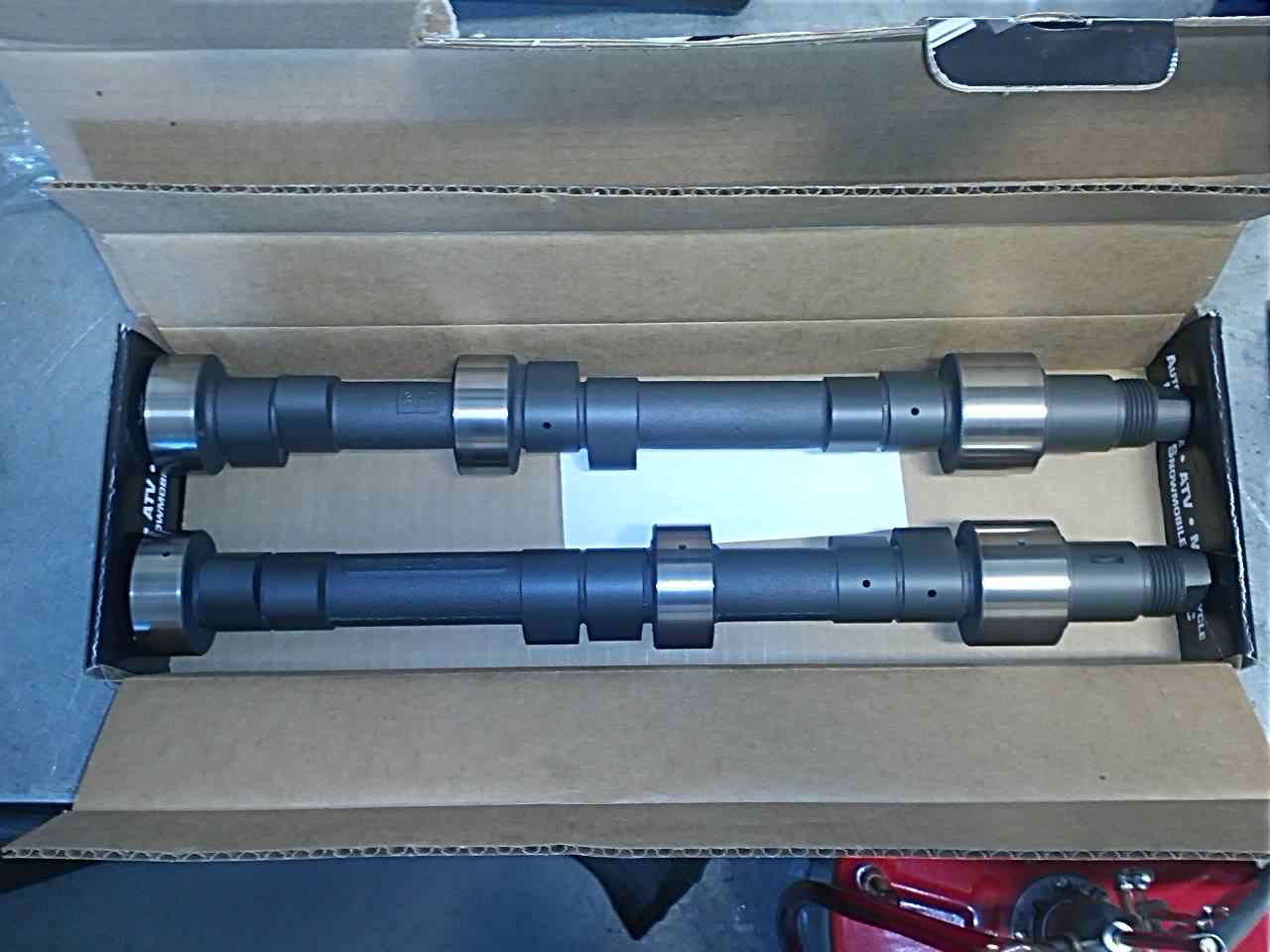

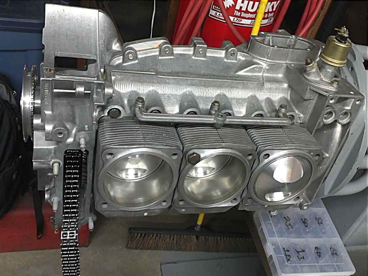

Engine is not one of the wilder setups. It's a "2.2E" built on an unstressed 911T case with a (nice) used Mahle E pistons and cylinders. It's got a bit more compression (splitting difference between E and S), Solex-grind cams, Weber 40s, Electromotive ignition on the engine (isolated by M-B mounts), headers, and (probably) a 911 sport muffler. May do something different with the muffler, we'll see.
We've been paying with the fan shroud strap and still need to touch the letters on the valve covers to spruce them up.

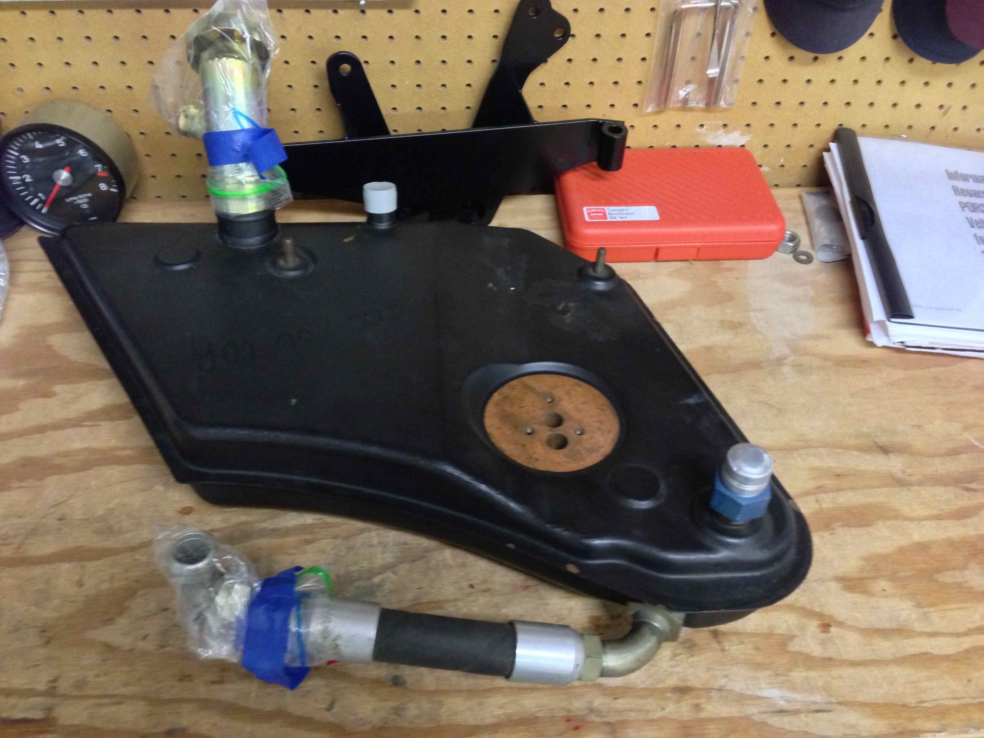

NOS oil tank was one of three that sat and sat and sat in the warehouse because someone mistakenly scrawled a 901 part number on each of them with a black pen—so Porsche didn't know it had them. Discovered years ago, this one has been waiting to find a home for a while.
Sorry about the phone pics, but that's what the builder, John Holleran, had handy. Then again, "the best camera is the one you've got" definitely applies here...wouldn't have had anything without it!

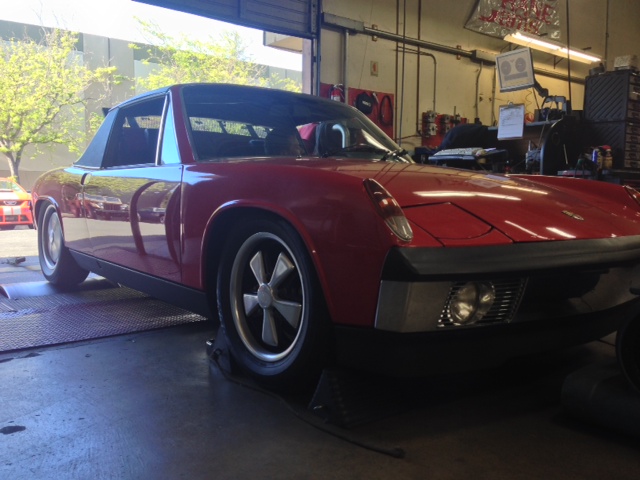

The glacial progress of my 914 "paint job > freshening > cosmetic restoration > brake upgrade > chassis rebuild > six conversion" continues, with the latest update being the car went onto the dyno at RPM Engines and surprised me.
With some tuning—mainly timing related—it made 169 hp at the rear wheels with 147 lb-ft of torque at the rear wheels. Applying a 15% powertrain loss factor, which always gives me the hives, that's 199 hp and 173 lb-ft at the flywheel. The torque comes on strong nice and low and then stays fairly consistent from there on up, from 3000~ rpm up to and through 6000 rpm. Not shabby for a small-bore 2.2, and very driveable. I'm told there's a little more power to be had with a different exhaust setup with the collectors moved further forward, and we lost more than we should have when the factory 914-6 air box went back on, so I need to figure out my final exhaust and intake setup before we do final tuning.
For the time being, however, I am one happy camper. (IMG:style_emoticons/default/driving.gif)
