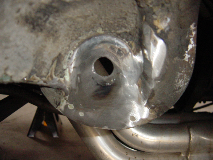

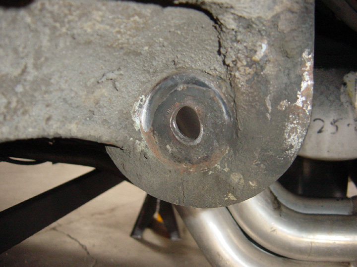

Jeffs9146
post Feb 22 2008, 05:41 PM
Ski Bum
Posts: 4,062
Joined: 10-January 03
From: Discovery Bay, Ca
Member No.: 128
Ovaling before repair and after repair!

QUOTE(Jeffs9146 @ Feb 22 2008, 03:41 PM) *
I read several threads on it, did you use a washer and weld it in then file down? If not, a little more detail on the method for the fix would be appreciated.
