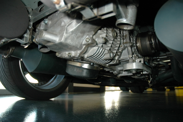

The transaxle is sourced from the same 993 RS Porsche, which is a rear
engine vehicle. The 914-6 is a mid-engine vehicle and required some
modifications to fit the 914-6 chassis. This was done with custom
aluminum castings and modifications to the shift linkage. The CV Joints
were upgraded to 930 Turbo specs to accommodate the extra horsepower.
The quality of work could be mistaken for a factory vehicle.

Uhhhh... that ain't no G-50 transmission. That's a 915 with a Vellios kit!
But it is still a nice car.....
