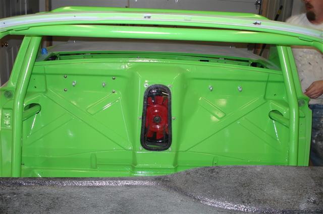

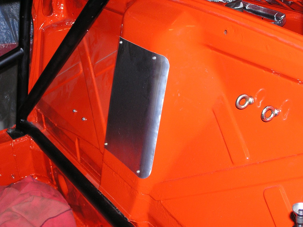

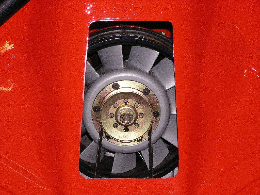

Here is another view of an access window...
