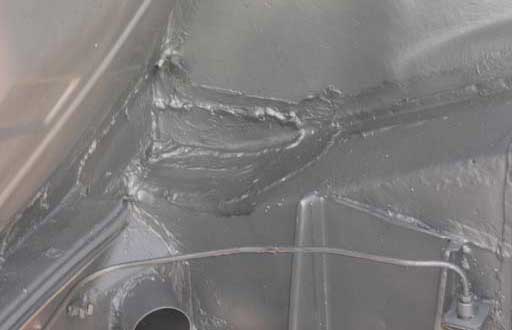

the area below the battery and forward along the top of the frame rail
In your pic, if the battery and ECU were out of the way, the corner down in the bottom where the top of the frame rail and inner fender wall meet the firewall and along the top surface of the frame rail all around there.
If the car sees rain, water runs off the battery, picks up some acid (since it still has the old non-sealed lead-acid battery), and runs down, hits the top of the frame rail, runs forward and down.... Over time does it's damage and eats a hole, then starts dripping into the inside of the frame rail, then can lead to real damage.
This one doesn't look bad. But plan on getting rid of that battery, killing and sealing any surface rust, then installing and Optima or Odyssey sealed battery.

Rand
post Mar 12 2008, 01:26 PM
Cross Member
Posts: 7,413
Joined: 8-February 05
From: OR
Member No.: 3,573
QUOTE(HeelnToe @ Mar 12 2008, 11:05 AM) *
So, looking at the photo, basically right in line behind the little strap holding up that black cable?
Here's a pic I found online that should help. You can see the areas they cut out and patched.
