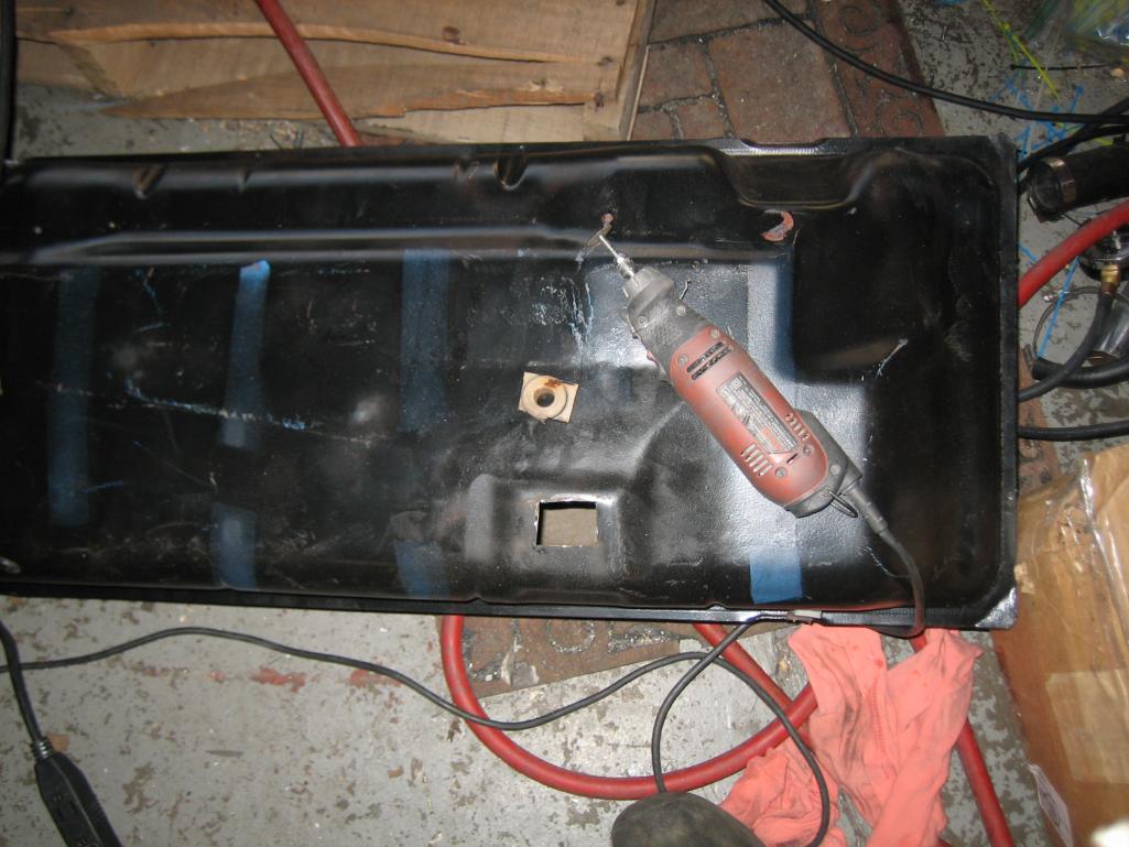

Easier than I thought. I will leak test it tomorrow and install if it doesnt leak. (IMG:style_emoticons/default/smile.gif)

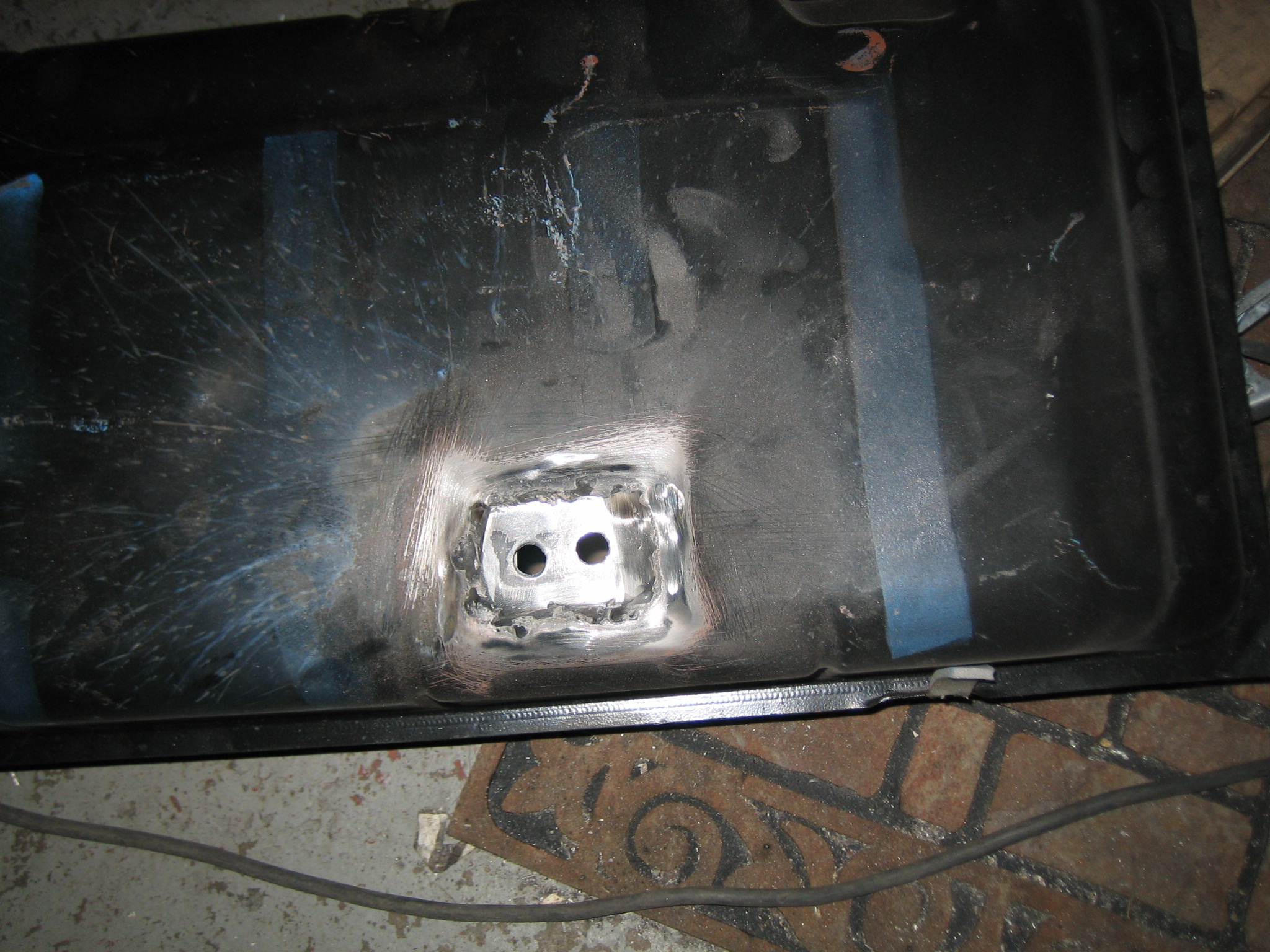

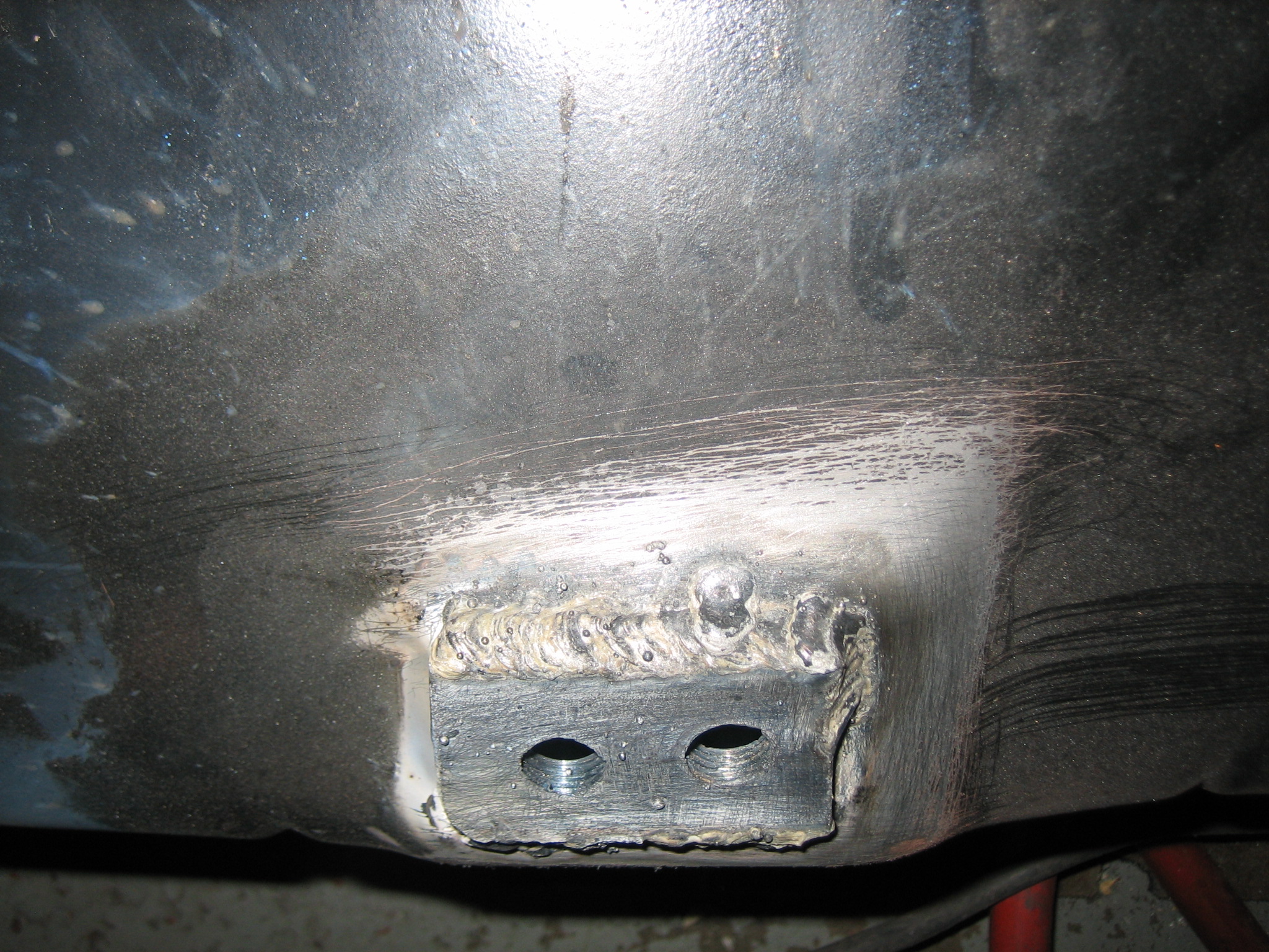

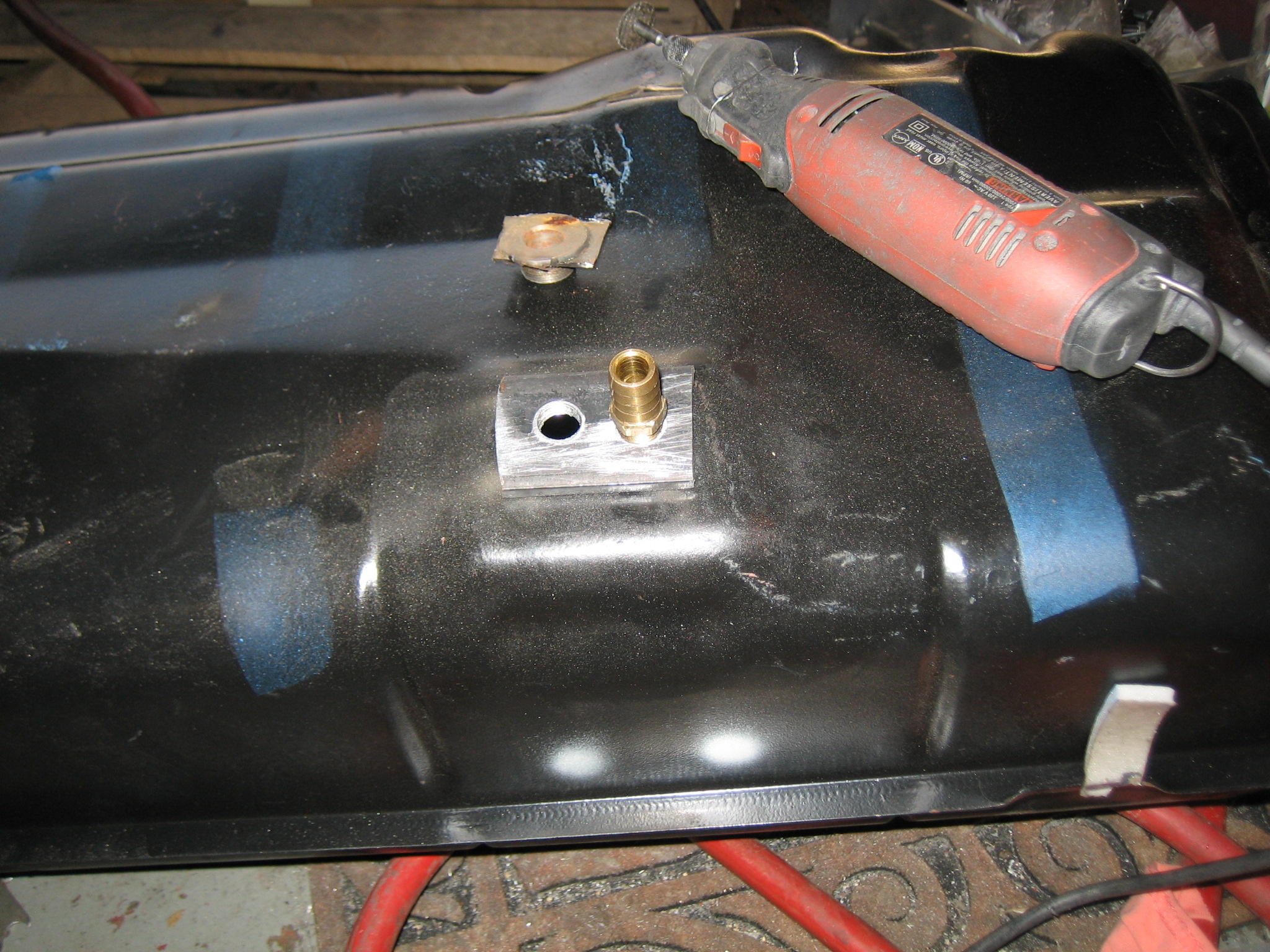

Well, the leak test of the tank turned into a can of worms (IMG:style_emoticons/default/dry.gif) The tank metal was so thin in the area I welded that it would vanish with any exposure to the weld metal. I cut some out, welded in thicker, leak tested it again, had a stroke of genius and finish welded upside down with water in the tank to keep the metal from vaporizing. It has now passed and is in pain with a fresh coat drying before install. I start work at the hospital at 7pm until 7pm tomorrow so no more progress this week.
