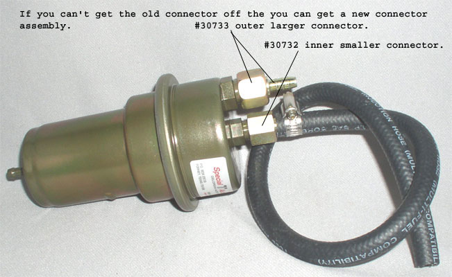

So, for $50 I can get all the hose from McMaster to rebuild the system to stock. I have just bought the 12mm banjo I needed for the fuel pump output, now all I need to figure out is what fittings are on the pressure accumulator and where to buy them.
Anyone know what they are called and where I can score a set?
Dr Evil
post Apr 9 2012, 03:32 PM
Post #1271
Send me your transmission!
Posts: 23,041
Joined: 21-November 03
From: Loveland, OH 45140
Member No.: 1,372
Ordered the hose, ordered the 12mm banjo, here are the fittings I need. I can use ones cut from a CIS line if any one has some (IMG:style_emoticons/default/smile.gif) These are for use with regular fuel line.

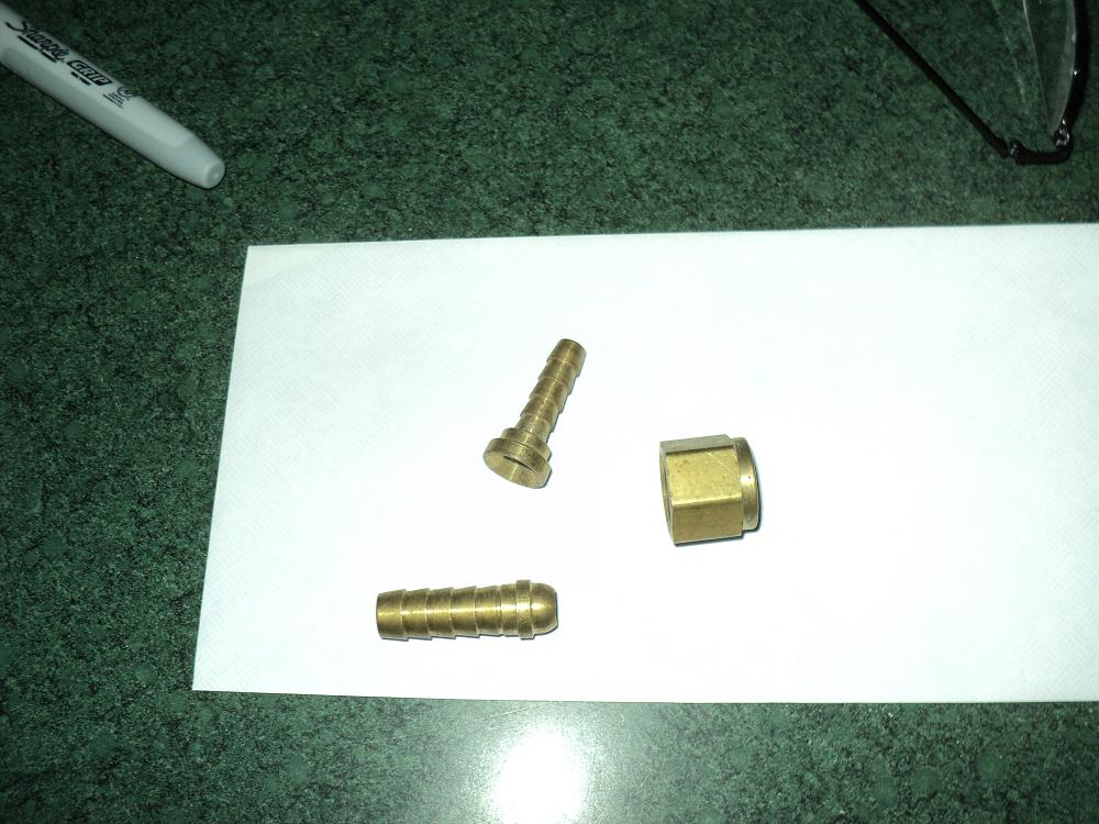

post Apr 9 2012, 11:14 PM
Post #1280
Hey nice rack! -Celette
Posts: 21,139
From: Now in Superior WI
Member No.: 43
Is this what your looking for? After seeing the link I looked through my stash and found these. The only thing is I'm not sure the fitting is metric. I tried to screw it on about 6 other male fittings I have in my brass stuff and it wouldn't thread on stuff that I know is not metric.... (IMG:style_emoticons/default/confused24.gif) It's a crap shoot. (IMG:style_emoticons/default/shades.gif)
