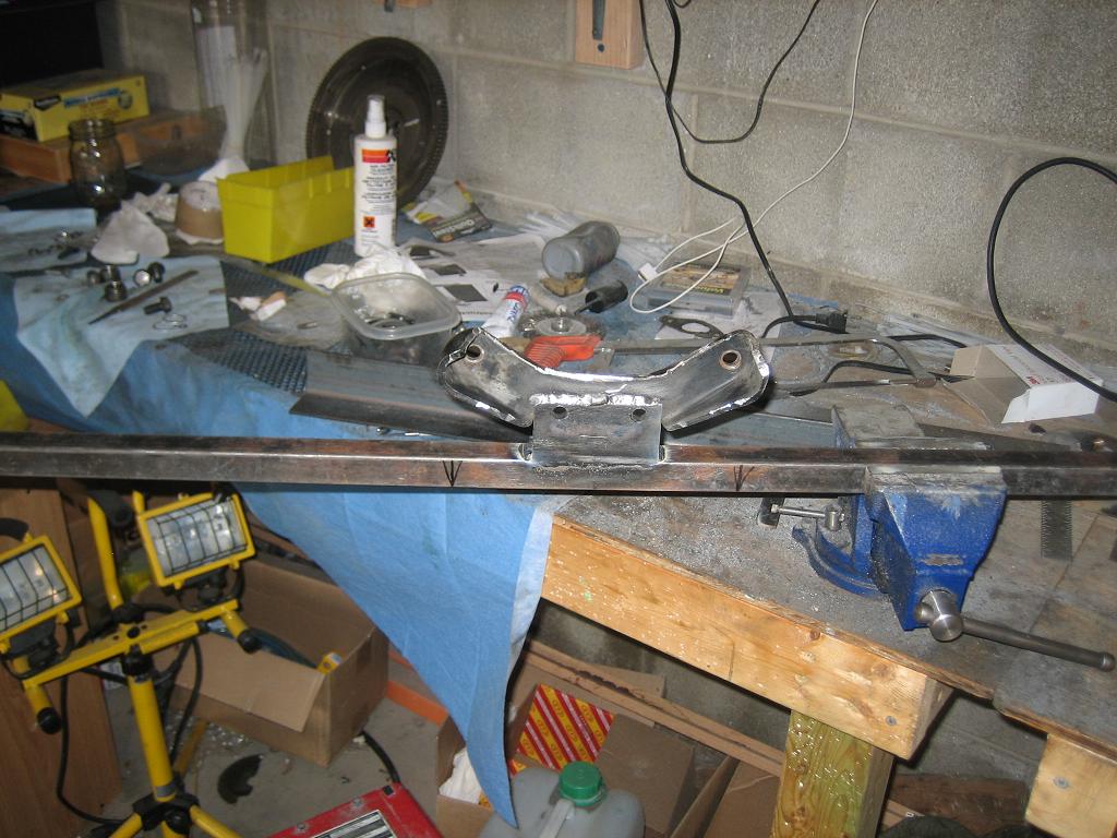

QUOTE(Vacca Rabite @ Aug 28 2009, 09:43 AM) *
In the last picture, the engine is sitting cockeyed. That will be leveled when we are all said and done.
Also the clamps are there just until the super glue dries to join the metal bits together. They will be taken off before we bolt the engine on.
Zach

QUOTE(jsayre914 @ Aug 28 2009, 11:36 AM) *
is that the same super glue i used on my glasses the other night (IMG:style_emoticons/default/chair.gif)
maybe.
Its what I could find first. Since its an engine mount we wanted to use something really strong, that was also fast drying. It was about to start raining so we did not want anything that would still be setting up once the rain hit.
Zach

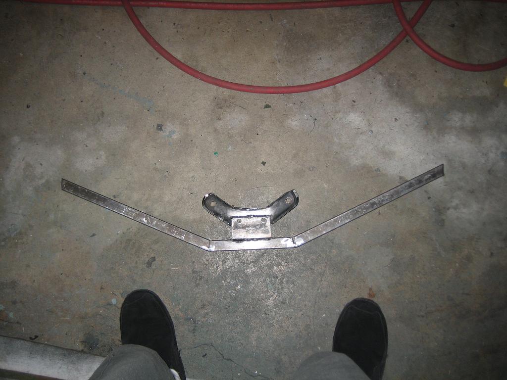

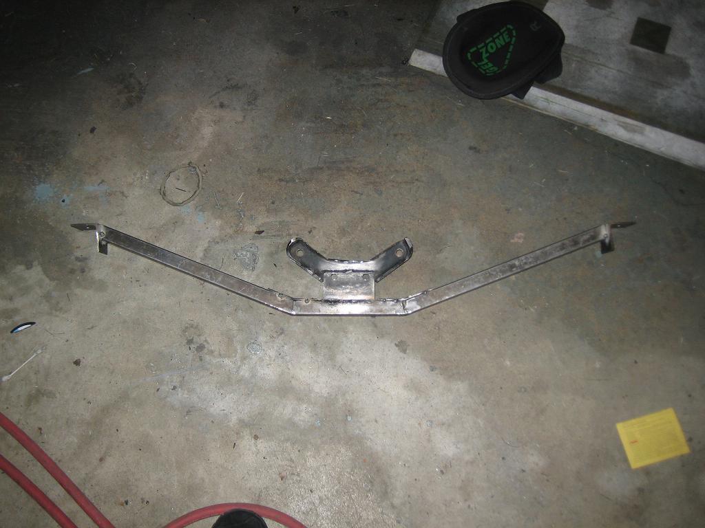

Tonight Zach hooked it up. We both decided that we wanted the bar to be bent so I busted out the trigonometry and got pretty close to perfect. We will finish it up tomorrow (IMG:style_emoticons/default/smile.gif)

That looks sweet. (IMG:style_emoticons/default/smile.gif)
Very nice job guys. Now what, little rustoliem and bolt it in there.?

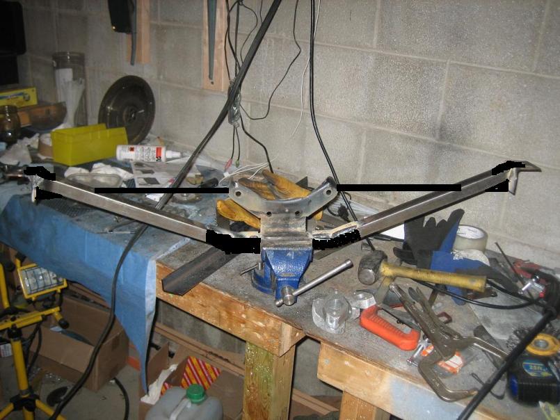

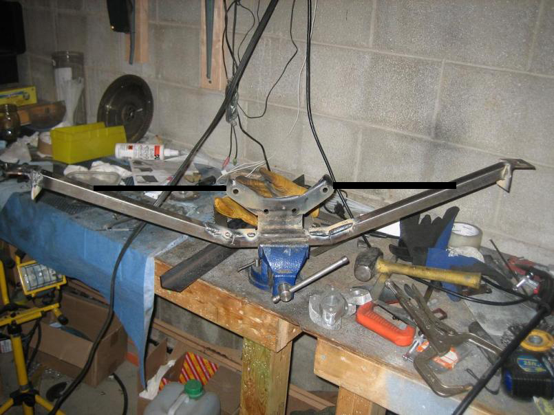

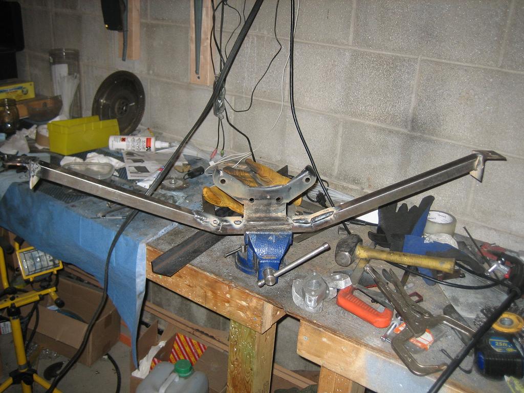

Little more welding yet.
I want to reinforce the mounting plates and also the cut area- fully box that part in.
Mike cut the pieces tonight after we got back from the pool, but I was too wiped to start welding. I'll KO that tomorrow after work.

Is that bar stong enough?
Possibly add an upper section to make it like a truss???
Seems a little small/thin???
Rich
Dr Evil
post Aug 30 2009, 08:22 PM
Post #430
Send me your transmission!
Posts: 23,041
Joined: 21-November 03
From: Loveland, OH 45140
Member No.: 1,372
We are considering a truss, but we also consider it over done at that point. Not that being over engineered is a reason we consider for stopping (IMG:style_emoticons/default/wink.gif)

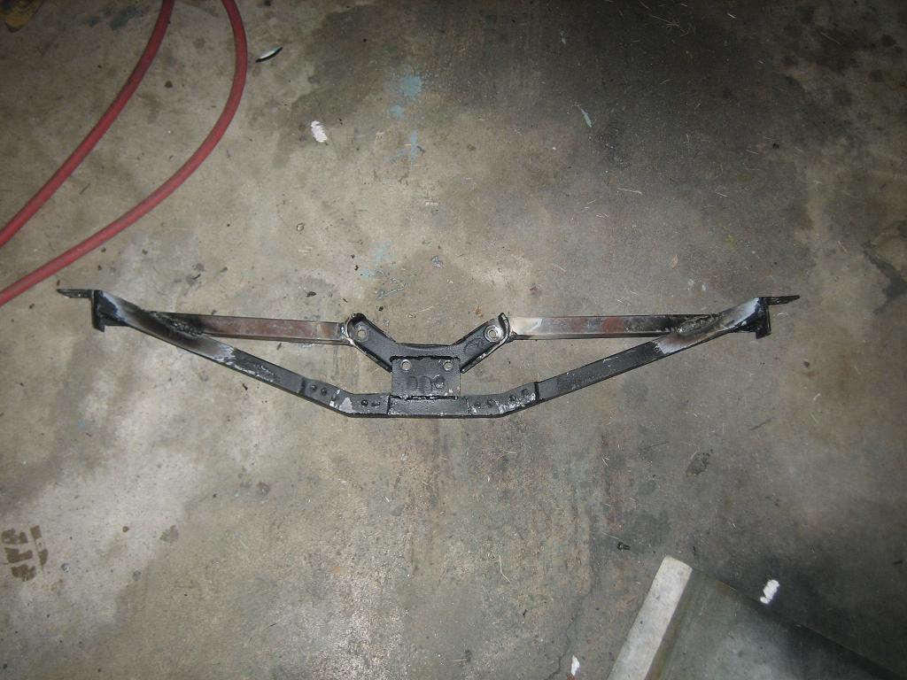

This is what I would like to add.
We have the metal sitting in my shop.
Does not add complexity, really. Does add strength.
It is probably not needed. But I'd rather over do it.
Zach

We already have the metal ready for adding in the darkened areas of the pic

Yah, tonight as soon as I get home I have a lot of welding to do. The good news is I get to do the fun parts (welding) and then hand it off to mike for grinding and painting (the unfun parts (IMG:style_emoticons/default/smile.gif) )

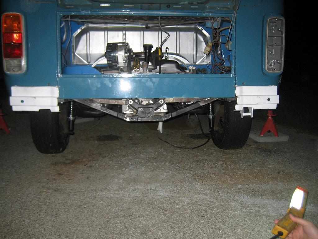

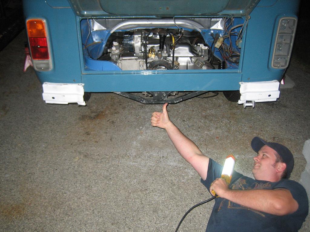

Tonight was victorious! We mounted the engine bar and hing the engine....then we decided it needed the extra bracing (IMG:style_emoticons/default/rolleyes.gif) The finished product looks bad ass! The engine is in, hanging and this is the best conversion like this that I have ever seen thanks to Zach's help and willingness to go the extra mile (IMG:style_emoticons/default/smile.gif) The bus has landed!

When you dropped the bus last night and the drivers side shocks and springs compressed and bounced a little and there was NO movement or flex in the engine and bar? Yeah, that felt good.
