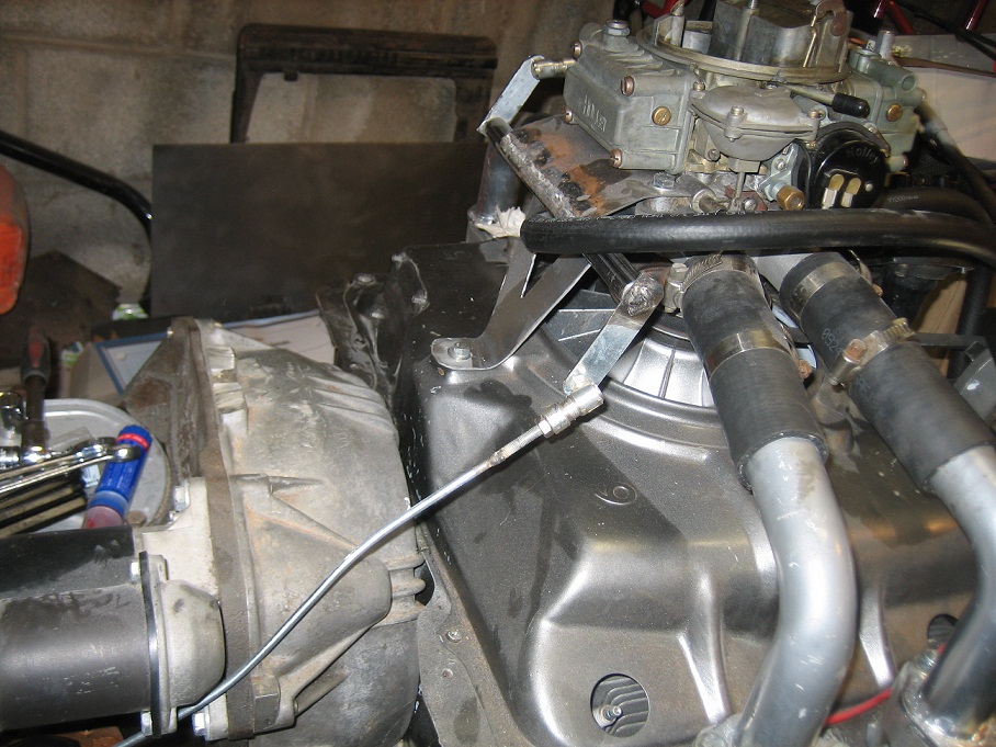

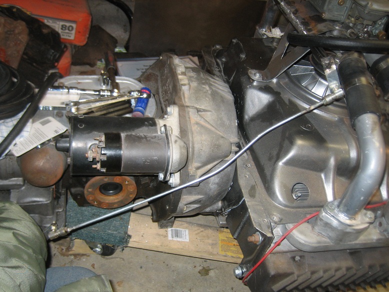

How about some new year's eve engine porn? Since Scotty B has seen fit to grace us with his benevolent presence this new years eve/day, Zach and I figured that we should do something special to commemorate this momentous occasion. We will attempt to fire up the engine later today! Enough with the $.50 words. I busted my hump to get the engine ready to run tonight and I can not think of any reason not to hook up a battery, fuel and see if we can get it to make noise (IMG:style_emoticons/default/smile.gif)
What was done today:
- Installed and static timed dizzy with Fireball optic ignition
- Installed coil, ballast resistor, wires
- Set up fuel pump
- Connected electrically adjustable jet fuel harness (this ought to be interesting)
- Clamped some of the oil lines down (I need 2 more hose clamps)
- Installed auto tranny filler tube after straightening it out (had to change curve to work with engine tin location)
- Drilled hole in air cleaner bottom and installed nipple for PCV input (Zach did this)
Tomorrow to do:
- oil filter
- Hose clamps for oil lines and PCV hose
- PCV install (I need to find one that can be modified to work in my application)
- Fluids
- turn key and smile (?)
And now some pics (IMG:style_emoticons/default/smile.gif)

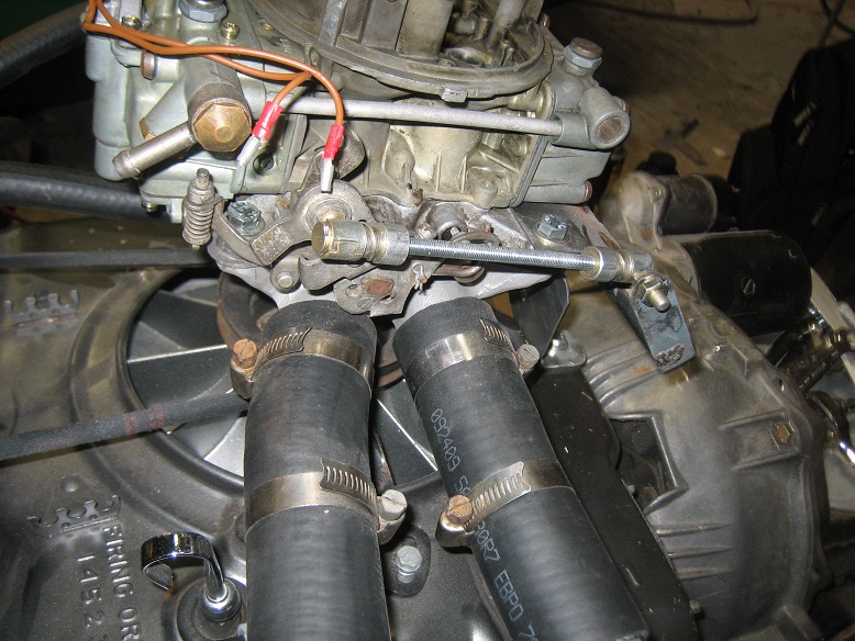

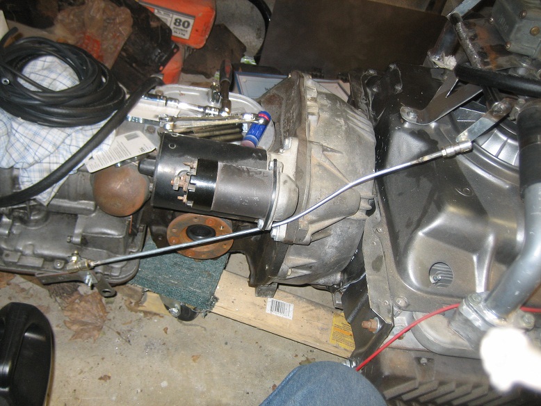

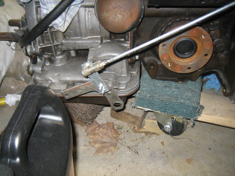

This is the linkage on the transmission. I changed the direction of the bend and made it a specific length to convert the 1 1/8" of cable pull into the 2 3/8" of throttle lever play at the carb.

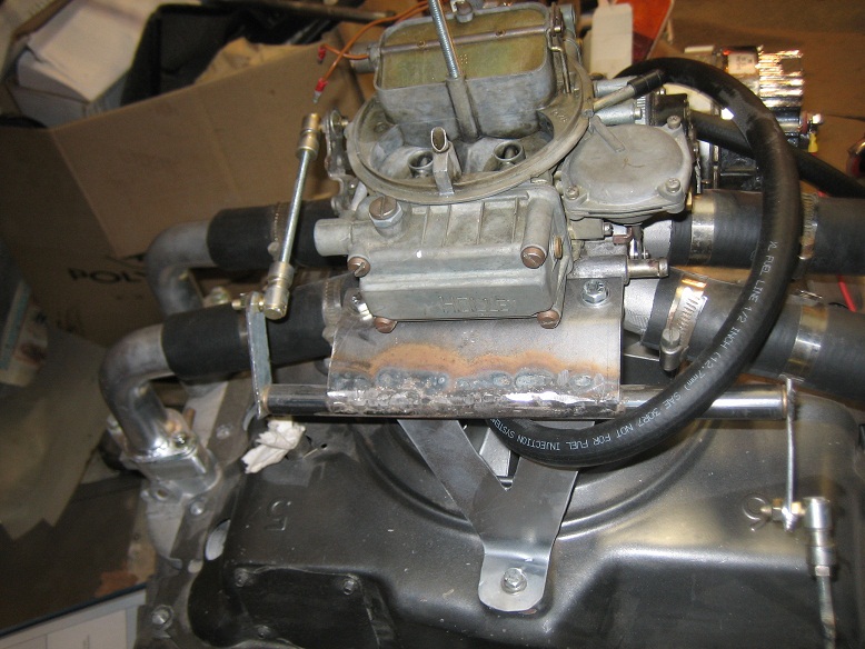

The second link. I used a 1/2" ID x 12" section of black pipe and some brass bushings for the pulley housing.

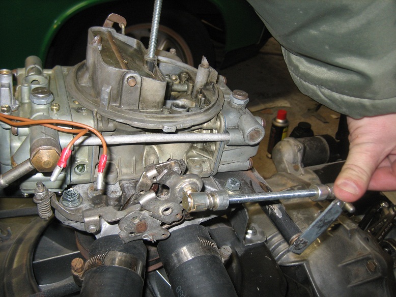

Links 1 and 2 connected and full open.

Links 2-3 closed.

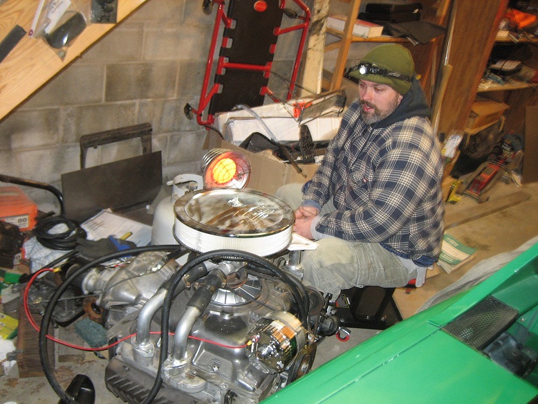

Link 2-3 full open.
An enthusiastic and frozen Zach looks at the newly installed air cleaner (IMG:style_emoticons/default/smile.gif)

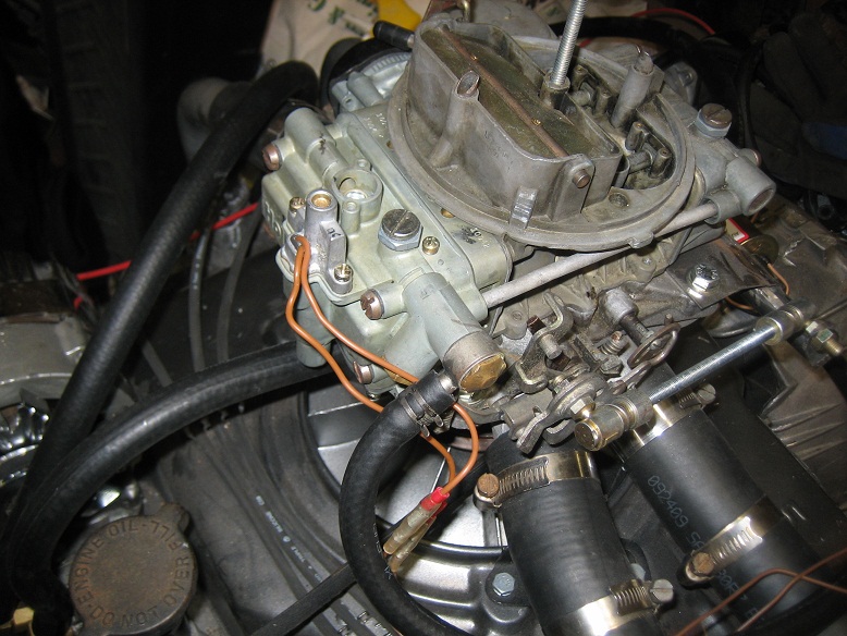

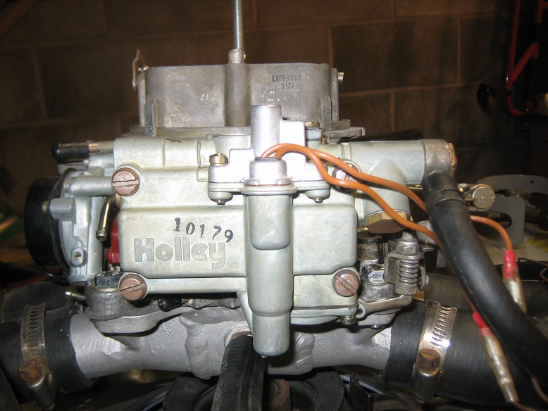

Some close ups of the electrically controlled fuel jet system, Dial a Mile from Holley.

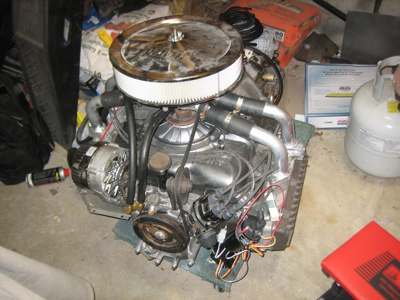

And finally, the engine almost ready to run on the dolly (IMG:style_emoticons/default/smile.gif)
